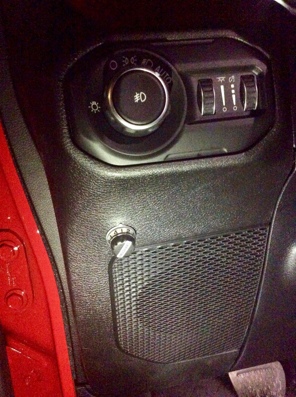

Using the information provided I was able to install a brake controller - took about 40 minutes or so. As I was using a Redarc controller and was not able to find a cable to bridge between the Jeep’s connector - so with the recommendation in JLURmojito’s write up for a substitute cable and then splicing to RedArc’s cable I came up with a workable solution in short order. I am tall and did not want the controls to be in the way of my knees. Wanted to use the cubby under the 12v socket but once the dash was apart it was not deep enough unless I wanted to to more modification... So there was a little space next to the 12v socket - Works well for me. Problem solved.

For reference, I have a JLR with the factory tow package. I went with the Redarc Tow Pro Elite. I ordered from etrailer.com and they had a new pigtail adaptor that allowed a complete plug-n-play application...no swapping wires required. Plugged right into the factory tow harness found under the dash and worked perfectly with no dash lights or other unexpected issues. The adaptor from etrailer added about $20 to the already pricy Redarc unit but it installed relatively easily and I love the diminutive control knob. Also much easier to adjust than the Tekonsha I had in my previous tow vehicle.

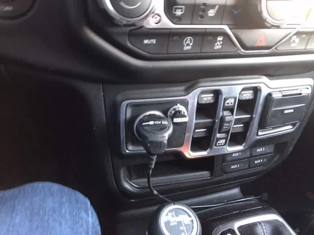

I really like the Curt Echo Mobile. I have had it for several months, used it on several trips and it has performed flawlessly. It connects every time, it has never lost connection (even though it is supposed to continue to function even if it looses connection with smartphone). It also allows me to use it on multiple vehicles. I couldn't be happier with it. (I own no stock in Curt) ;-)
Did you have the factory 7 pin? Did you have to do anything to add 12 volts?

I have the factory tow pkg. it’s plug and play/Bluetooth to tour to your phone and that’s it. No wires yo connect and no control box to mount.
I've been using this for a little bit now. I really like it. Its worked perfect with no issues.
