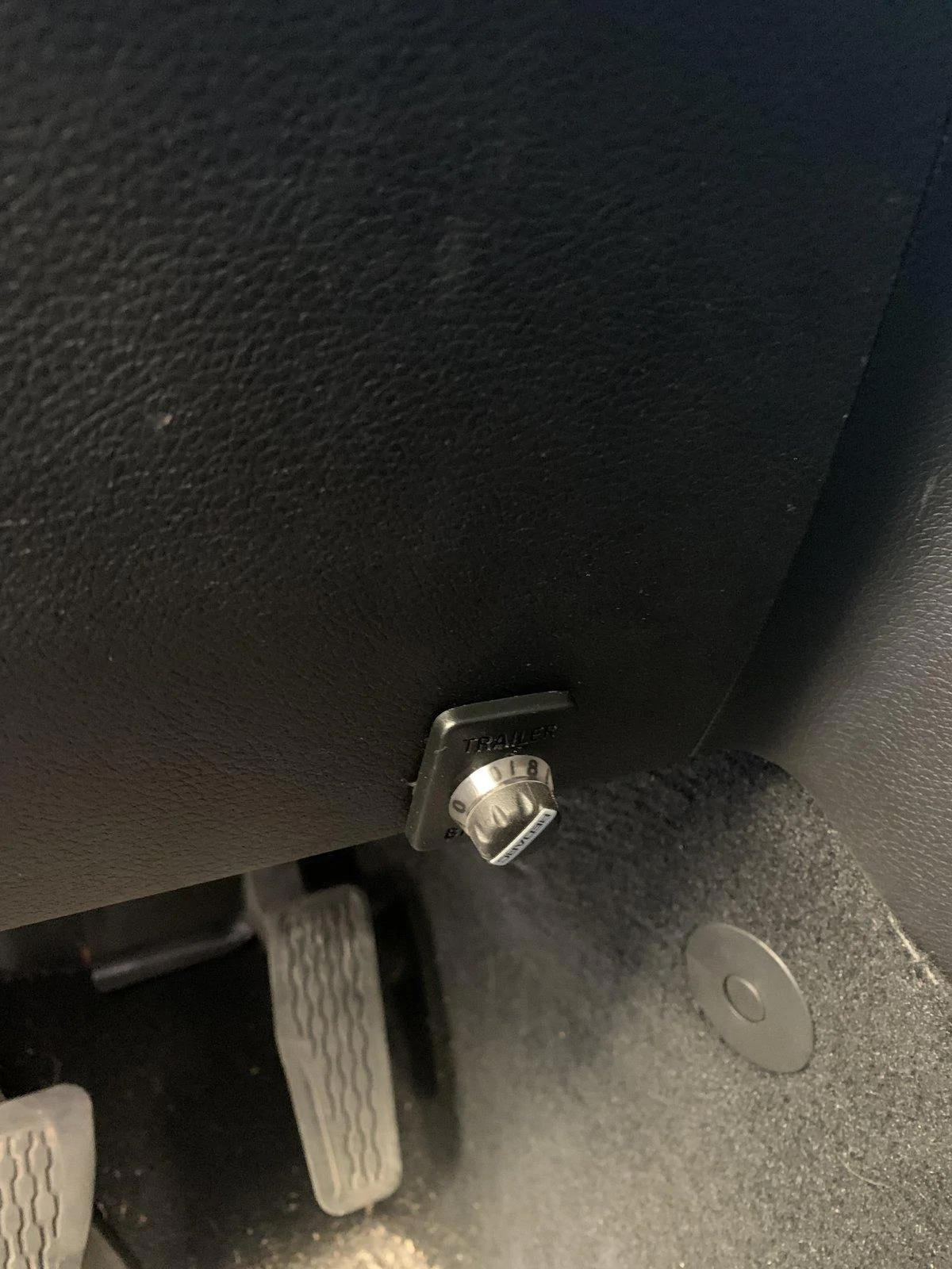

I got the redarc elite and 3024 harness, swapping the black and blue wires so you can do manual trailer braking without messing up anything or getting Xmas lights on the dash.
Seems to work well. The switch is on the panel below the steering, bottom right, and I am using the redarc switch insert for a clean install look. I tried installing without the insert and it didn’t look great.
Easy install as I just pulled the whole panel off, drilled, replaced. Plenty of room on the backside in that corner next to the clip.
