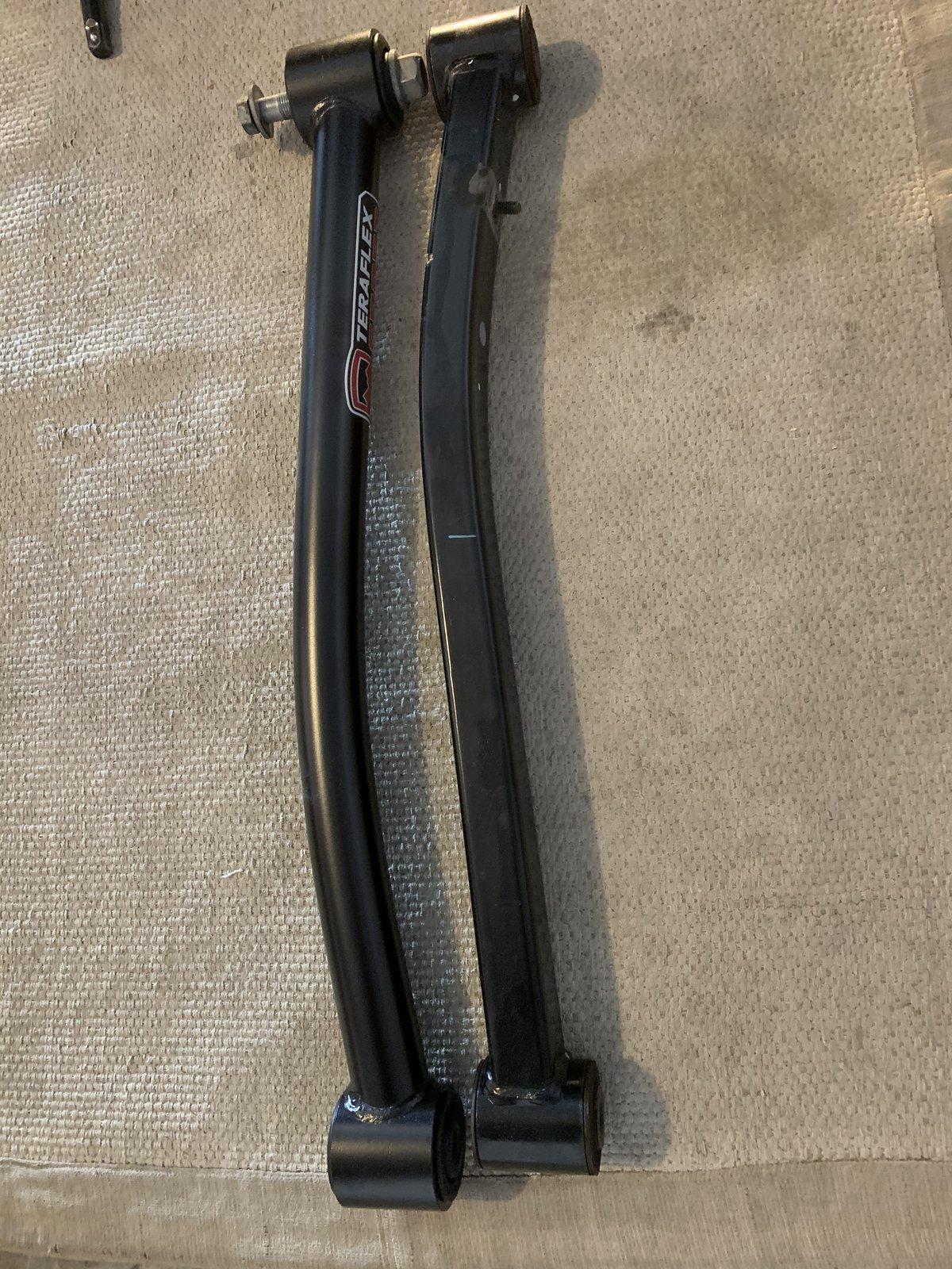

I have JLUR with AEV 2” spacer lift and Teraflex Sport LCA’s. 35X12.50X17 KO2’s at 29 PSI. Using the $5 angle I’m getting what looks like 2.5 at the pumpkin & 9.5 on the knuckle. Is my caster 7 (still can’t figure out this simple equation)!? It drives better now than it ever has. Specifically the steering “tracks” firmer especially noticeable during higher speeds. Here is a pic of stock LCA’s & Teraflex Sport.

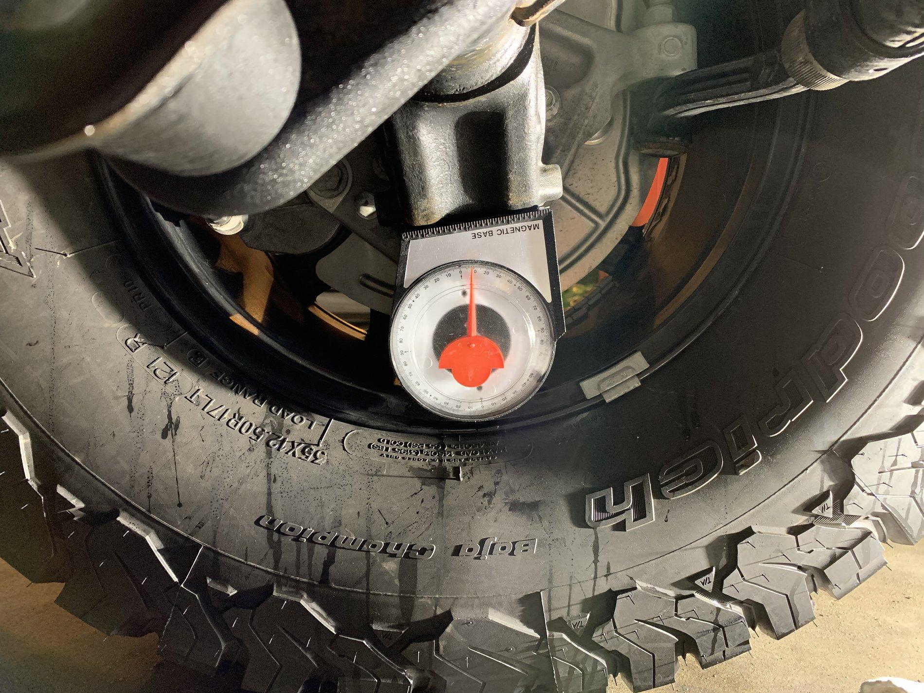

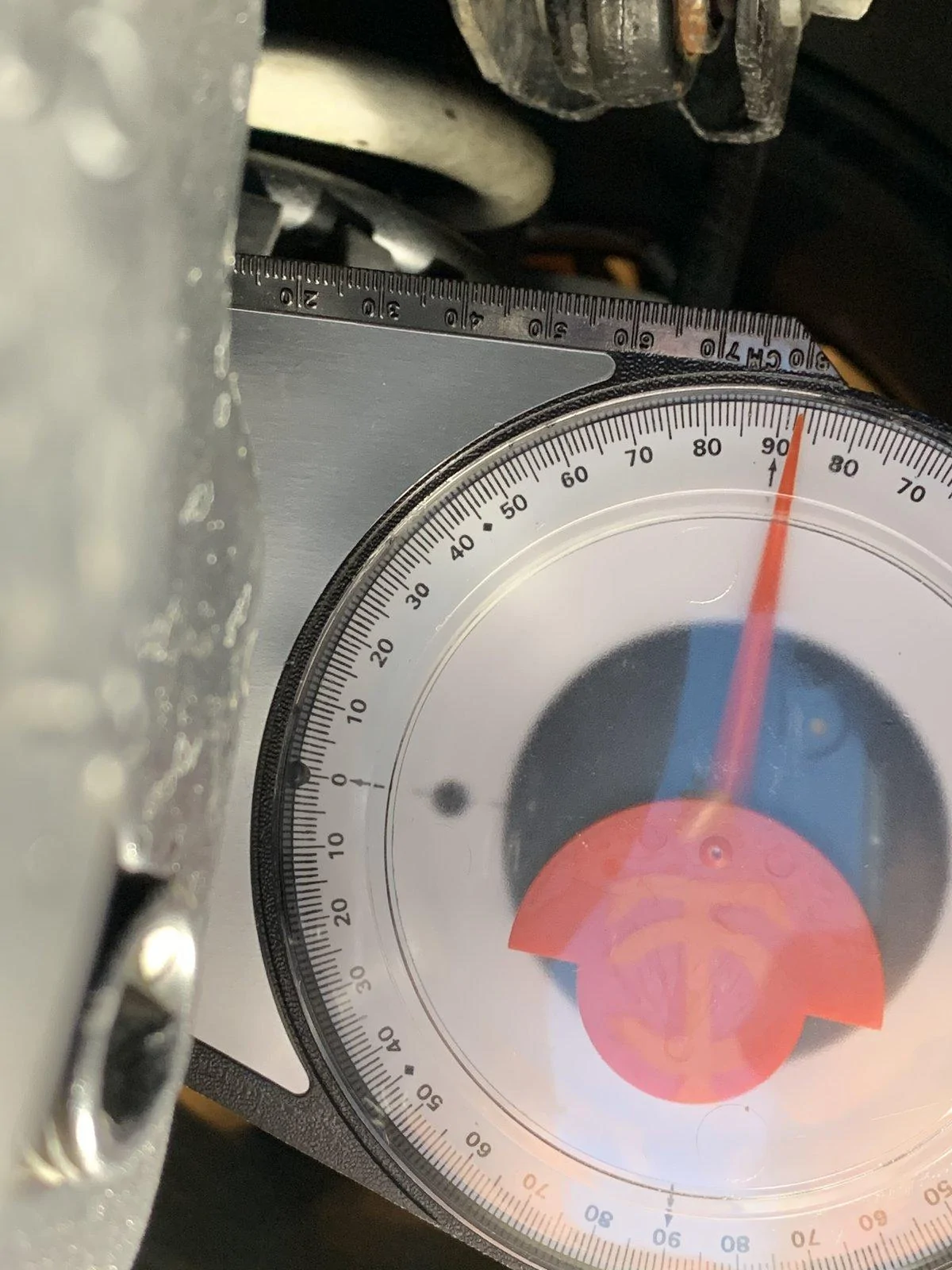

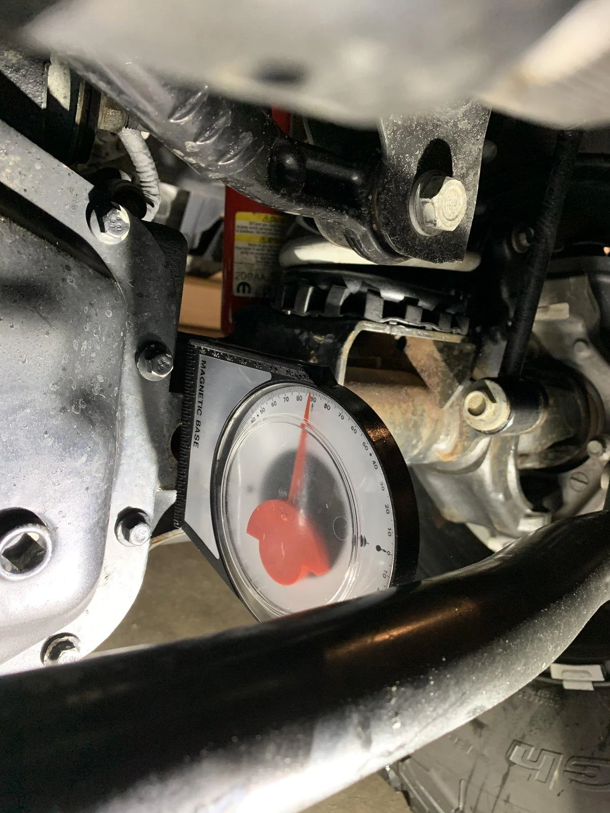

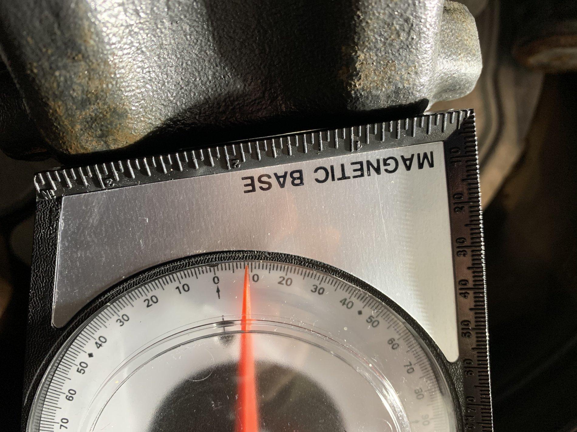

Jeep Wrangler JL JL Rubicon caster measure 7DF6717F-6CB9-4D09-9758-E643738E8AB9
Jeep Wrangler JL JL Rubicon caster measure FEA84848-2848-45B5-92BA-5B8F17BB2024
Jeep Wrangler JL JL Rubicon caster measure BC5C9172-7796-485D-ABB0-DFE2A83AC5E2
Jeep Wrangler JL JL Rubicon caster measure DFFEB695-A922-49FB-A4CB-03DAD898FB0C

Garage floor is measuring flat. Based on my measurements can someone provide my caster? Set the angle finder on the pumpkin flat circles and bottom flat side of knuckle as the pics show.

It looks like it's reading 8.5 at the knuckle and about 2.5 at the pumpkin (which is angled at 6). So it's consistent between the knuckle and pumpkin. If the floor is flat, you're about 8.5 degrees caster.
Those lower arms may be meant for higher front lifts.
