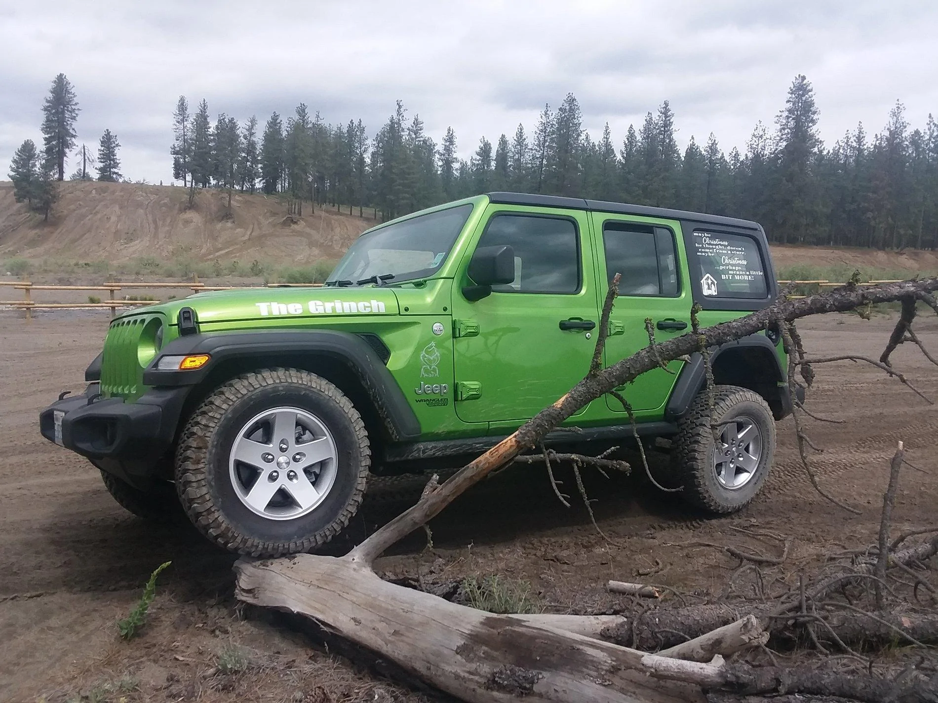

I wanted to order Mopar Part# 82219010AB JK Wheels and put them on my JL. Dealership that I inquired through states that JK Wheels will absolutely NOT fit on a JL - something about JL's no longer being 5x5. Is this true?
If so, what bolt pattern or specs do I need to look out for when ordering aftermarket wheels? Fuel is telling me wheels should fit on my JL no problem. I just want to make sure I order the right thing.
JK wheels do fit on the JL. They required an 1/8 inch spacer in the front. I have not tried to put one on as a spare but it seems like the hub hole is too small for the backup camera.

The wheels should fit just fine. I hate it when dealership don;t know their butt from a hole in the ground!

The different diameter of the hub hole, the different taper of the lug nut cone, and the slightly different back space dimension might work ok, but a Dealer has to think "liability " should a problem occur. Sad, but True...

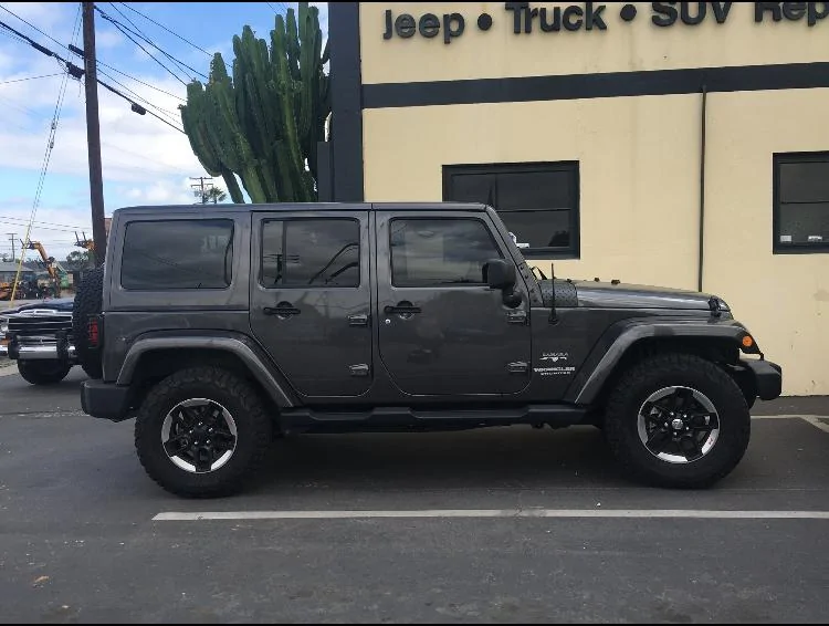

Im wanting to get the 75th edition bronze wheels for my JL. Quadratec has their own version of it for the JL but I've found a few guys on FB market selling wheels for $500-$600 for the set of 5. This would save me a few hundred $$. My big question is if the JL lug nuts will fit in the Jk holes on the wheels? I know every wheel is made different but is there someone out there who has either has done it or seen the 75th anniversary wheels on a JL? I dont want to risk getting some of these wheels and then have to sit on them until I re-sell them.

So is there an exact answer? I would like to put the wheels from a 17 jl sport the same one as flyfysh1.

It's no problem as long as you use your own lug nuts.

Thankyou. Been looking at this thread waiting for a straight answer to pop up. Have a brand new set given to me for free. Been pushing it off cause I wasn’t sure it would fit. Any problems mounting on spare with camera?

The center hub opening should also be the same 71.5 mm size so there shouldn't be any problem. There is a possibility the camera cover may not fit back on. If so, just leave it off. It has no function I could see anyways. Post pics of your Jeep, before and after.
