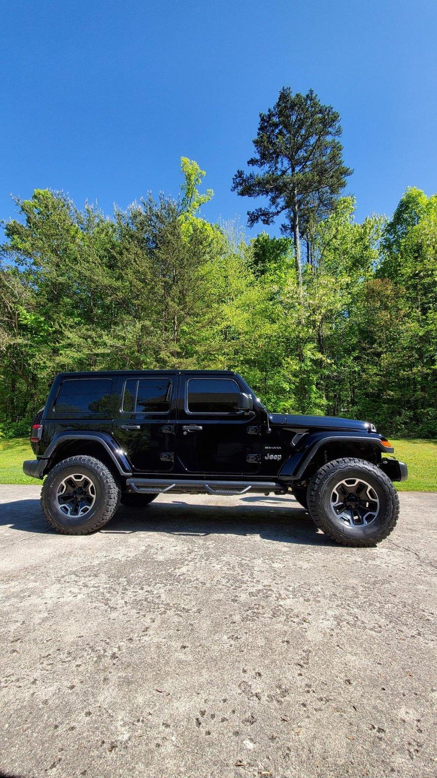

Has anyone put these tires on your JL? I have a 2dr sport jl and am hoping to put these on without issue. They are Rubicon Hard Rock wheels with 305/65/r17 K02s.
I have seen contradictory information on putting jk wheels on a jl and am just wondering what ya'lls thoughts are on it.

The lug pattern is the same, but you must use the JL lugs for the new size studs. Stock Rubi fenders are cut for 35" tires. After that it's aftermarket and customizing

BTW, tire size is a great choice, nice & wide but not too tall, great for a stock JL!
You might have a bit of contact "lock to lock" at the inner suspension area, but should be minimal.

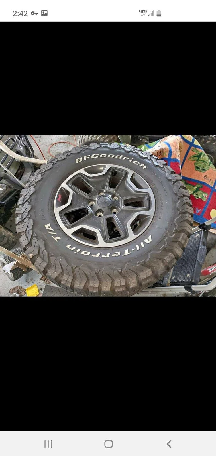

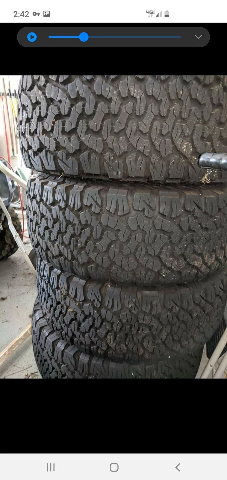

I found them on marketplace. I hadn't seen that size K02 before and thought i had to pick them up. The guy never used them after bringing them home, the nipples were still on the tread. The only adjustments im making are on the spare. I have to trim the rubber bumpers and im going to trim the backup camera cover to fit
