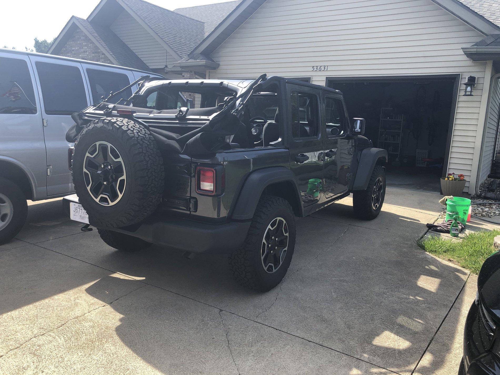

I got a deal I couldn’t pass up on for these wheels and tires.

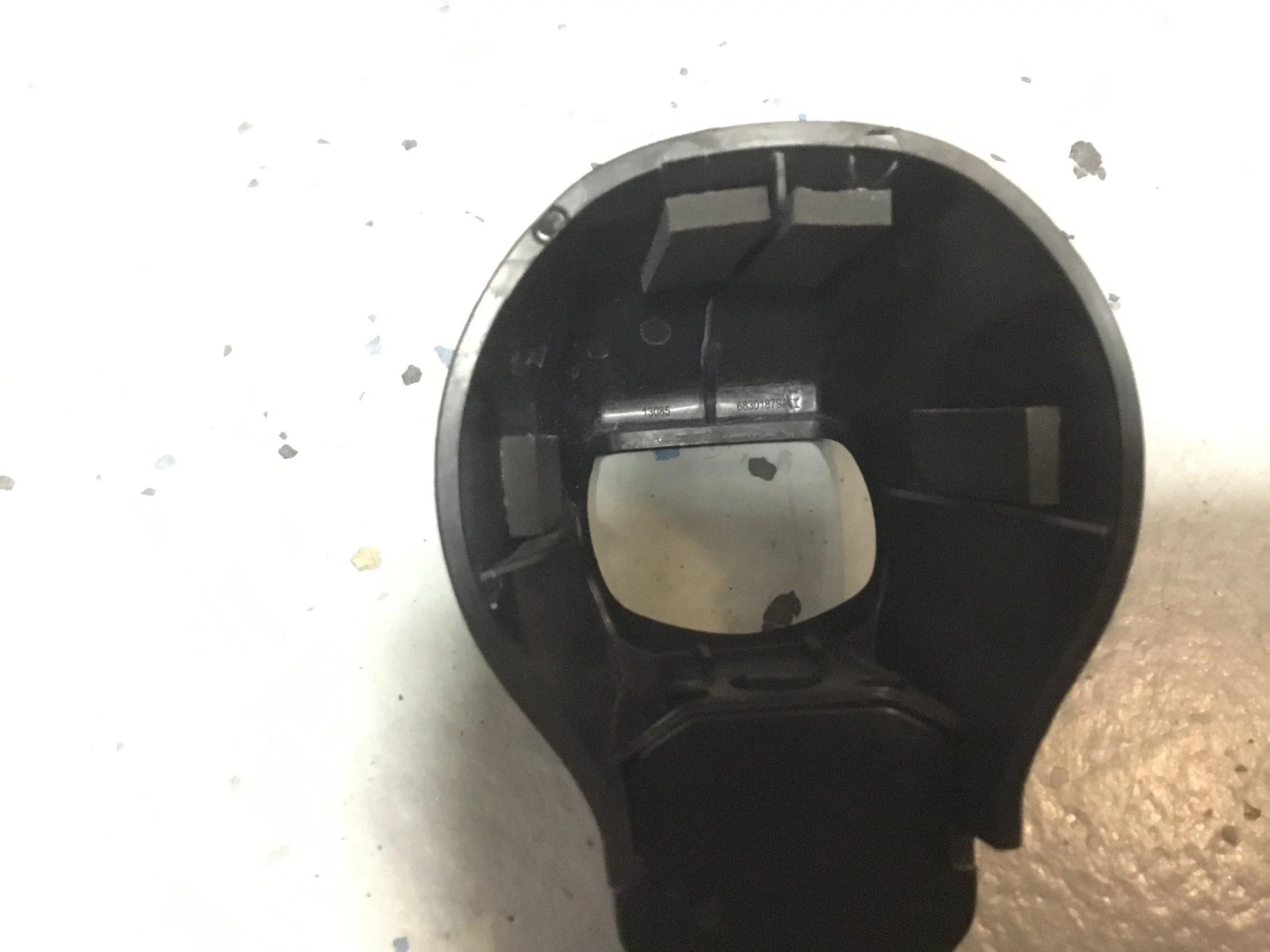

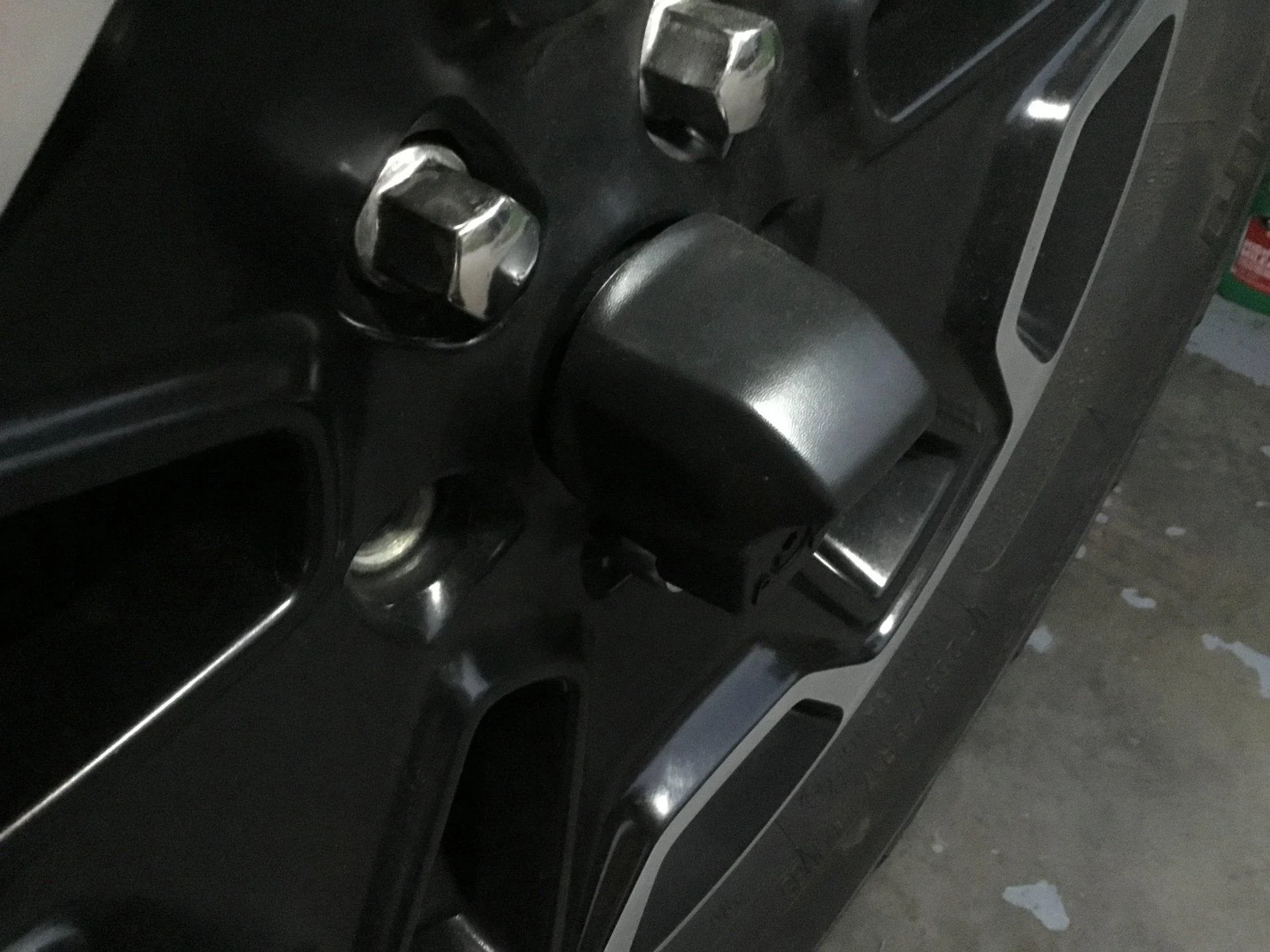

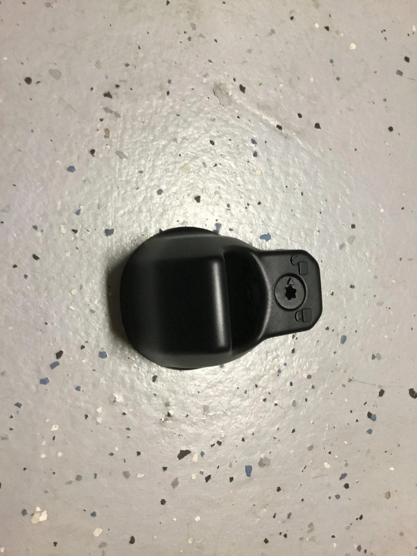

I'm beginning to think there are different covers (part numbers) for different wheels! Is there any way you can post a close up pic of it? With the cover on and off? It's much appreciated.

Best I can do for now....it’s getting dark.

This confirms my suspicion! My cover is about two inches longer to fit the base steel wheels my JL came with. I'll post a picture tomorrow. Now I have to decide to go without the cover or buy this shorter cover you have. Thanks for the pics.

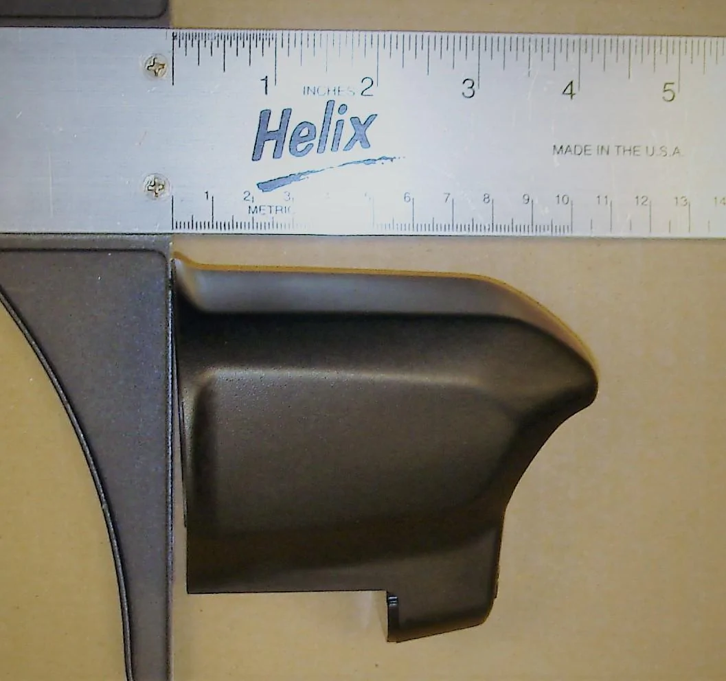

Backup camera cover for the base steel wheels:
