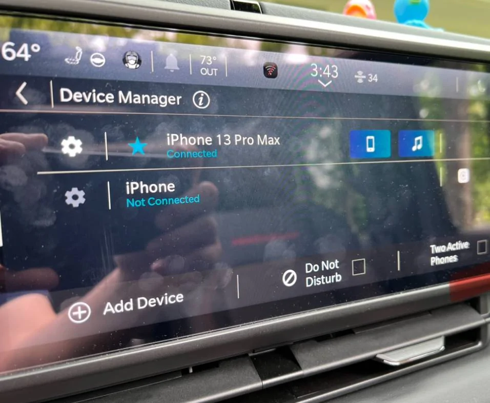

All of a sudden CarPlay is not working. Connected to wireless CarPlay. I left the vehicle to drop off some recycling. Come back and my phone doesn't show up in CarPlay. It's grayed out.
I try to connect/reconnect/hard wire/wireless/reboot/turn off/turn on/forget device/delete device...all the usual bullsh*t. And I'm left with a wirelessly connected phone that doesn't allow CarPlay -- or have a popup on the phone to enable it -- and a wired connection phantom iPhone for CarPlay which does ABSOLUTELY NOTHING. I can't even click it.
So two questions:
1) Has anyone solved this and
2) If not, what truck did you trade your Jeep in for?
Jeep Wrangler JL Jeep CarPlay Frustration IMG_5067

Yeah it won't work with any phone or cable. Unbelievably frustrating. And literally nothing happened to cause this.

HipCheck
HipCheck
Apr 29, 2018
111
182
NJ
2024 JLU Rubicon V6
SOLVED: Apple CarPlay not connecting/displaying/reconnecting.
Tried:
Turning off/on bluetooth
Forgetting Bluetooth device
Rebooting phone
Another phone previously connected
Another phone NOT previously connected
Hard connection
New cables
And everything else
Only thing that finally worked:
Rebooted head unit.
