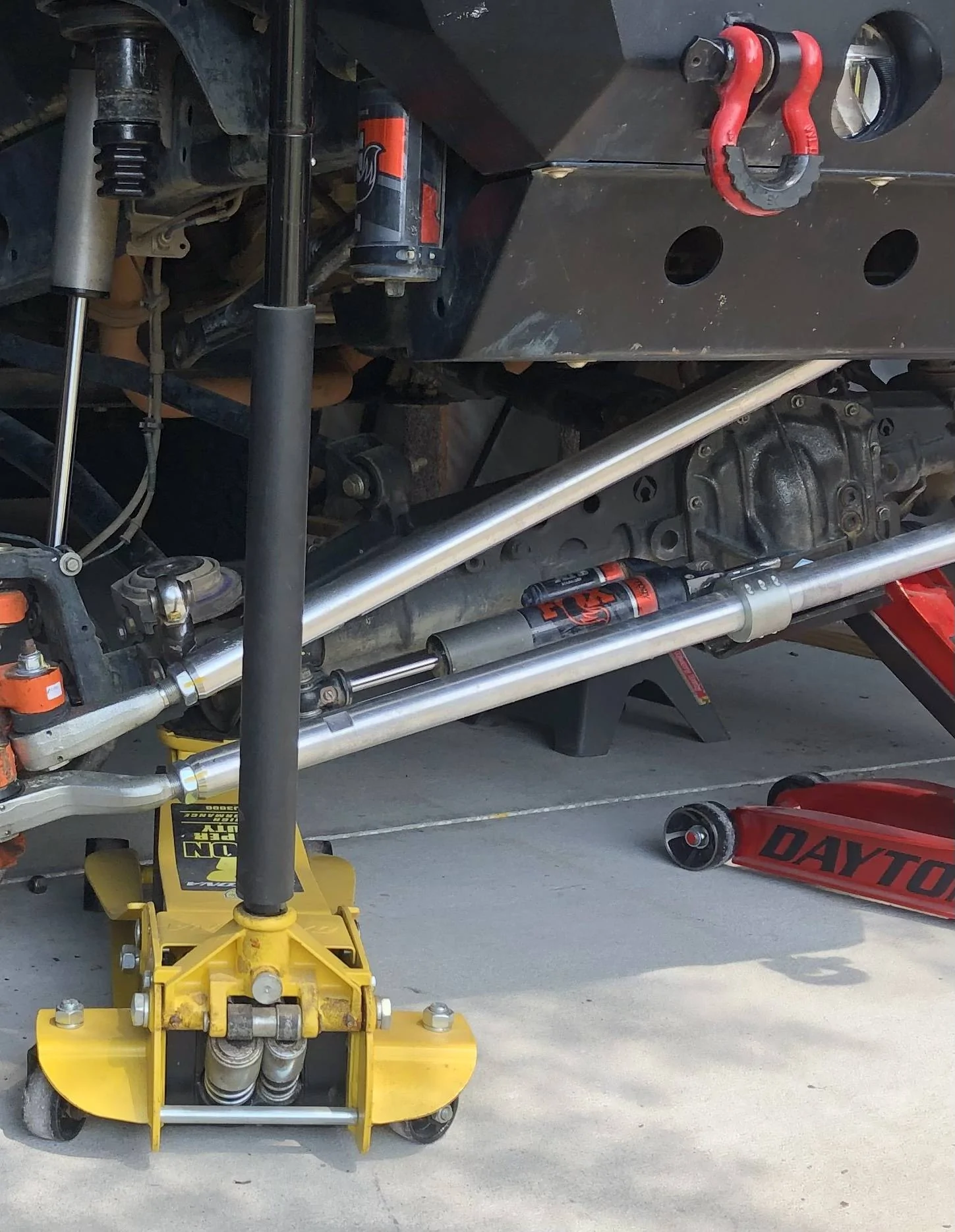

Can any one that has a steer smart draglink please look and see if yours has a bend in it like mine.
While tearing out the front end to fix a shimmy it appears to me that the draglink has a slight bend in it.
If you guys see it also let me know or if you can look at your steer smart steel bottom mount drag link for the rubicon model.
Jeep Wrangler JL Is minimal track bar movement normal? 20231012_103515
Jeep Wrangler JL Is minimal track bar movement normal? 20231012_103533

So right next to the yeti sticker it looks like its bent.
And this is the passenger side attachment
