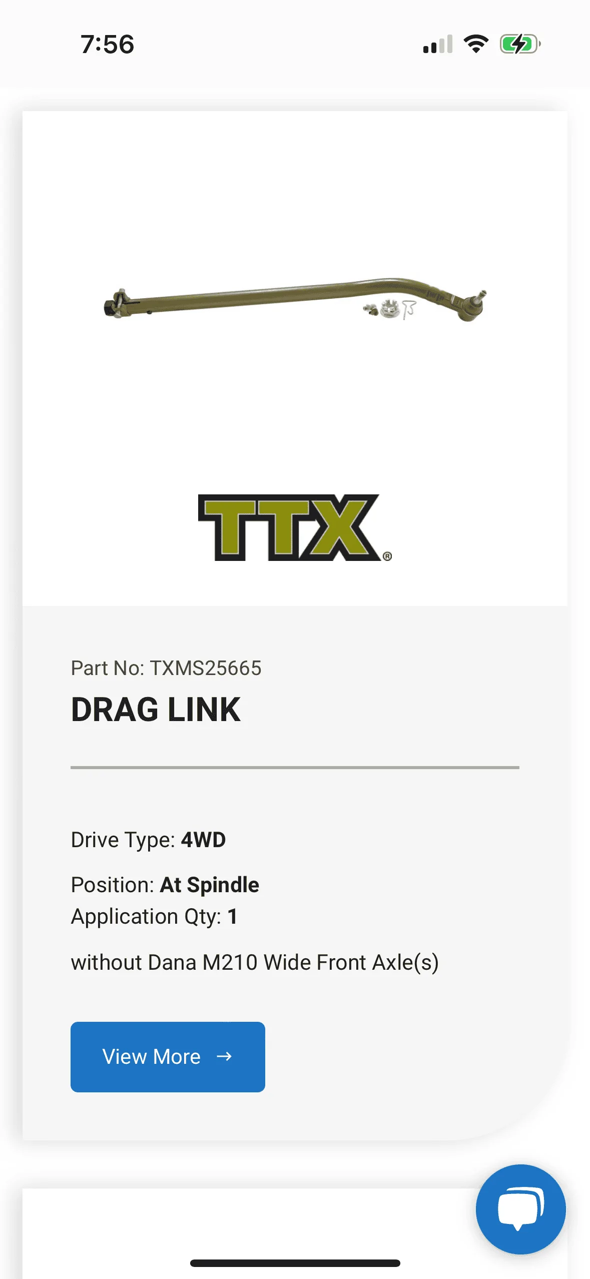

Yes.....Jeep factory part or MEVOTEC TTX.
Which axle do you have narrow or wide?

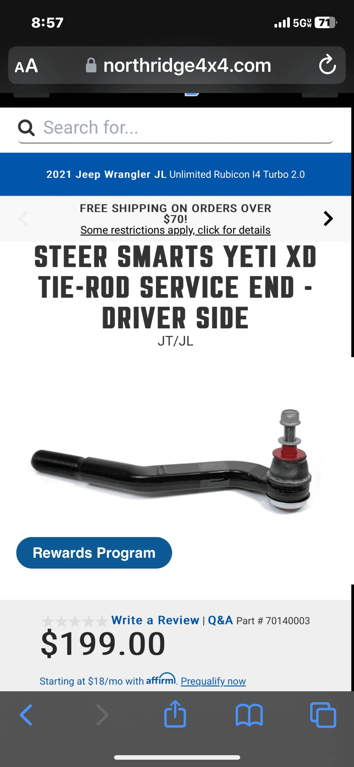

So this one instead?
STEER SMARTS YETI XD TIE-ROD SERVICE END - DRIVER SIDE
JT/JL
Steer Smarts Yeti XD Tie-Rod Service End - Driver Side - JT/JL
You want to get a Mopar draglink end, that end is for steer smart bar…..but if it was me, I’d put a couple hundred bucks with what the end is gonna cost and get an aftermarket drag link….

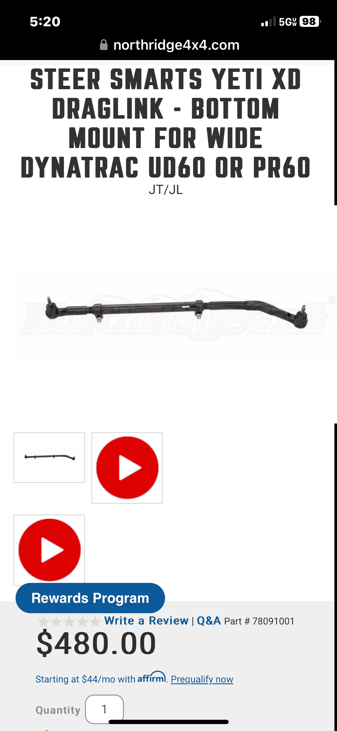

So more like this…. ($130 more than oem end ) is the install pretty straight forward? Something I can do in the garage?
Yep, no problem, lots of vids out there, and if you hit a snag, shoot me a PM…..
