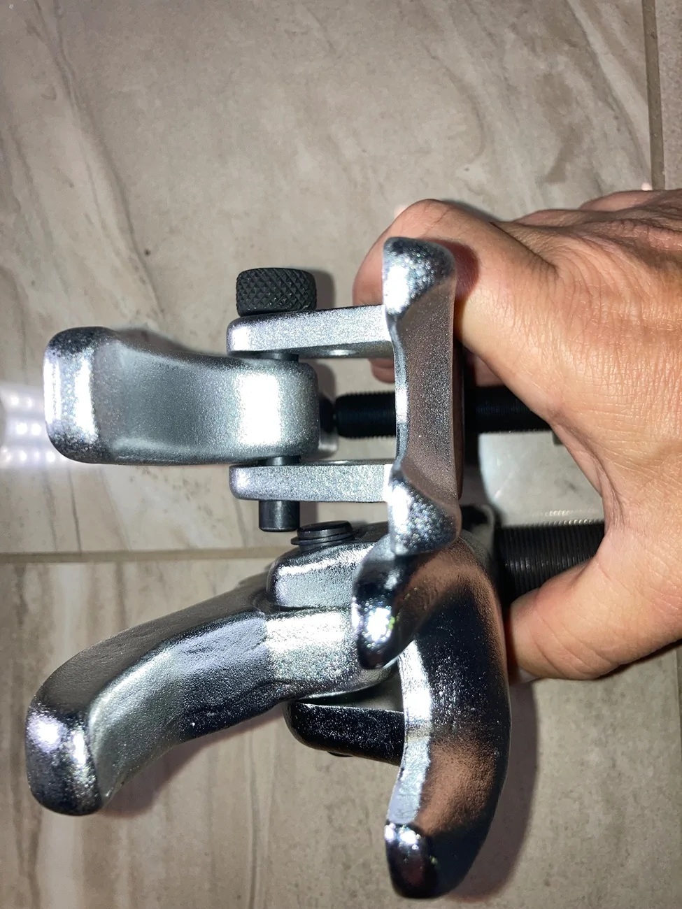

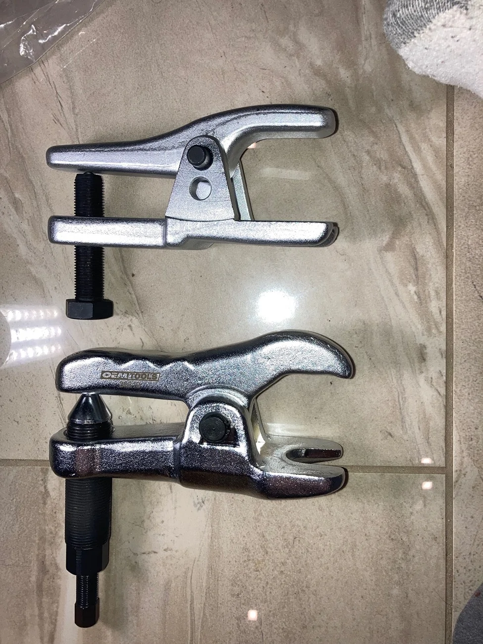

It seems as if the drag link at the pitman arm can be problematic. How hard are they to get off really? Should the $25 tool work or am I better off with the $100 hydraulic tool?

Some times they can be a little tough. I use an air chisel with a pickle fork attachment. Or pickle fork and hammer. You might be able to get it with one of the tools shown.

good luck on getting that on the pitman arm. A pickle fork a big hammer and heat may be necessary.

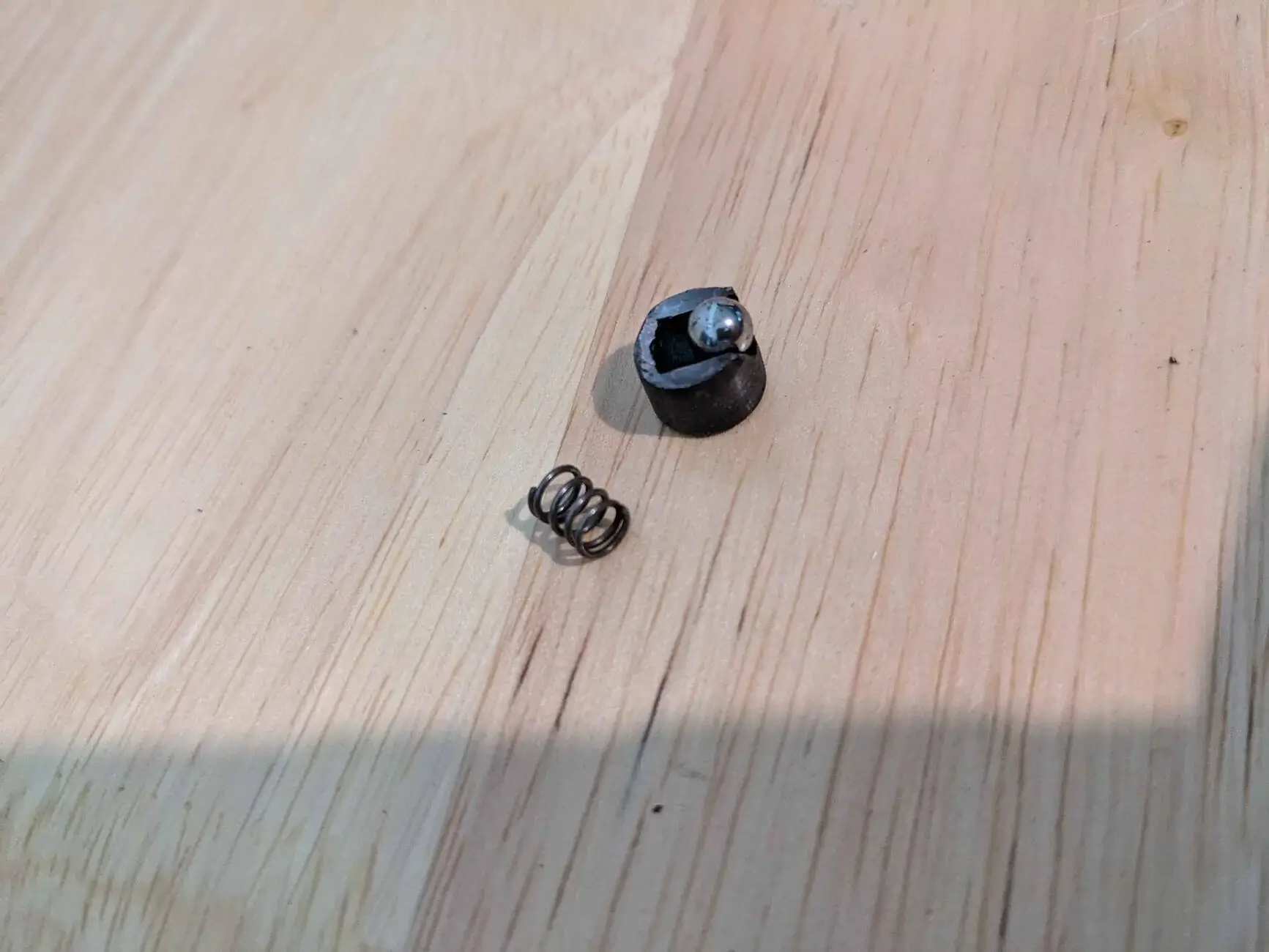

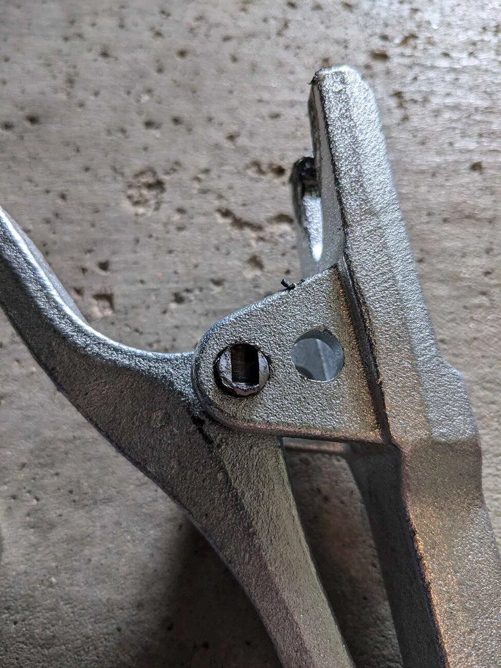

Pickle fork and a few good whacks with a hammer. I sheered the pin off my $20 amazon pos attempting to use it on it.
The little one (Gear Wrench) worked. The big one was too thick to and didn't want to to go on. I put it on and tightened it up quite a few turns. When it started to feel really tight I started turning may 1/4 turn and then tapping with a hammer. That seemed to work well.
