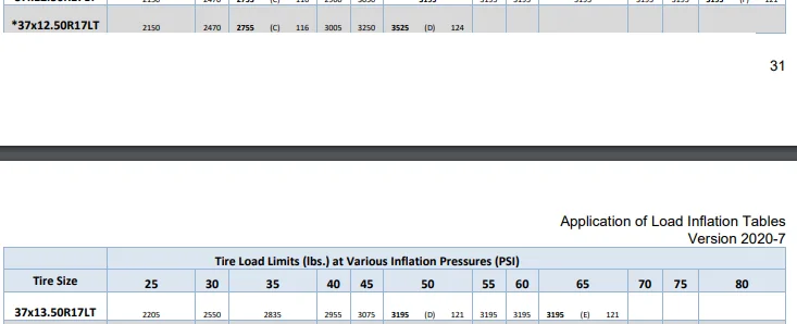

As shown in an above reply, the load inflation chart shows that each tire can support 2,150 lbs. @ 25 psi. Based on that the tires could support just under 2,000 lbs. @ 23 psi. Times 4 tires and that is almost 8,000 lbs. total weight which is well above the weight of the Jeep.
The only sidewall issues because of tire pressure is if you run too low of air pressure for the total weight AND run at higher speeds (i.e. highway) for prolonged periods of time. Too low of pressure allows the tires to flex excessively every revolution and thus causes heat build-up and fatigues them, than the sidewalls will fail. Think of a tire that is partially flat with an obvious large bulge on it. As you drive that bulge is constantly moving which means it is flexing the sidewall. First it will get really hot and decrease the strength of the tire. Now think of a paper clip....if you bend it back and forth several times it doesn't break, but if you keep bending it back and forth it will eventually fail. That is what is going on with a partially flat tire. To be clear, when I say "partially flat" that means the tire does not have enough air pressure to support the weight.
