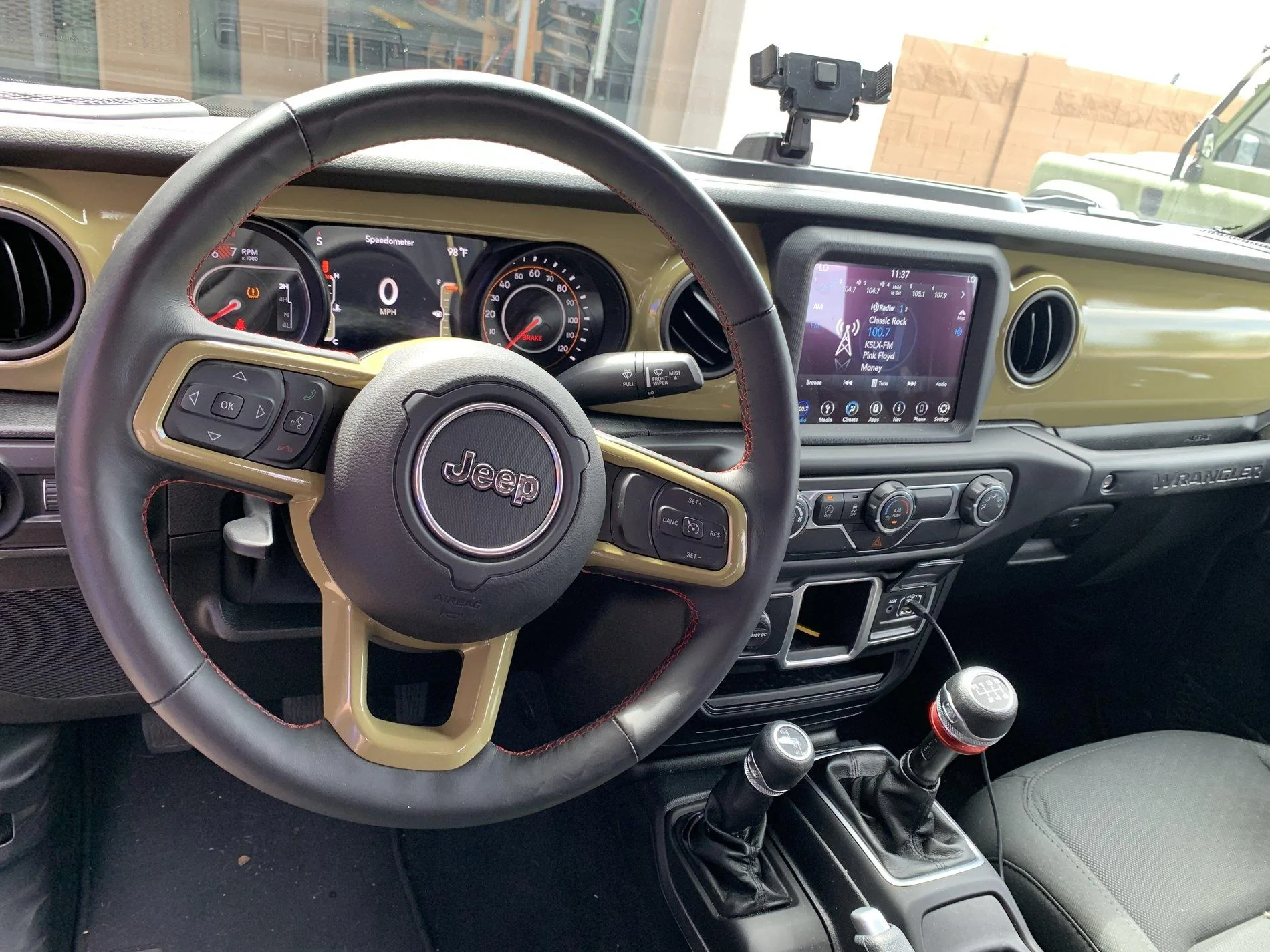

Here’s a final installed pic of mine (painted dash panels & steering wheel bezel). 100% plug and play. Zero issues in the (almost) month since I installed it.

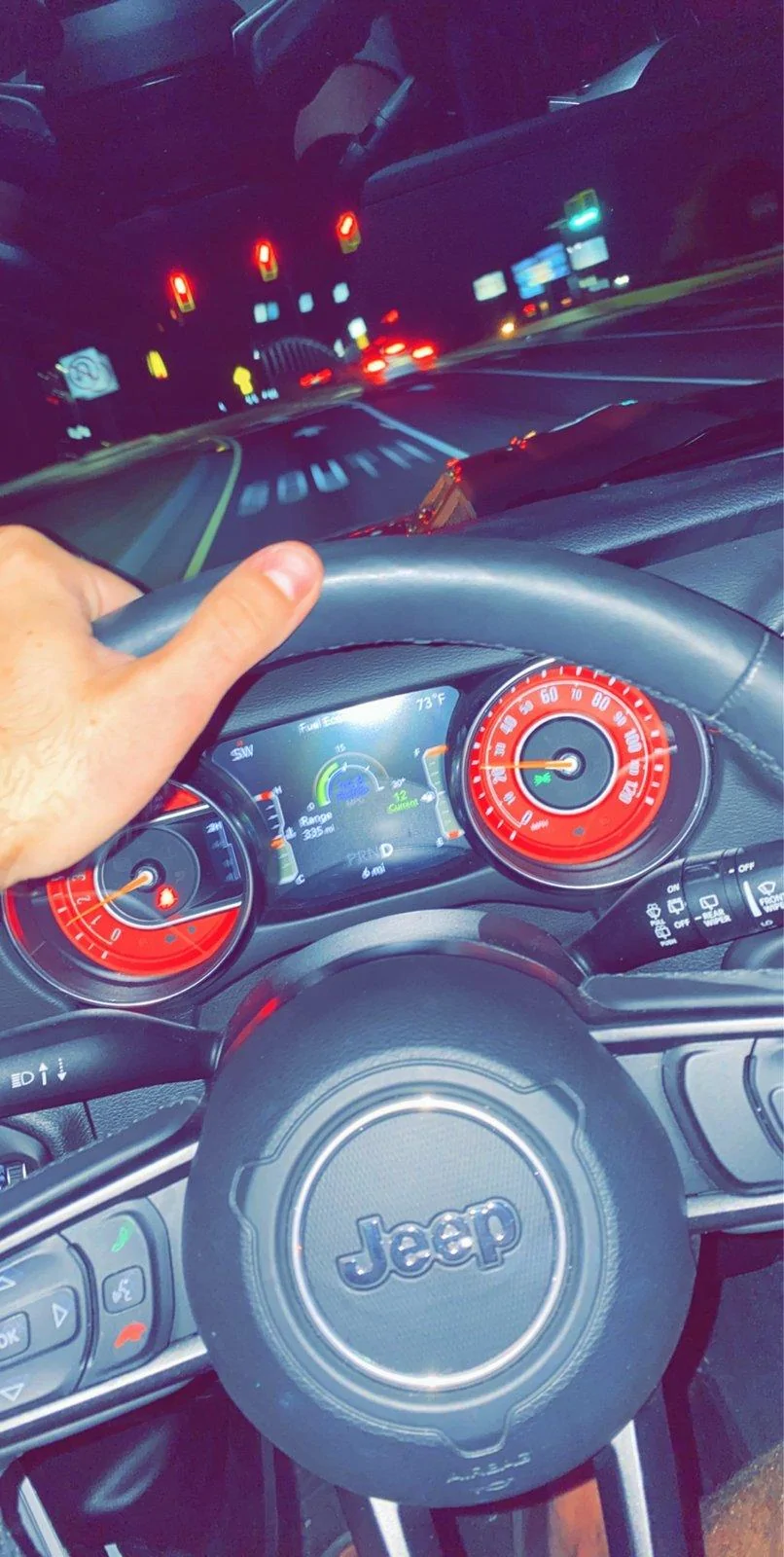

Alrighty ladies and gents. Results are in. I can confirm as well the clusters are 100% plug and play. I went ahead and did the swap myself and it wasn’t as hard as I thought. Took about 45-60 minutes said and done. If you don’t have a good set of panel removal tools get them because it helps a lot. I went ahead and did the red dials from US speedo since I was already in there. Said and done this cost me $480 USD with the red dials. And to answer your questions about mileage no it will not sync up with the CPM. My mileage on the new cluster was 3 miles so I assume this cluster came off a Jeep from the train wrecks or was totaled on transport to the dealership. It’s not that big of a deal to have inaccurate miles on your car, I know my mileage and whoever buys it next will know the accurate number too. That’s all it takes fellas, just some honesty and a document stating it.
