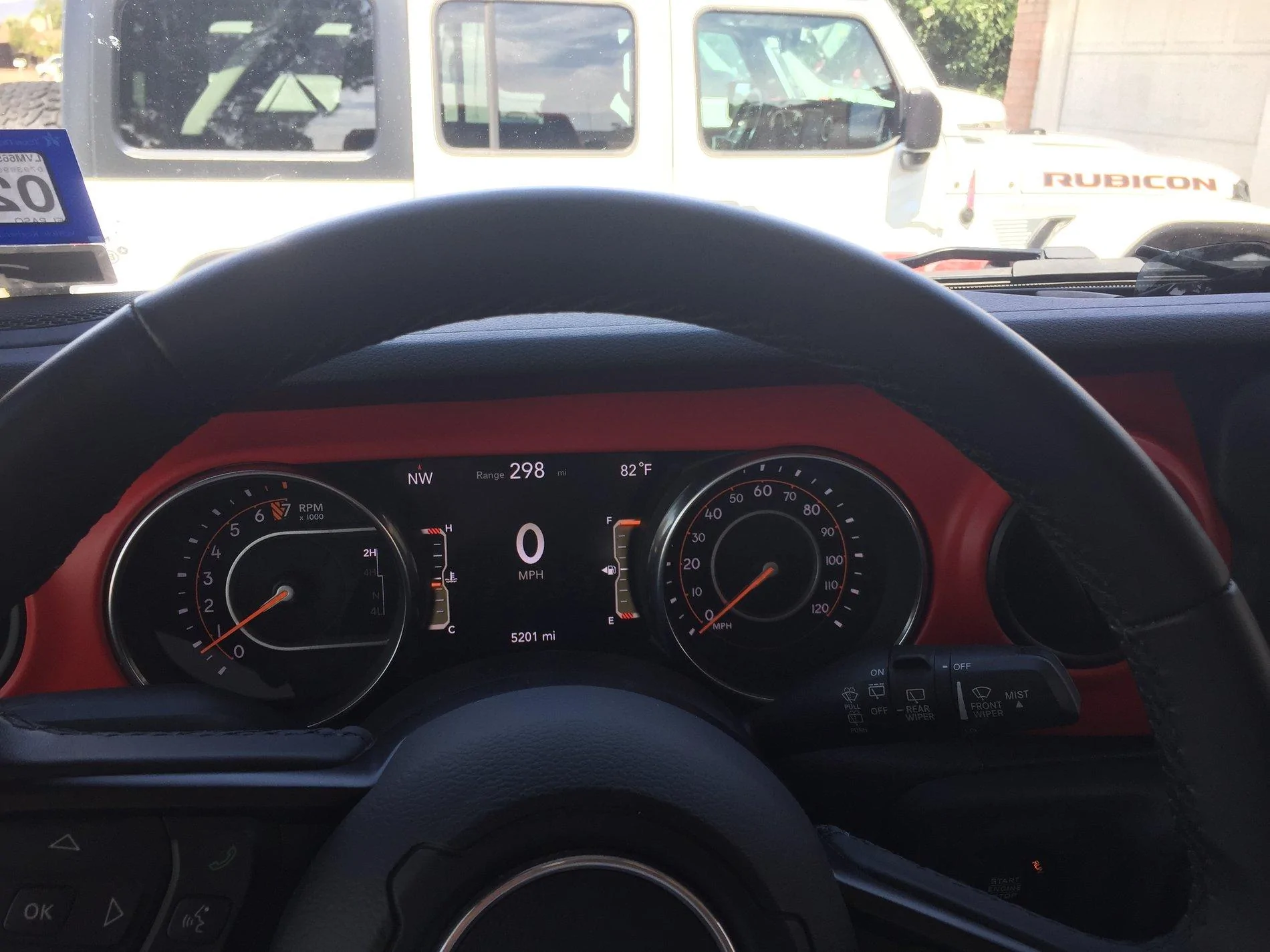

To put this thread back on track, my Sport now has a fully functioning premium dash cluster! I can report it is in fact plug and play!

Did you use your old tachometer overlay? Good job.

@Pic18 the whole cluster is changed out @ChewLola had to use the speedo face because his was a Canadian market cluster.
Thanks! I really like the upgrade!

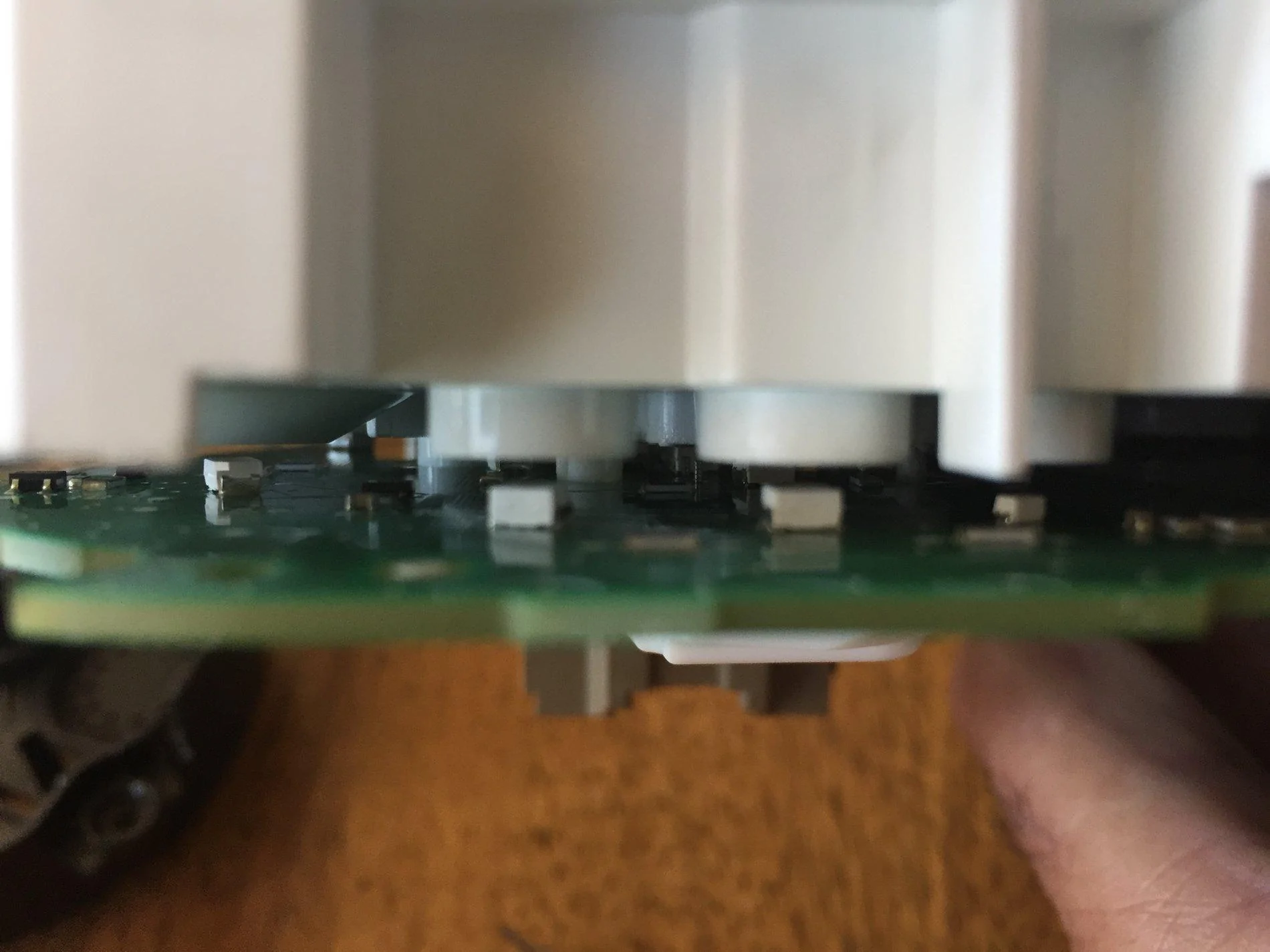

@Rogues Gambit i got so time to open up the old cluster and can confirm the back lighting and the various warnings lights are surface mount leds. [GALLERY=][/GALLERY] Those little squares are the leds, I’m sure you could put film gels on them to change the color but you would have to do a lot more disassembly to figure out which leds are the back lights. I think it can be done, just not something I’m interested in.
HTH
