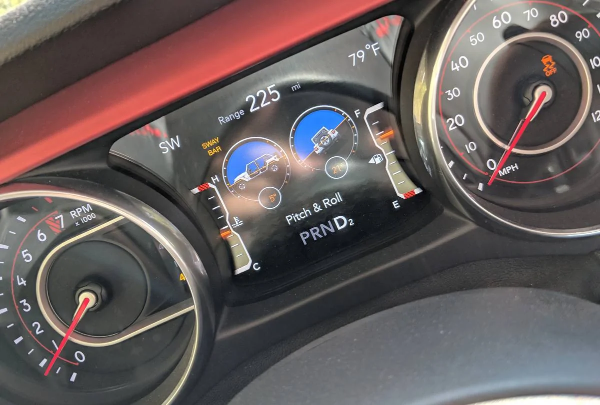

Found a basically new (19 miles) Rubicon instrument cluster on eBay for $100, only issue it was a KPH cluster. I realized that all of the digitals in the cluster (Speed & Odometer) could be swapped US/Metric via Settings in U-Connect menu.
Found the following video, which is for new US Speedo Tach/Speedo dials
After watching it I realized I could either A) Buy new replacement dials, or B) swap my current dials into the KPH speedo cluster.
Long Story short, rolled the dice and so far, a winner.
ISSUES:
*JL Sport 3.5 Cluster Tach dial and Rubicon 7” Tach dial are shaped differently and the JL Sport doesn’t have the Tach bezel. Decided to keep eBay Tach dial and swap the Speedo dial which was an “issue” bc of below.
*The Original Cluster markings were Orange, the eBay cluster markings are Red. Not sure if this is the case in all MPH vs KPH or Sport vs Rubicon clusters but I am OCD and do not find it that noticeable when lit, nor a dealbreaker for me.
*Odometer reading - have already made an appointment with a local shop to reprogram to match actual mileage**
**For any & all trolls whose initial thought is “that’s ILLEGAL”, I’ll mention briefly that a) I practice law & understand the law(s) in Arizona surrounding this mod. B) I am not making this mod, with any intention to lower or ”roll back” the actual miles on my Jeep, and have made arrangements for the odometer mileage to be corrected. The only reason I mention the eBay Cluster as being “basically new” was to reference the condition.

I too want to swap out my base cluster, I’m gonna buy the actual mopar part is this the right part number? Also how do you fix the mileage? 68522502AB

Yes the Off Road screen is still in the cluster and works as expected. The Cluster will sync up with the equipment on your Jeep with the noted exception of the mileage. When I first plugged mine in the splash screen was the Rubicon graphic and I scrolled through the gauges and it had the transmission temp gauge (my Jeep is a six speed). The second time I turned it on it switched to the Sport splash and no longer had the automatic trans displays.
A very nice upgrade that gives the dash a premium look.

I have a 22 Willy’s with the base inst. cluster and I want to purchase the upgraded cluster that comes in the “tech pack” the one you have, I’m going to order a brand new oem one but I would like to know how to fix the mileage as my jeep only has a couple hundred miles on it but I am leasing, but most likely purchasing out after it’s up

I had Instrumentclusterstore.com correct the mileage in mine. When I had them fix mine it was about $100 but that was a few years ago. It took about a week to get it back so I had them set it to the anticipated mileage and then drove the Jeep till the mileage matched and then swapped them out.
I believe any part number will work, they will sort themselves out in a couple start cycles. The one thing that ‘might’ be of concern is if you have a 6 speed, there was a recall/flash that updated the cluster and I don’t know how that will play out. If you have an automatic this won’t matter.
Look here:
https://www.infotainment.com/collec...strument-panel-cluster?variant=40004492820516
Fully plug-and-play and they program the cluster for your specific vehicle and mileage.
