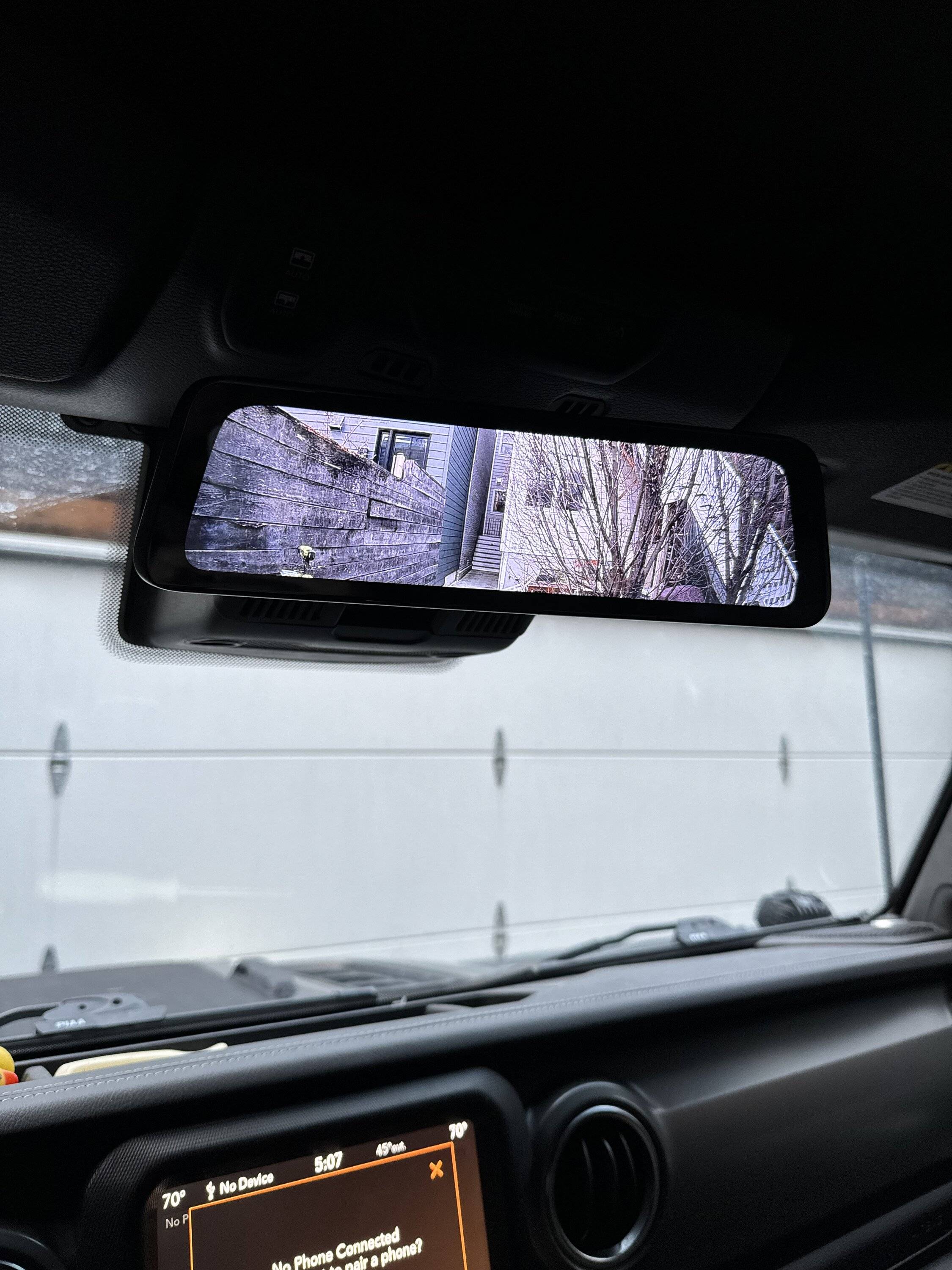

I recently shifted my spare tire to be higher on my tire carrier to accommodate a new rear bumper, and I lost almost all visibility out of my rear view mirror. So to fix that issue I installed a digital rear view mirror that also doubles as a dash camera! This is the mirror I went with. There are some out there that are more expensive and some that are less, but I chose this one because it's almost exactly the same width as the factory one, so you can still open and shut the sun visors normally.

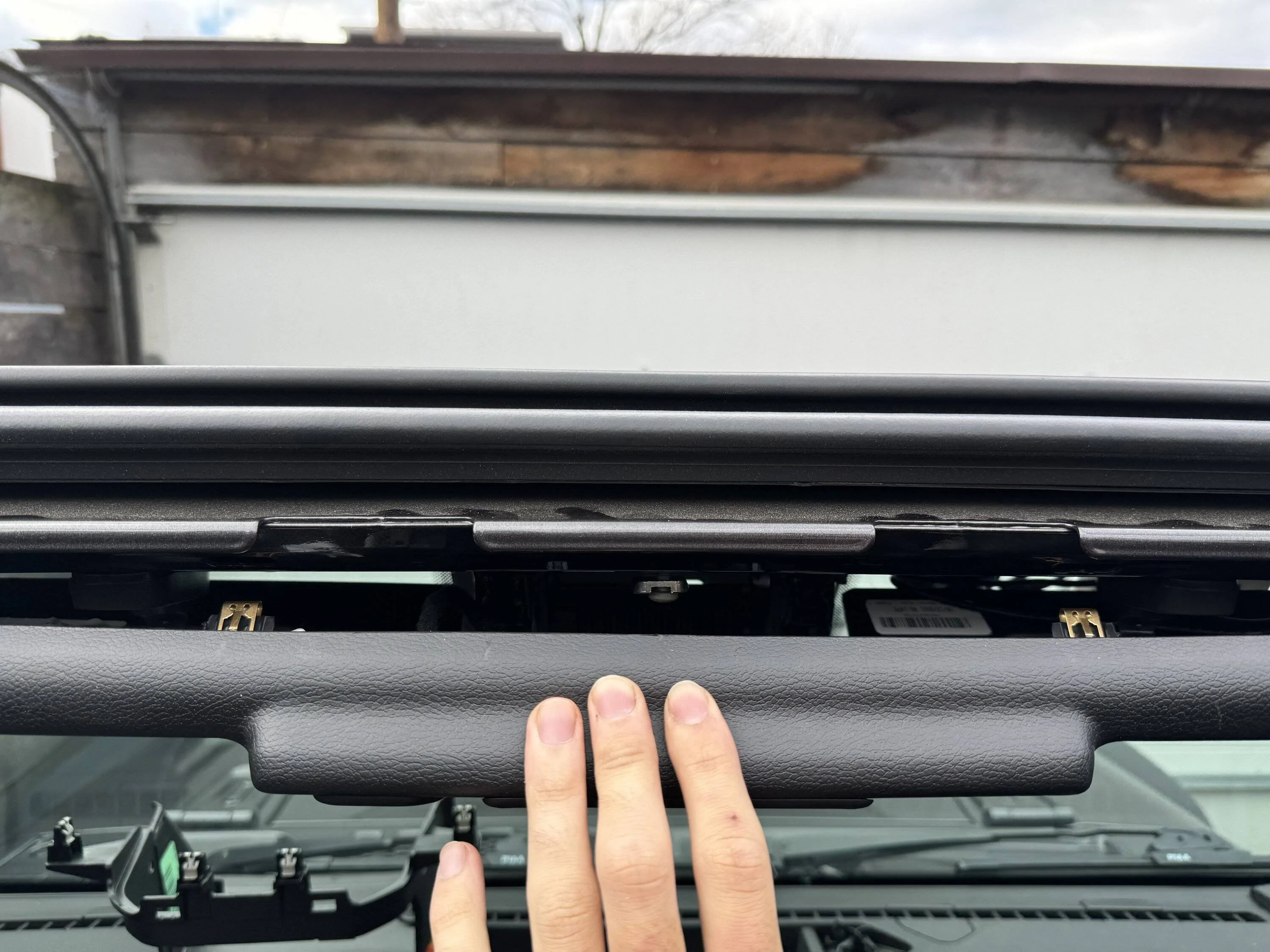

I have a JL with the SOT top and ACC, so your install may be different than mine. Here's a good video on the general removal of a rear view mirror without my setup. The process is basically the same with the SOT / ACC, but the first thing you need to do is remove the 4 plastic screws and plugs from around the ACC cover trim.
Jeep Wrangler JL Installing a Digital Rear View Mirror / Dash Cam Screenshot 2024-01-29 at 5.50.04 PM
Then pop off the little vented cover in front of the panel you just removed the screws from (two clips on the top). After that you can do what the above video mentions and pull down on the top trim.

Again, follow the video instructions and use a screwdriver to twist your rear view mirror to the left to pop it out. Then disconnect the wiring harness if yours is equipped with one.

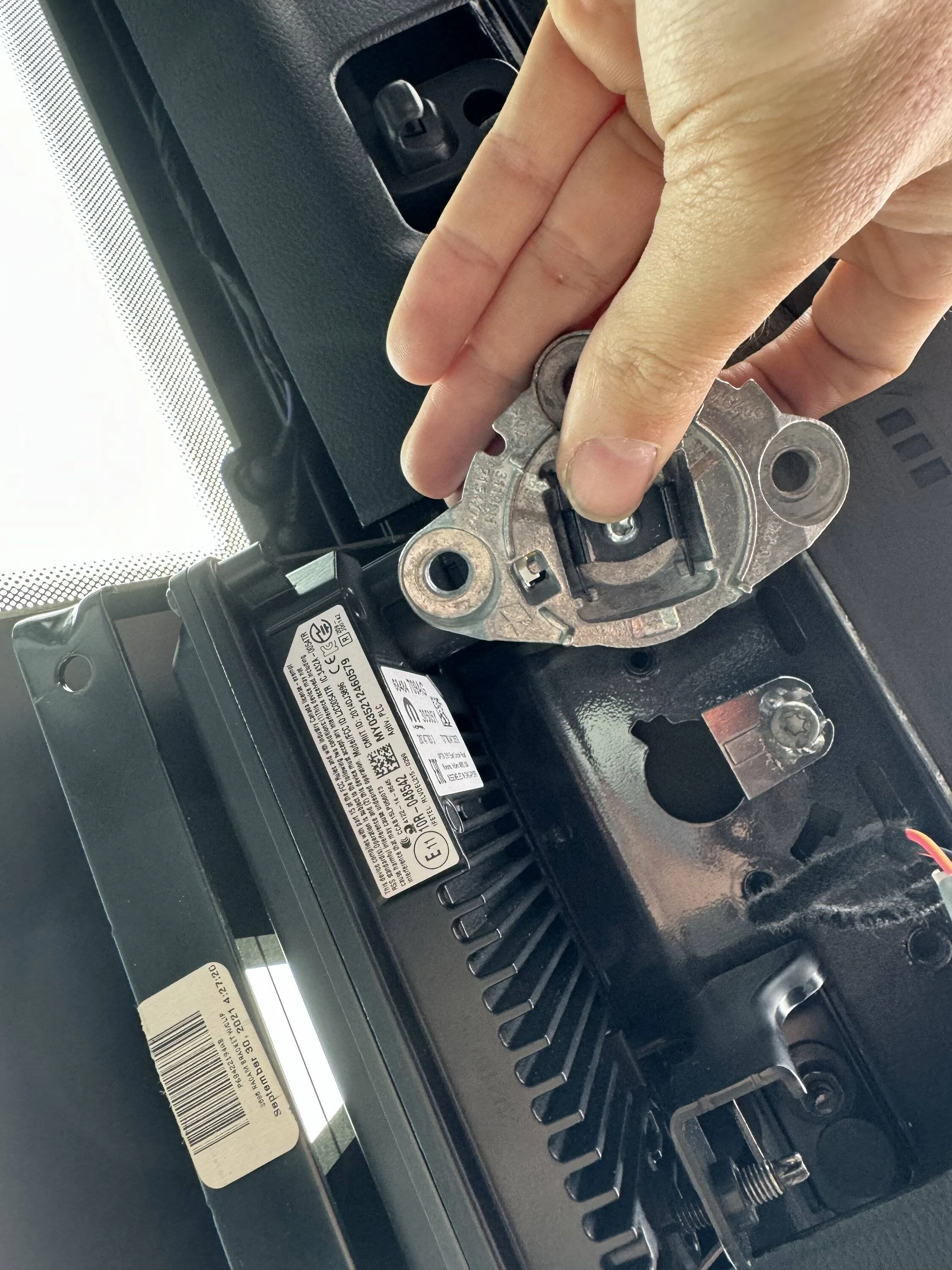

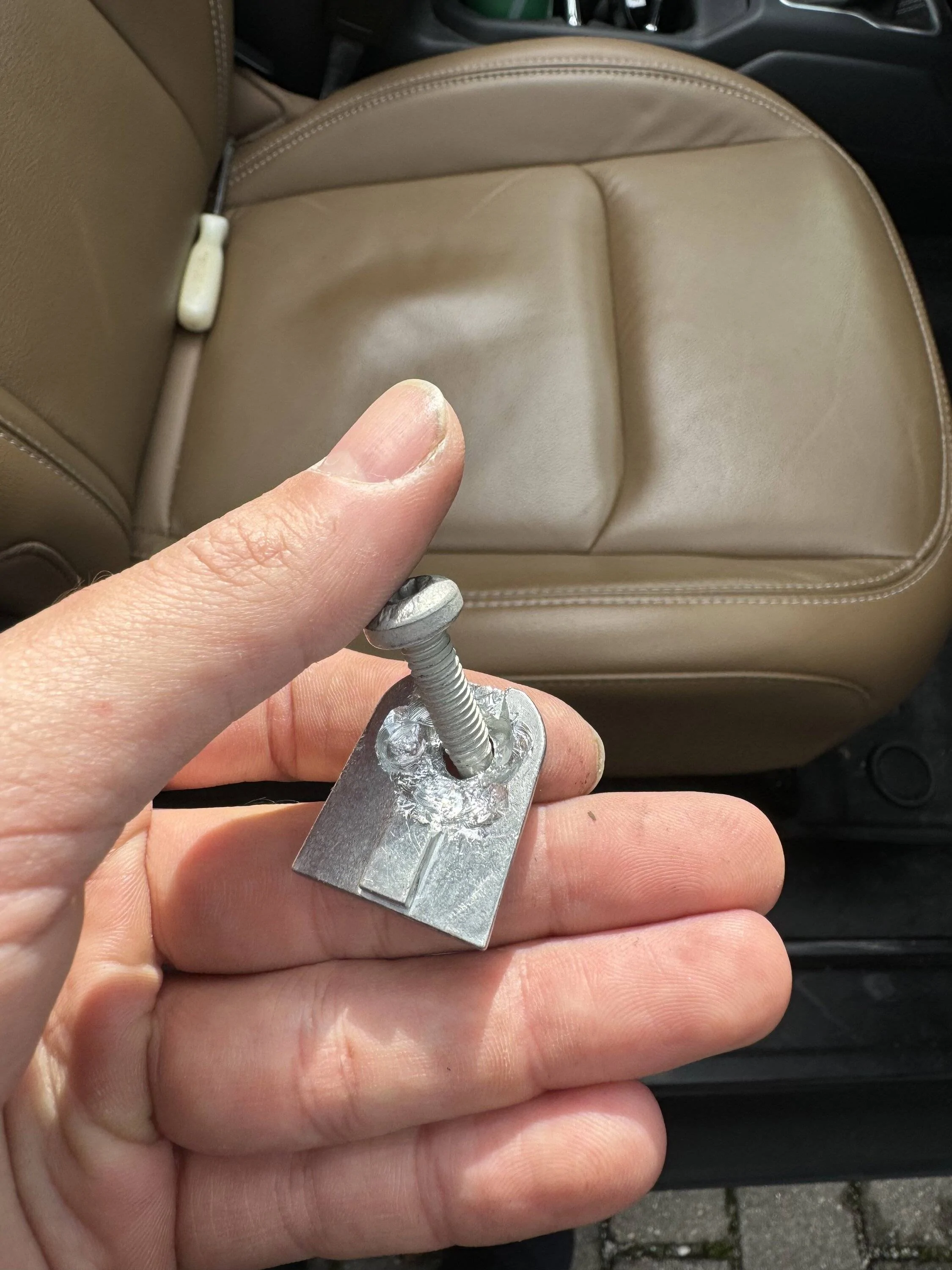

Here's where the process got tricky - the camera I bought did not come with a mount that would fit the JL. Their "Chrysler" mount was not setup to work with a JL at all, so I had to 'aggressively' modify one of the mounts they sent. If you look up from where you just took the rear view mirror out, you'll see 3 torx bolts holding the factory rear view mirror mount. I removed the 3 of those then modified the supplied mount you would normally glue to the windshield to screw into the center hole. I did my best to bore it out enough to fit one of the torx bolts under where the new mirror would slide into it.
Jeep Wrangler JL Installing a Digital Rear View Mirror / Dash Cam IMG_4475
Here's where I mounted it next to the factory mount for reference. I stacked 5 washers on top of this to get it to mount a little further under the trim. If you don't use a bunch of washers you won't have clearance to adjust or move the mirror at all due to it hitting the trim.

After you get the mount tightened down, you will probably have to snip a few pieces of plastic trim around the mirror mount in order for the SOT / ACC trim to clear it. After that it's as simple as running the wiring to ACC / Battery power (this required BOTH to be run for some reason and would not turn on if not done so!!), then running the wiring / mounting the rear camera.
This is a much better alternative to having 0 rearview visibility!

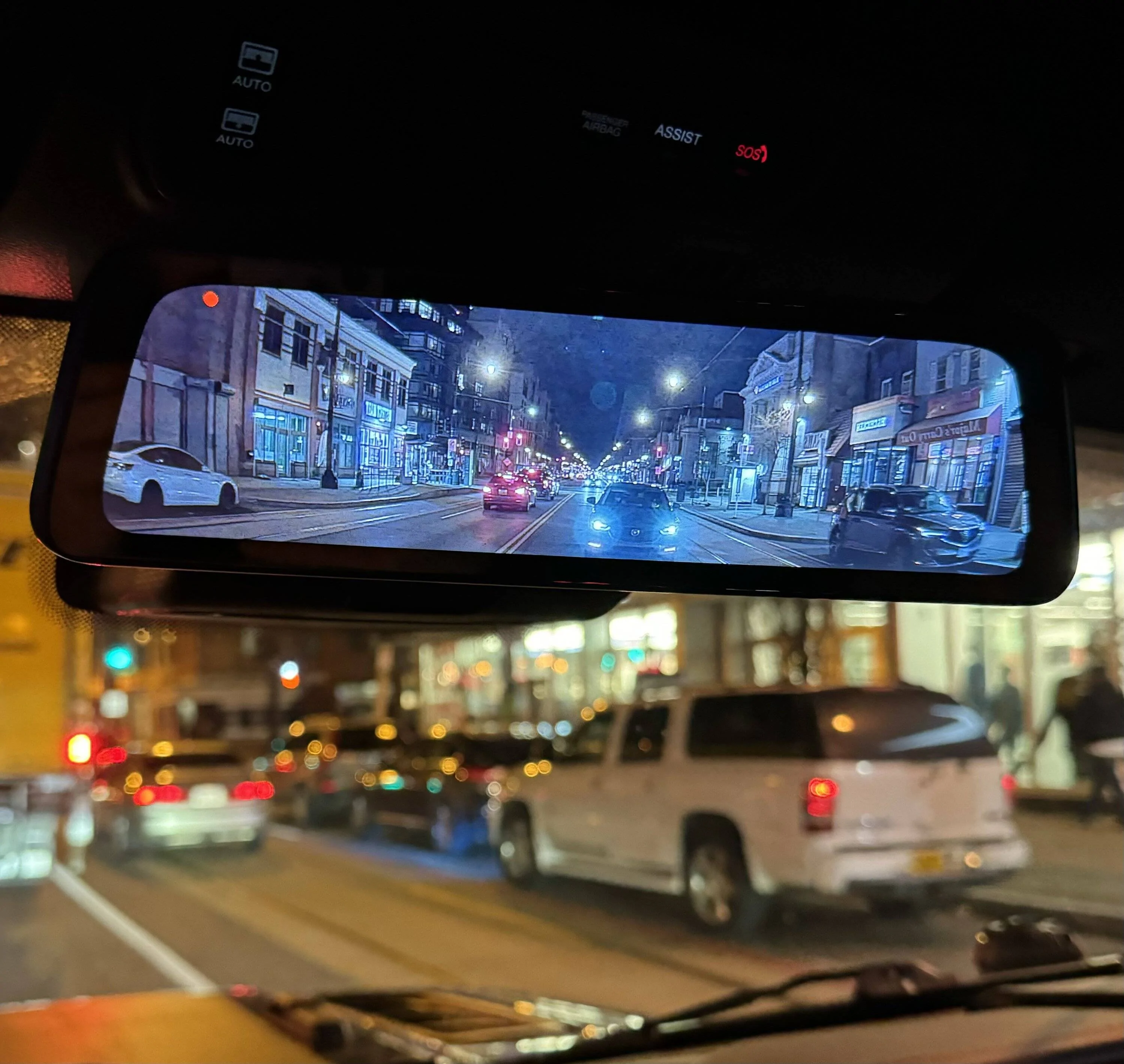

How bright is it at night? does it auto adjust based on the available light

It is auto dimming, but you can also manually adjust it if needed. It's as bright as a dimmed rear view mirror would be with someone's lights on behind you. The night visibility isn't amazing, but again this is still better for me than having 0 visibility.

Here’s the view at night it’s pretty good honestly.

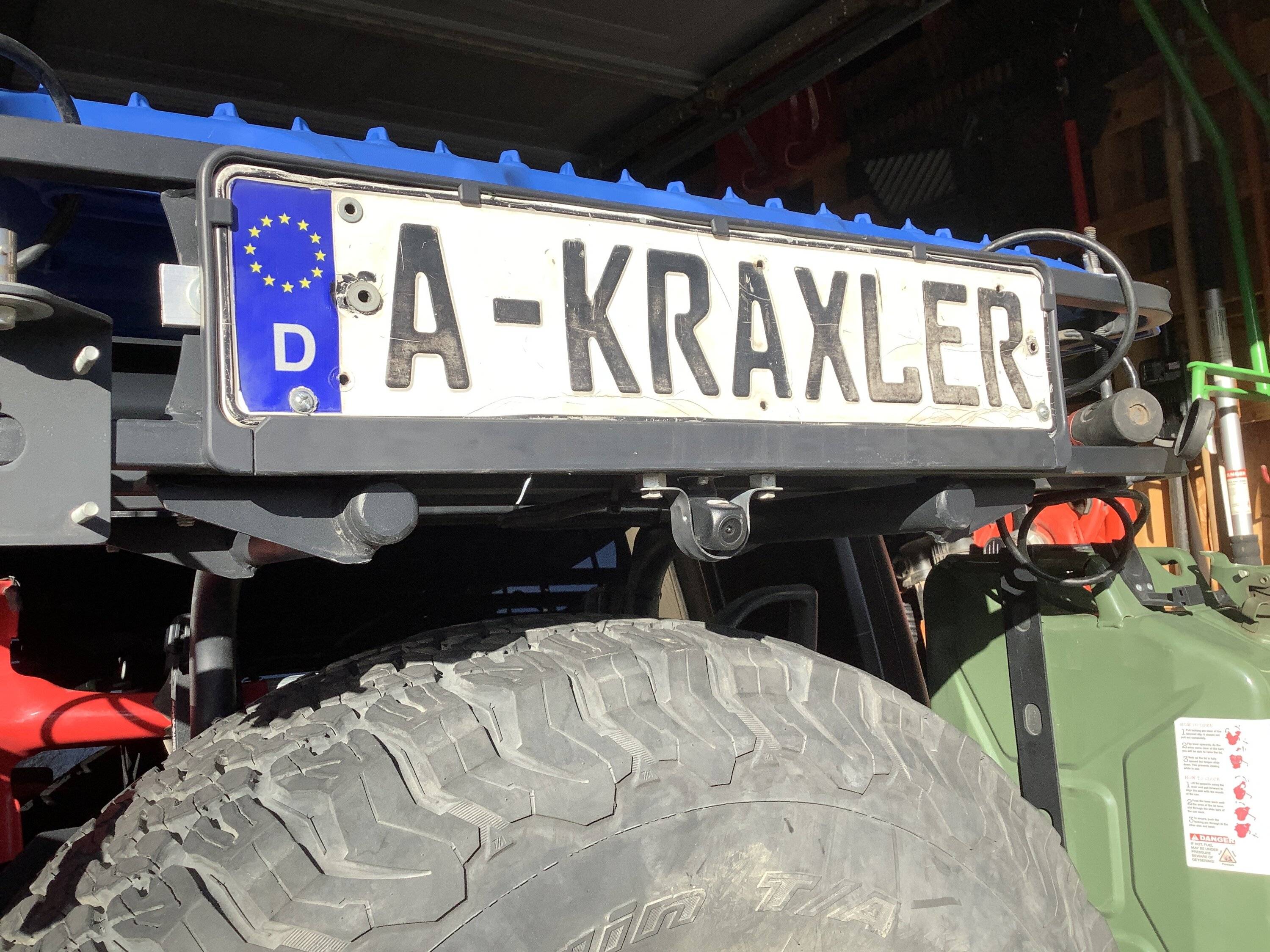

I did a similar thing. I used: Brandmotion FullVUE Rear Camera Mirror for Jeep Wrangler JK/JL - Gladiator JT FVMR-8886 Touch Screen Mirror/Backup View | Always-On Dash and Rear Cam | G-Shock Sensor | Waterproof l HD 32GB Card.
It mounts right up to the factory mounting holes. The mirror clears the visors. I mounted the camera to the rear cargo rack above the spare tire. Works great.

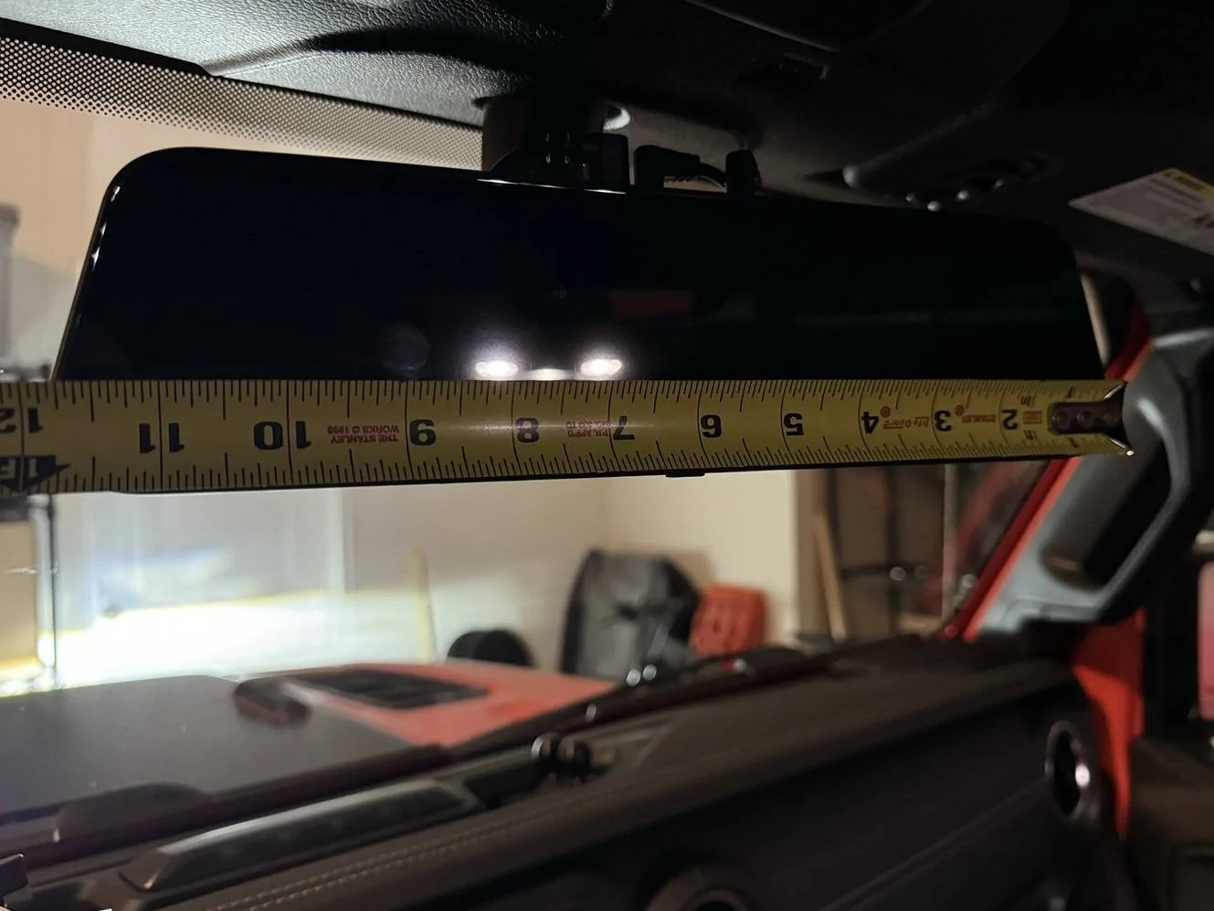

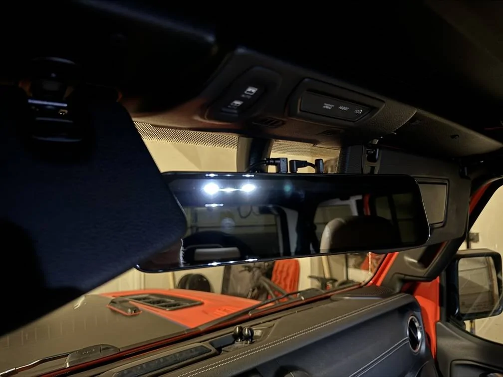

How wide is the wolf box? When I ordered that one it was so wide I couldn't fold the sun visors down.
I just finished my Wolfbox G900 install last night. The angle I have the mirror at lets the passenger visor barely come down, but the driver visor cannot come all the way down.

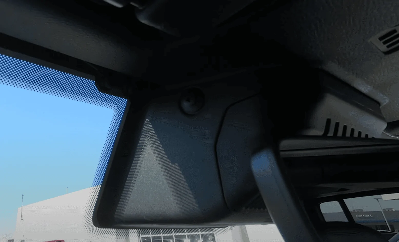

The front camera view is not ideal it captures ~1/3 of the frame under the left side of the ACC box then the right side is completely fine. It's good enough for me, but I wish I had gone with the T9PRO; I was unaware they had that model. I'd do that if I were you.
