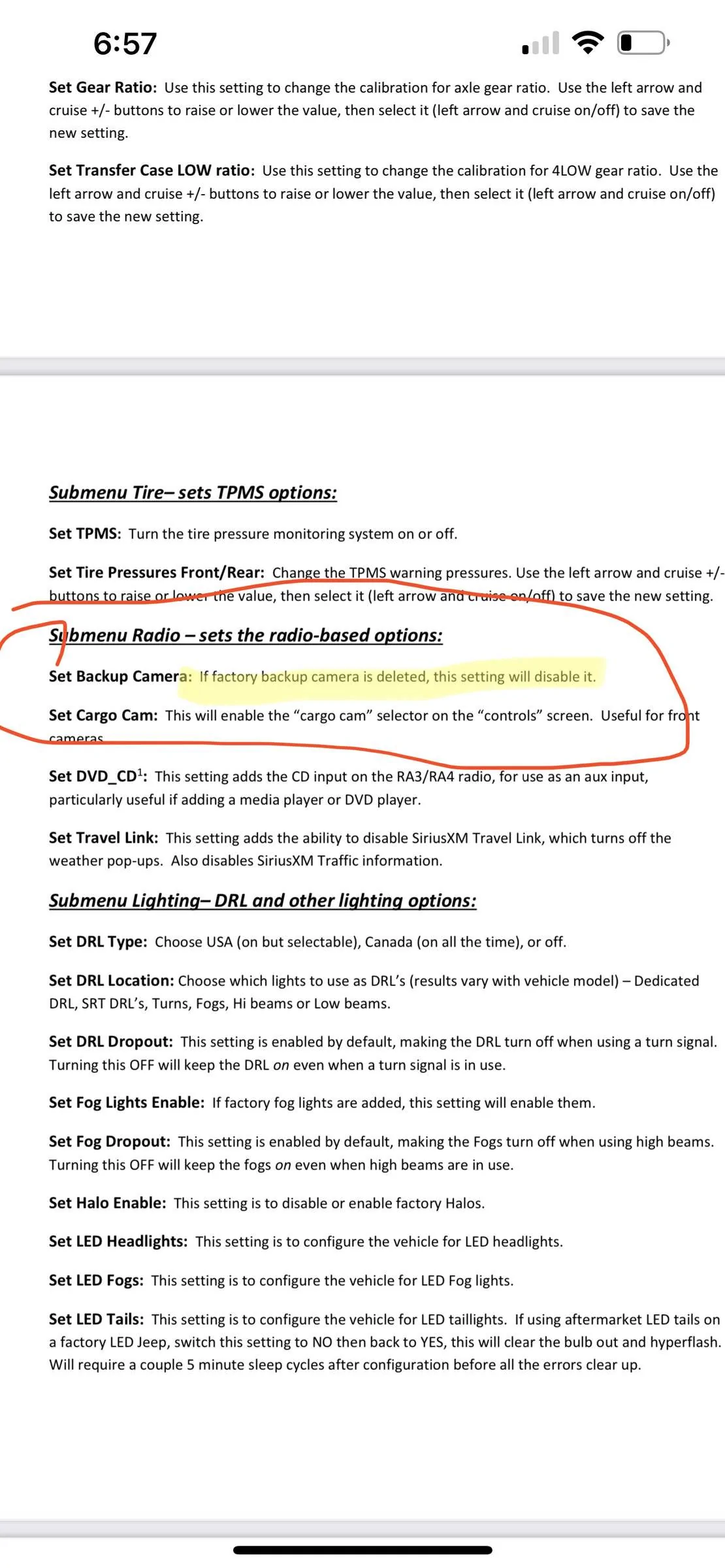

Ok, it’s fixed. So, under live updates, the option for backup cam was set to yes. Well, I have a backup camera and thought it was supposed to be set to yes. When I set to no, and rebooted, everything works perfectly including XR radio. Maybe the question for backup camera is for an aftermarket? Anyway, thanks for the replies and help. Cheers.

BUT......There is a weird issue with those who have the front cam. Apparently the rear cam resolution is nowhere near as good as those without. I think there is something new in software for sure.

Thank you, and yes it’s fixed. A simple selection of no on the backup cam and reboot. The Z auto directions don’t say much about that option, but apparently if you have a factory backup cam, it’s a no. If not, yes. Anyway, smooth as silk now. Thanks again!

agreed. I’m confident Joe at Z Auto will fix with future updates. My front cam may be a bit more grainy after the install, but the rear is still HD. Front is still great though.

Yeah, that isn’t clear to me lol. But, I got it working nonetheless. Hey, what about the cargo cam option? I have the front cam already and the icon under apps is active. Again, is this option for an aftermarket? I don’t understand “Cargo cam”. ?

It’s for adding the zautomotive front camera. If you have the factory front camera leave it alone.

See, why can’t the instructions say exactly your words ? I’m too stupid to interpret.

So, I prepared and read many instructions before installing. After install, and rebooting several times, my rear backup camera is not working properly as it’s a smaller box with an X along with a bigger box surrounding the smaller box with an X and blurry lines at the bottom. Also, the front facing camera isn’t working at all when the icon is pressed in the apps. Lastly, my XM radio plays for 3 seconds, goes blank, then plays for 3 seconds and keeps this cycle without pause. Is the mini a $300+ gimmick or is there a fix you can help me with? Thanks all and Happy New Year.

Man I was busy all weekend so I had to drive mine broken (well not broken but not working correctly) Read this today and fixed also! Thank you
