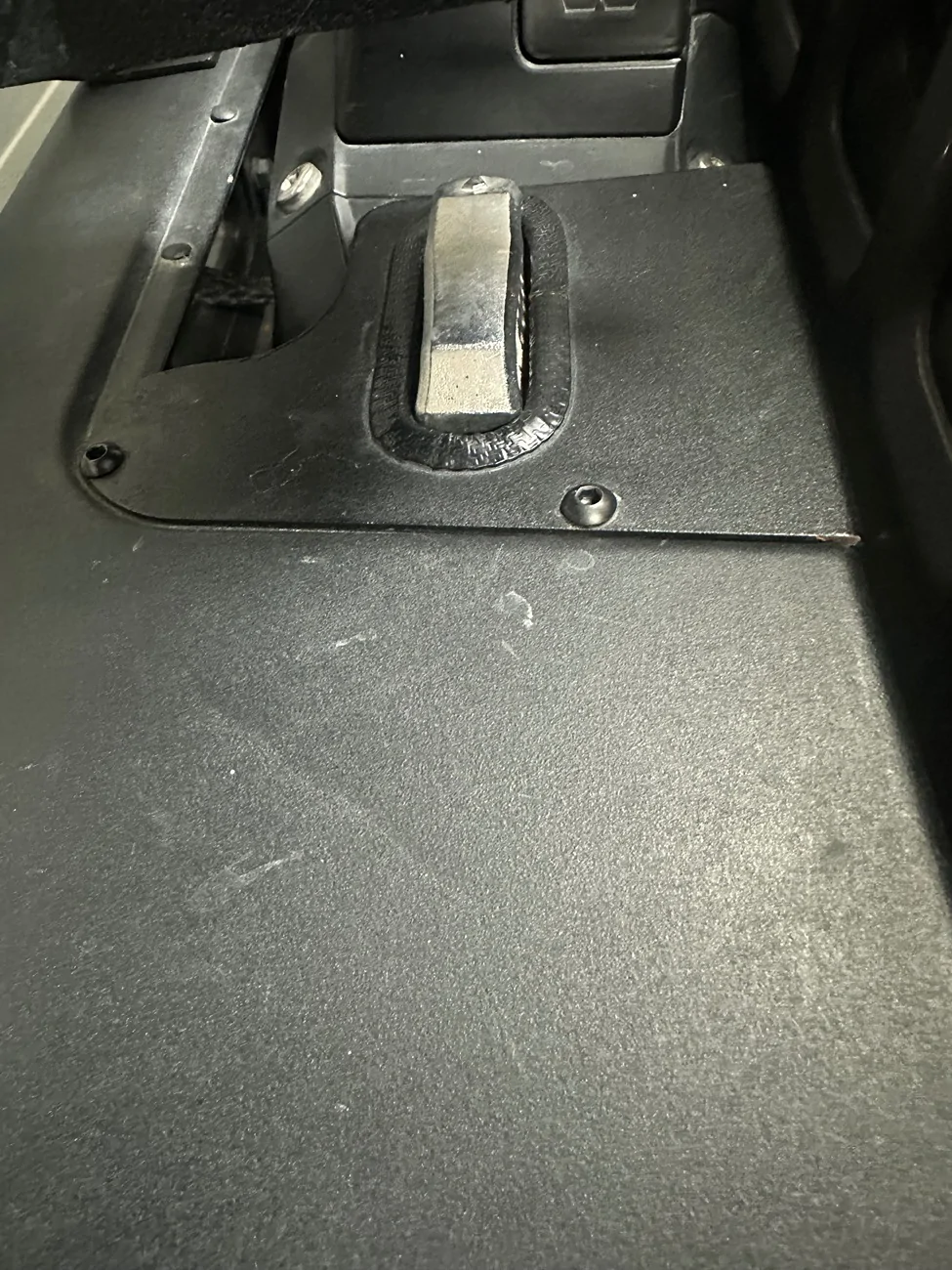

I have my aux switch with a warn power interrupt, and a simple cover around the winch lever for the nefarious hoodlums who stole paper lips out of their science teacher’s desk.
My last question is why not cannibalize a second winch controller made for your winch for the switch assembly.
