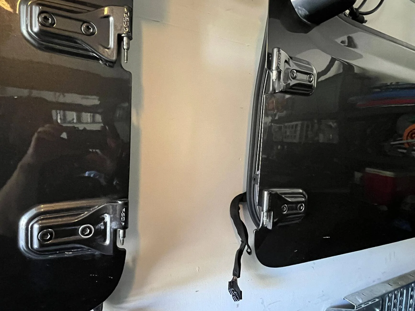

My threads are snapping. I don't ever put the T50 bolts back on, but if my threads snap all the way, will it be an issue getting the door seated properly? Any thoughts, opinions, solutions? See picture below:

Mine are the same. Since the larger hinge bolt part is still there you'll be fine.
