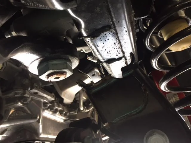

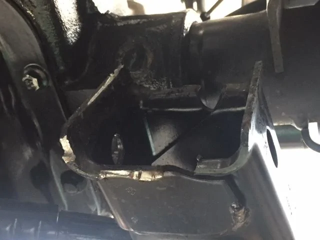

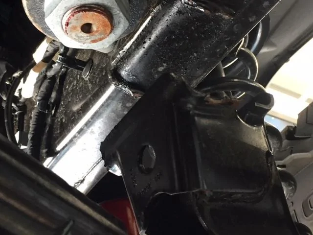

Well my JL is back in the service department. This time it’s not good. Rewind to Friday night. Driving down the highway. Everything is great. I go to switch lanes, turn the wheel and to my surprise realize I’ve lost all steering control in the steering wheel. My vehicle starts to track on its own and I almost kill two other people on the road before I’m able to pull over on the shoulder. (Good thing I was in the middle lane...) I get a warning lamp of ESC (electronic stability control) malfunction.
Call Jeep assist. Tow truck comes. Dealer calls me next day to tell me my track bar has been sheared off At the weld. (Says it looks like a horrible manufacturer defect).

Update: Thanks everyone. Still in disbelief with the situation. Dealer just sent some pics over.

Frame side or axle side? at the weld I'm assuming that means near the joint end?
Sounds like frame side. He is sending me a pic shortly and will share once I get it.

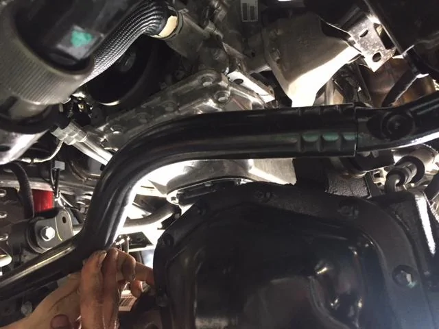

Front or rear track bar? I haven't even crawled under mine yet. But I'll check mine to see what it looks like.

Holy cow that's crazy! That looks like a massive recall just waiting to happen!
