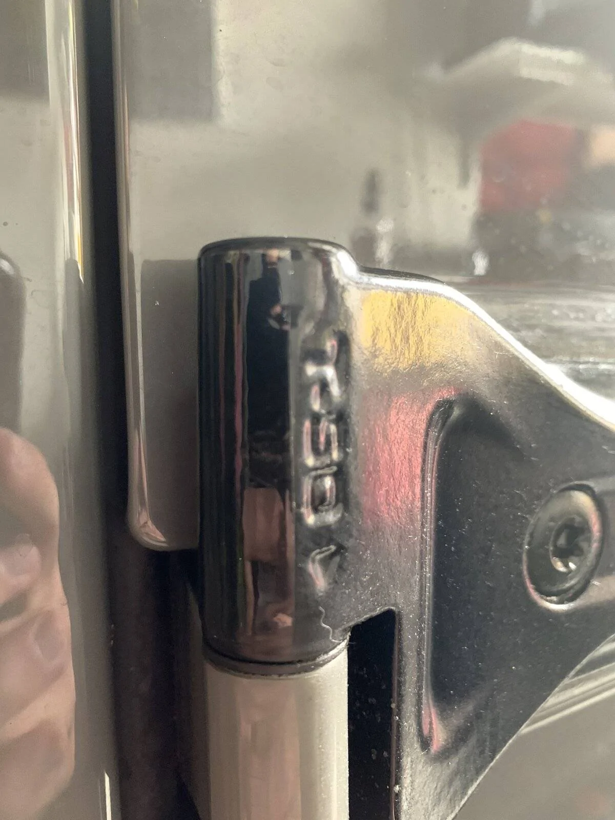

Amazon has some hinge covers. I installed a chrome look set a couple of years ago and they are still there and look better than a bunch of rock chips. Meets all my criteria: works, cheap and easy.

you can just get a generic roll of 3M paint protection film off Amazon for about $15, dont need much. Just make a template and cut rectangles and apply them on the forward facing parts of the hinge. Can’t even tell it’s there. You don’t need the pre cut film sets that cover the whole hinge, waste of money and I’m sure it’s a bear to get all the bubbles out
I generally agree, except the waste-of-money part. To me, it was worth the extra $28 to have them precut. But, then again, I suck at hand-fashioned projects. That's why I asked my daughter to install mine. :)
