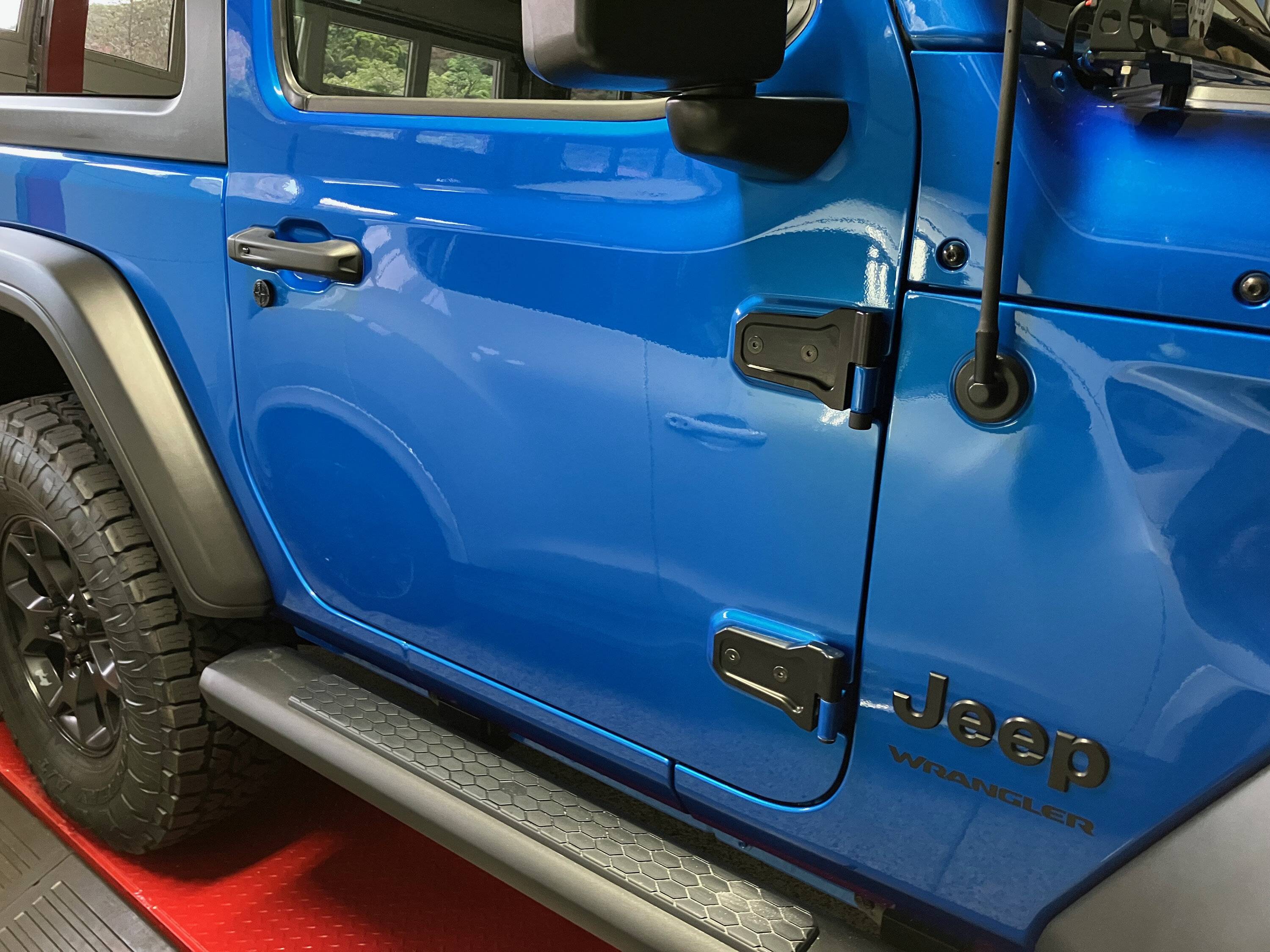

I tried a preemptive strike on the hinge issue by replacing them with anodized hinges from 74weld, and using a 2 part epoxy coating on the supplied SS Door Bolts. I also place a silicone gasket between the hing and the door to ensure a waterproof seal. And FinallyI used a marine grad anti corrosion grease during assembly. Maybe it will work, maybe it won't, but they look pretty nice. Comments and thoughts are welcomed.
