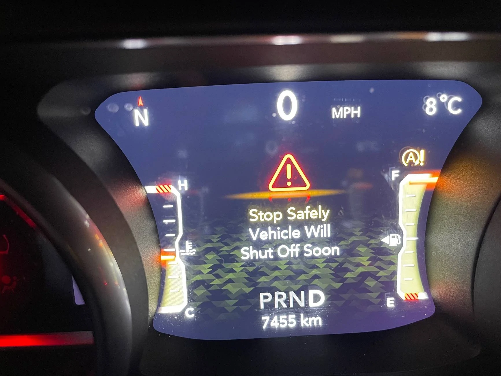

Hi all,
I know after reading hundreds of threads that this issue has been covered to death so apologies in advance for another battery light issue thread, however, I’m struggling to find someone having my exact issue and a possible solution.
I’ve owned the car for 3 1/2 years and have done over 30k miles. From the very beginning I’ve had an intermittent battery light issue where the red low battery light will come on seemingly randomly, sometimes it won’t happen for weeks, other times it will be every 5 minutes. Strangely, the actual voltage can read anywhere from 11.7V to 13.4V. In addition to this, it will sometimes display the “Stop Safely, Vehicle Will Shut Off Soon”. In both cases, a quick restart of the vehicle clears both warnings and everything is seemingly normal.
In the majority of the posts I’ve read the above issues eventually lead to some kind of catastrophic failure that leaves the Jeep inoperable. However, in my case, in the 3 1/2 years I’ve never had a catastrophic event, the Jeep has never actually shut off and the batteries have never died, it’s just the warning lights that have persisted. Even stranger, even though the low voltage battery light is on the ESS will often still work.
For reference, it has been in and out of the Jeep Dealership multiple times for diagnosis and despite changing batteries, alternator and main fuse the issue has persisted. After multiple visits in the space of 12 months when each time they claimed it was resolved, they washed their hands of it citing the accessories being fitted to the vehicle was likely causing the issues. At the time I was exhausted having to fight and repeatedly take the Jeep to the dealership over 200 miles away and given it never actually died I gave up trying to get it resolved through Jeep.
So three years on, it’s now out of warranty so the dealership route has sailed and I’m potentially looking to sell the vehicle due to relocating overseas. I would really like to resolve the issue once and for all as I don’t feel comfortable selling the vehicle with the warning lights and to be honest it would be great to finally know the root cause.
I’ve recently engaged a highly recommended auto electrician to help diagnose the issue but he is equally stumped so if anyone has any thoughts they’d be willing to share it would be greatly appreciated 🙏

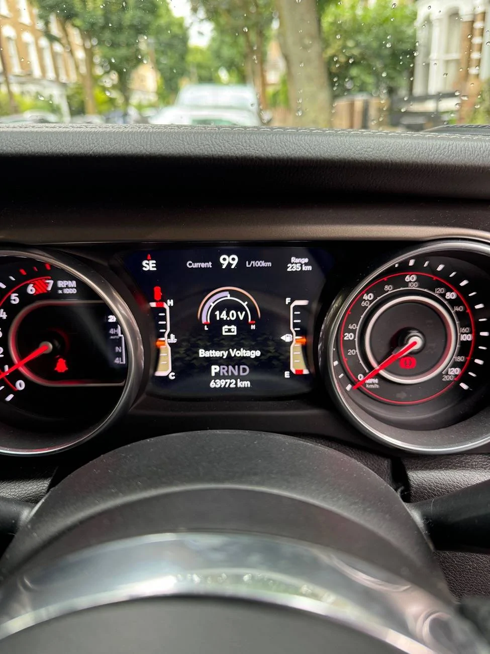

Finally did the test and exactly as you predicted it read 0.9v so then went and checked the earth underneath the left hand guard and it was actually sparking every time the car started.
Removed the earth, cleaned the endpoints and reattached, no sparks on start up and now the voltage reading in the car is consistently reading 14v at idle whereas before it was reading 13.2-13.4.
Thanks so much for the guidance @alphawolff, hopefully this is the end of an almost 4 year saga 🙏
