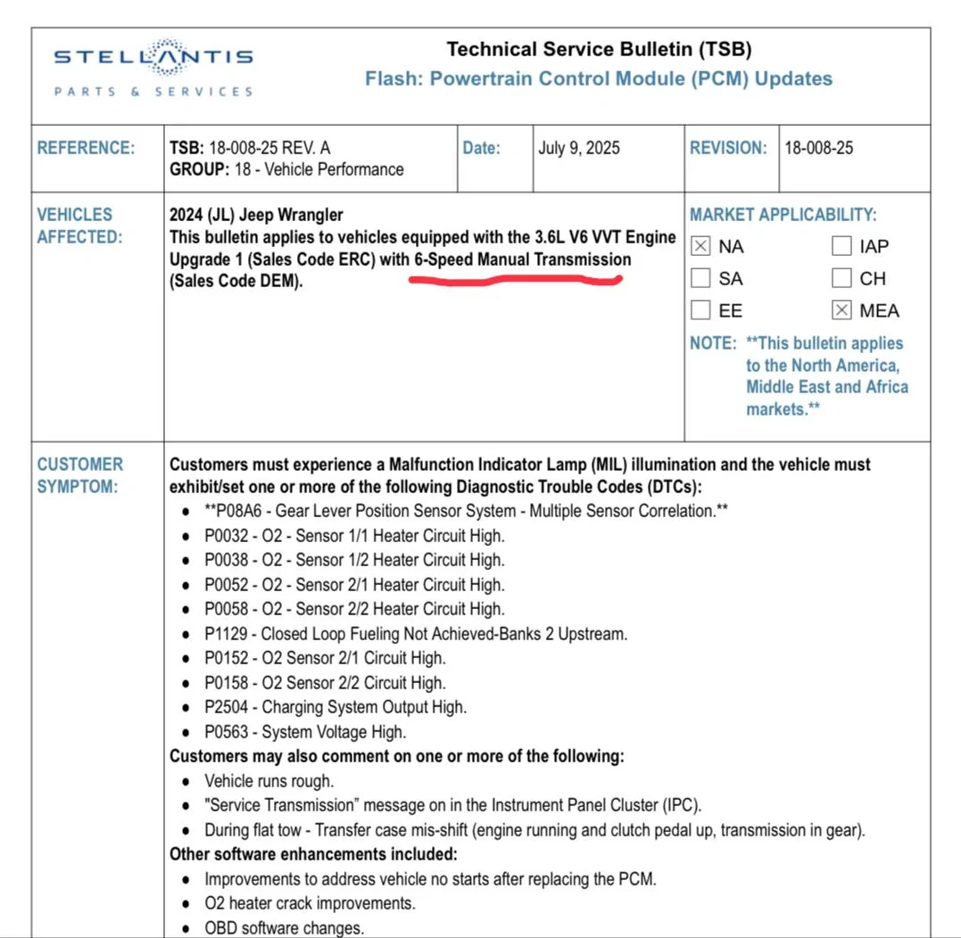

Did you ask about the tsb i posted?

UTME
T
May 22, 2023
656
1,417
2024 Rubicon-X Unlimited
knock on wood mine has been off since the last time they fixed it 7800 miles ago..did you see this tsb that I posted in your other thread...
That TSB is only for manual transmission, correct?
