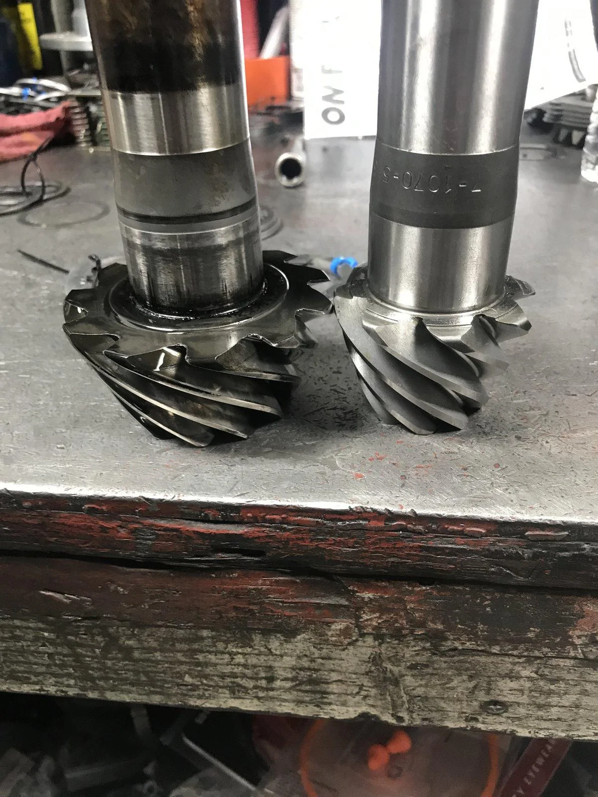

I am not sure exactly but ARB makes a locker that directly swaps in for the sport 44 m220 and the M200. You cannot use rubicon lockers because despite both being 32 spline shafts..the rubicon has different length shafts driver/ passenger..just like the JK.
Of course you will need to get your gears set up correctly again. But from the looks of it you can leave your 3.45 gears.
I regeared to 5.13's and did not have to replace the carrier.
You went from 3.45 to 5.13 and kept the factory carrier? I'm skeptical
intentsrig
Apr 8, 2018
47
1,230
1,048
JLU Sporticon
Sure did. The only new parts that went in were the ring gear, pinion and pinion bearing because the orginal was stubborn to come off. Had to be pressed off.
I watched him do the whole thing.
Cool pic of 3.45 vs 5.13
