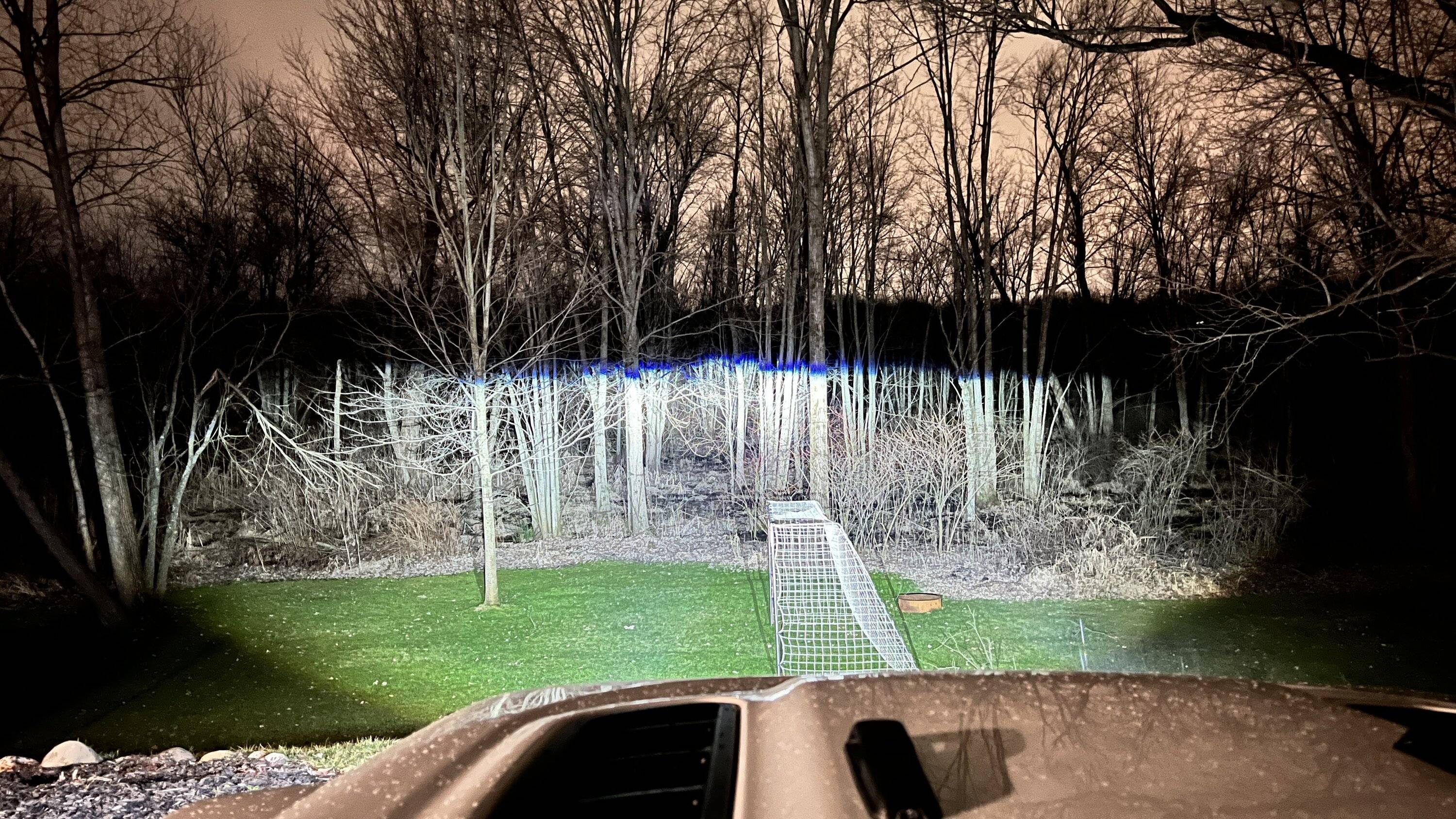

I just installed new Raxiom LED headlights (Projector Style) on my Rubicon JLU XR and I am having issues getting the proper adjustments on the lights. This might now be the best picture but it should work. As you can see there is the area where the lights are hitting and then everything else. Right now that blue line (think my phone did that) is just above eye level. It kind of makes it a little difficult to see up the road. I would love to angle the lights up just a tad, but I am already getting flashed a lot on country roads. Any suggestions here, am I missing something in the setup? I love how bright the lights are.
The older halogen fired reflector style headlamps had a more focused hotspot that could be aimed low enough to not blind oncoming traffic. Both hotspots were surrounded by a wide outer ring of less intense light (corona) that would cast further out to the sides and also further down the road. It was enough to put some light further ahead, without being bright enough to be offensive.
On the other hand, LED projector headlights replace the hotspots and coronas with a wide, bright, and consistent blanket of light, hence the need for the cutoff line.
Low beams are specifically designed for lighting the more immediate area ahead of the vehicle, just far enough to give the driver enough time to avoid objects. Highbeams are meant for throwing light further down the road.
The problem lies in the fact that many of us have been spoiled by the coronas ability to throw light further down the road without blinding others. It wasn't as bright as LED's, but the light was still able to taper off into the distance.
The point of all this, is that we have to get used to the low beams original purpose of nearer field lighting when running LED projectors. We can no longer have both the light throwing further down the road and not blind others at the same time.
I personally keep a long t-handle torx wrench in the rear storage cubby under the cargo floor. Every time that I've changed my ride height, I cruise around at night to fine tune the headlamps. I take quarter turns on the elevation adjustment until the beams are as high as possible without being offensive. I also have the drivers side headlamp aimed a quarter to half turn lower than the passenger side, which helps account for the crown of the road.
My JLUR has now been at 7 different ride heights on its journey to being just over 10" taller than stock height. This is why I find it better to drive around and fine tune the adjustment, rather than use the height and distance from a wall method. It's worked out quite well. The only time my lights can be blinding to others is if I get within about 30 feet of a passenger car stopped at a light in front of me. If I get right on their ass, the cutoff line is just above their rearview mirror on the windshield. If I get that close to small and mid-sized suvs, the cutoff line is above their sideview mirrors. Knowing that is why I typically stay way further back than what's needed for me to see the road behind their rear tires, unless of course they were previously being a dick on the road.
Again, the takeaway point is that LED projectors force us to decide between lighting up down the road and not blinding oncoming traffic.

If you're getting flashed that often, your lights are too high.

They may be incorrectly adjusted from the factory. Mine were, and got flashed a few times before I adjusted.
I can also see better at night with them properly adjusted, because they are no longer causing glare from all the road signs.
