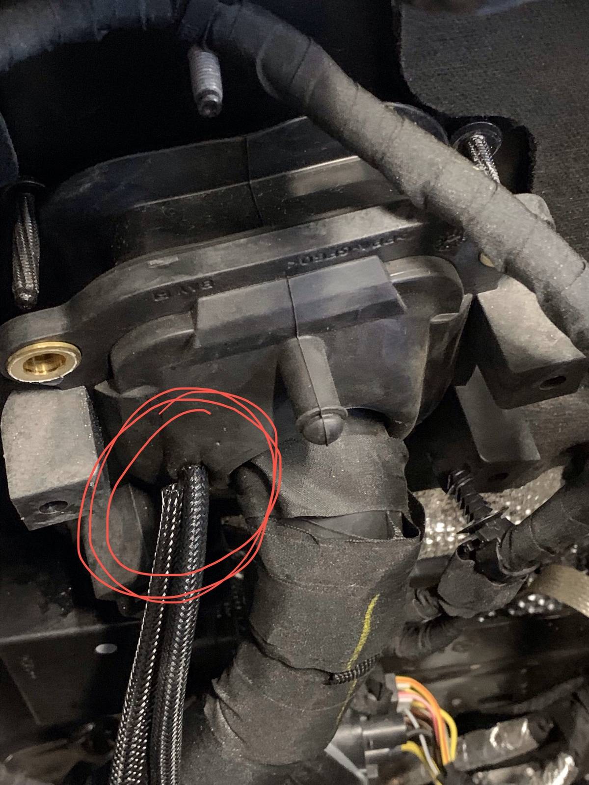

1996cc posted this pic along with that article this pic shows the nipple to use on the grommet for pass through on passenger side. read the article to save yourself a lot of trouble.9 do not go through the red highlighted area! you can see the nipple to use right next to it)

DO NOT RUN WIRE ON PASSENGER SIDE FIREWALL, IT WILL COST YOU $2500. I did it on mine and accidentally pulled some sensitive wire inside while running cables and cost me $2500 just to repair it. It not worth it.
