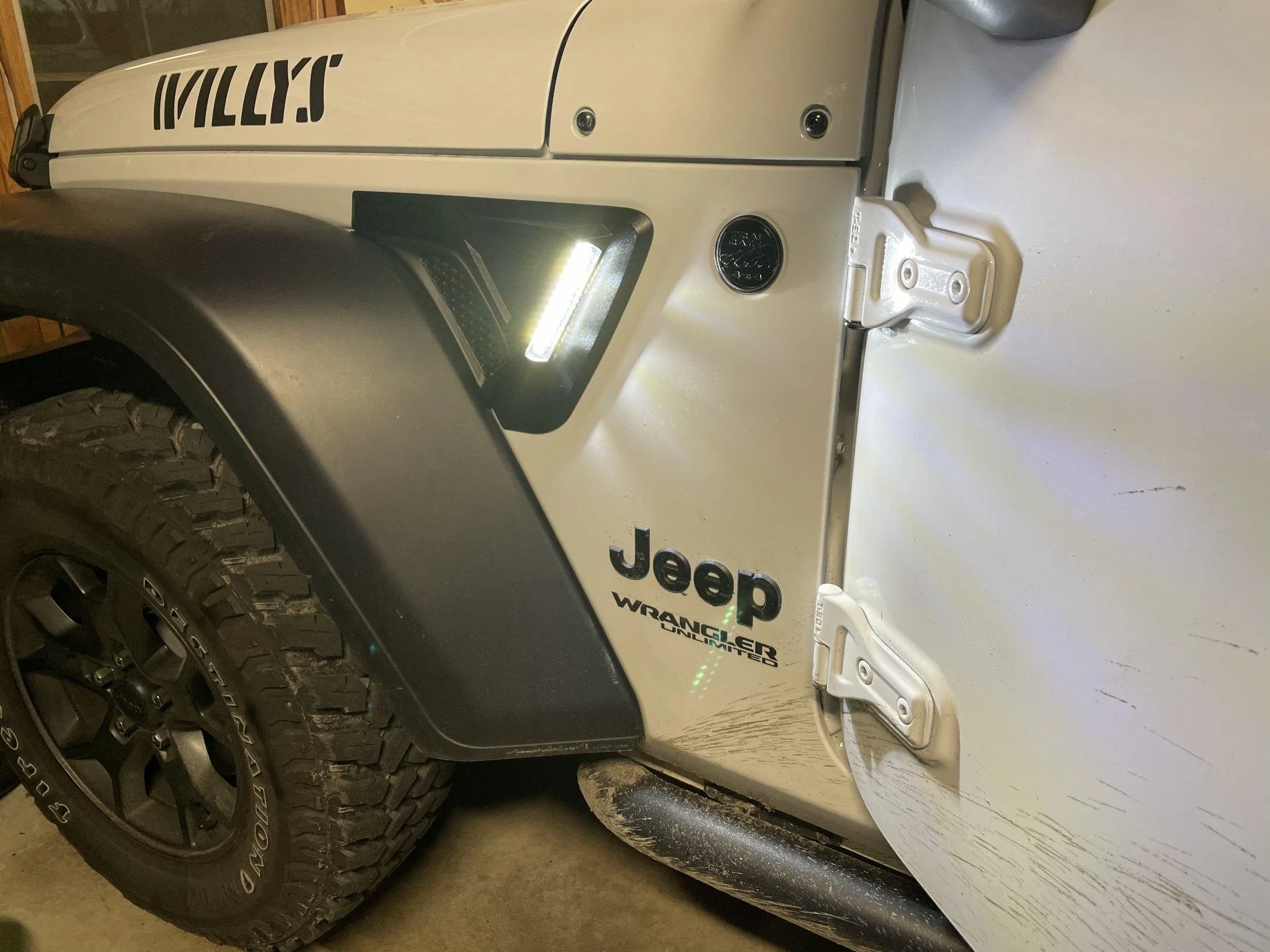

I am trying to install Oracle Sidetrack lights, and was successful on driver side with the grommet that pops right out. Having HUGE issues trying to get through passenger side grommet. SO scared Ill hit a wire. Any suggestions??

Are you revering to the one way up under the passenger side fire wall under the dash?
If so i just ran some S-Tech switch light cable through it the other day. Yes it is a real pain. From the inside you have to use a small razor knife and cut a small slit just to the left of the cable bundle. Now out side remove the front passenger tire. Remove to two bottom Christmas tree plugs on the bottom of the fender mine broke. Pull the fender liner out a bit so you can look way up and see the wire bundling come through the fire wall and make a small cut in that grommet to the right of the cable bundle. I found mine had a grommet on both side. Go back inside and bend a coat hanger down a little and stick it through both hole so you can tape your wire to it. Give it a good wiggle and hard pull and they will come through. I used two black cable ties on the two Christmas tree plugs that broke to hold things together. Good luck.

Might be easier with an extra set of hands. Did mine last weekend with my brother. We first used our fingers to push on the grommet from inside the cabin and under the fender to make sure there wasn’t anything in between. Then, I took a long screwdriver from the fender side to press inward. After my brother confirmed there was nothing vital on the other side, I used the longest screwdriver I owned to puncture through (definitely required some force). We then took a coat hanger and followed the screwdriver back out (there was some wiggling) so the screwdriver could help keep the grommet from returning to form. Made a loop on the end sticking out the fender and taped the white wire to pull through. If you need additional clearance to work inside the cabin, loosen the four bolts of the passenger chair so you can move it backwards.

Thanks everyone. Ended up pushing a clothes hanger (more force than I imagined) from inside cab to out, taping the wire on and pulling it back in. It just took more force than I really imagined.
