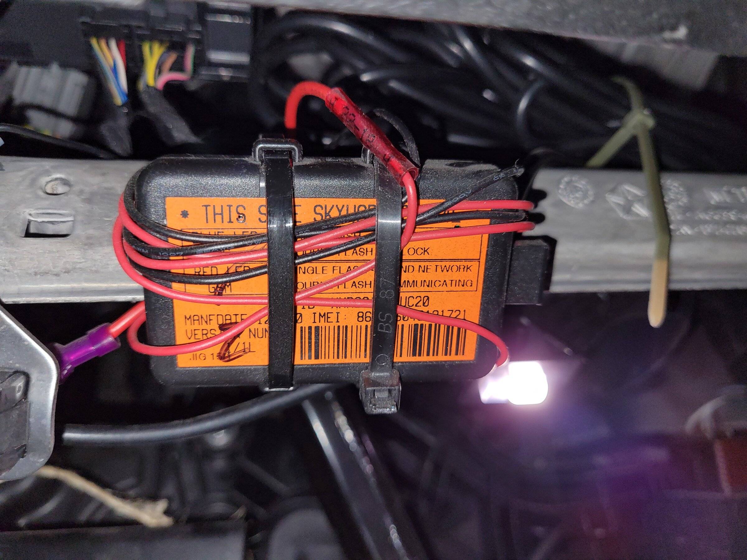

This is what was in my JL when I bought it new from a Jeep dealer in 2020. The dealer had already pre-installed these in most of their vehicles on the lot. It was listed on a "addendum" sticker next to the factory window sticker as part of a dealer "pack" which included this , window tinting, etc... I told them I wouldn't buy unless they removed it and deducted the addendum. This unit is easy to find and uninstall your self because it uses a "jumper" plugged into the factory OBDII conector.
Yeah. I kept having issues with my aux battery and it kept getting depleted, I lost my first one prematurely. When I unplugged this POS my battery issues ended. Maybe this thing is the culprit of many aux battery failures people experience?. But to be honest I am not sure where it draws its power from to recharge itself. Since both batteries are connected in parallel I assume it draws from main which then draws from aux.

I don't have any odb lines connected, I did however find this:
Jeep Wrangler JL I found the sneaky bastard!! 20220302_174732
T-tapped into my odb hot wire, and zip tied yo the dash support. Some sort of Karr system maybe? No led's flashing, but still pulled the inline fuse until I have time to remove it properly.
