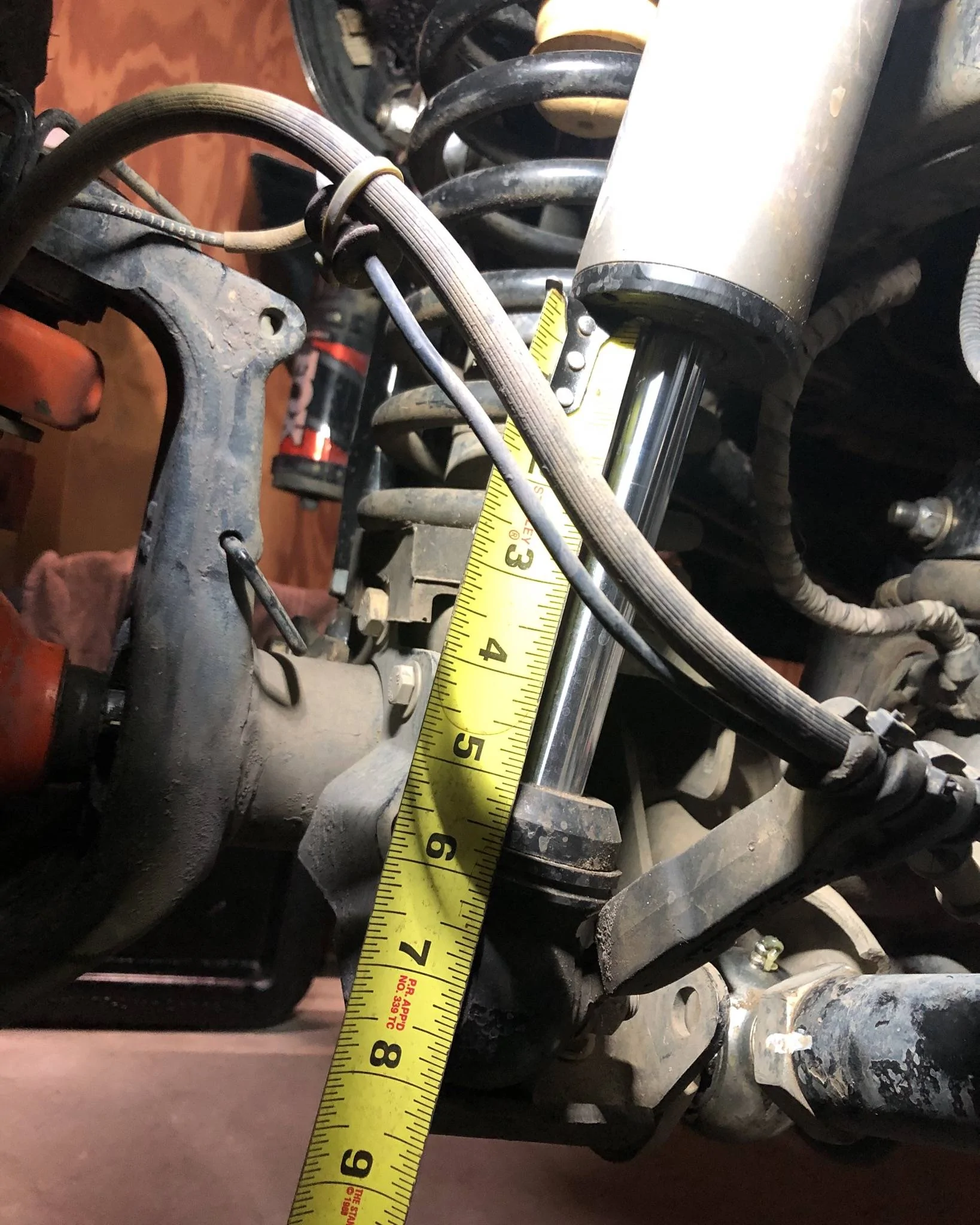

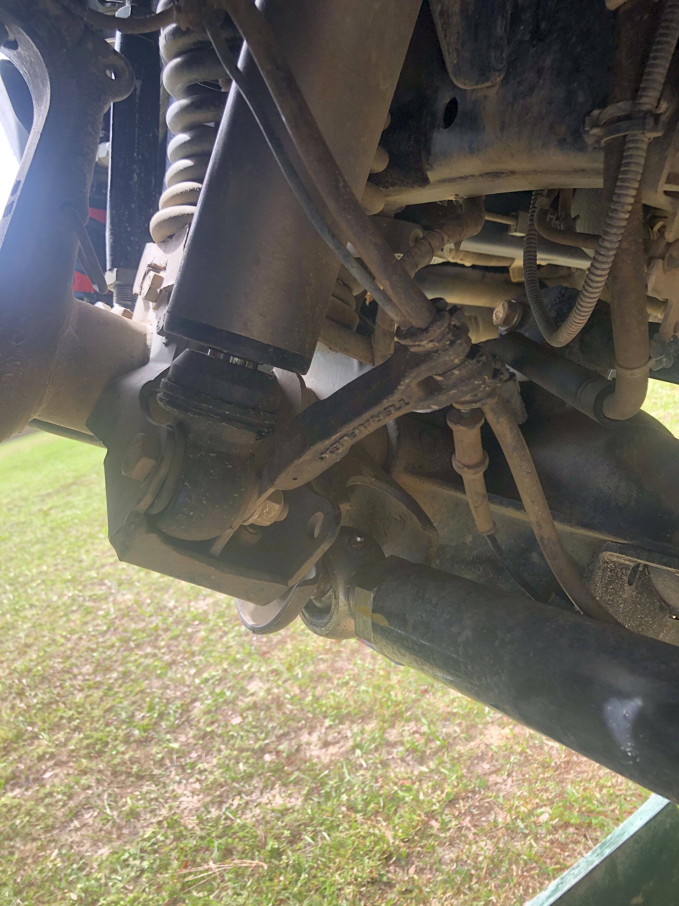

@AccuTunedJL , Hey Mike, is the rubber bump stop on the DSC really help the shock from topping out, or how effective is it? I’m running longer shocks for maximum droop, we mostly climb/ crawl not much high speed stuff. But occasionally we get it going down the trails, potholes, washboard, etc.., and sometimes we get that hard hit. I’ve got 5” up travel, using 4.75” of it with the way I’m bumped…..Sorry OP didn’t mean to sidetrack….
Jeep Wrangler JL Hydraulic Bump Stops 5B545E09-C110-4ECE-B665-F854A8BA6056
Jeep Wrangler JL Hydraulic Bump Stops C500C5B8-BB6E-4ECD-92FC-402E3451A5F5
