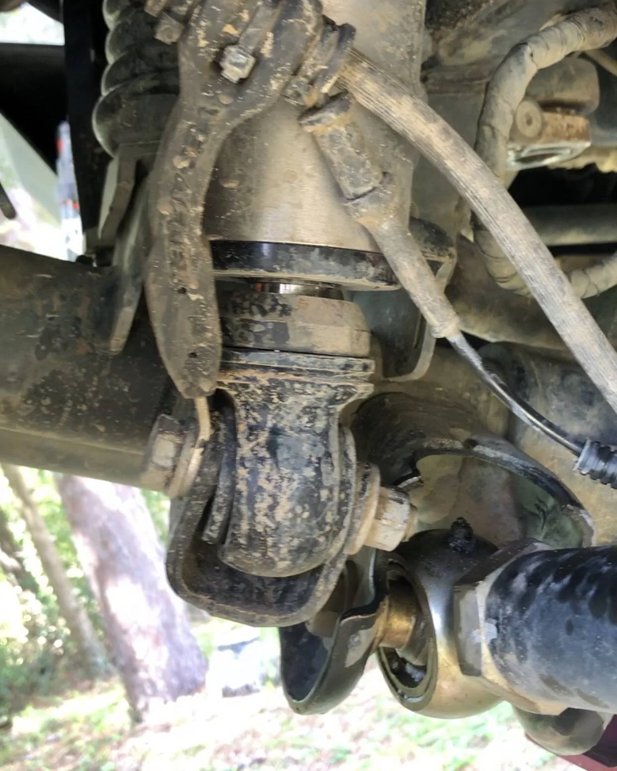

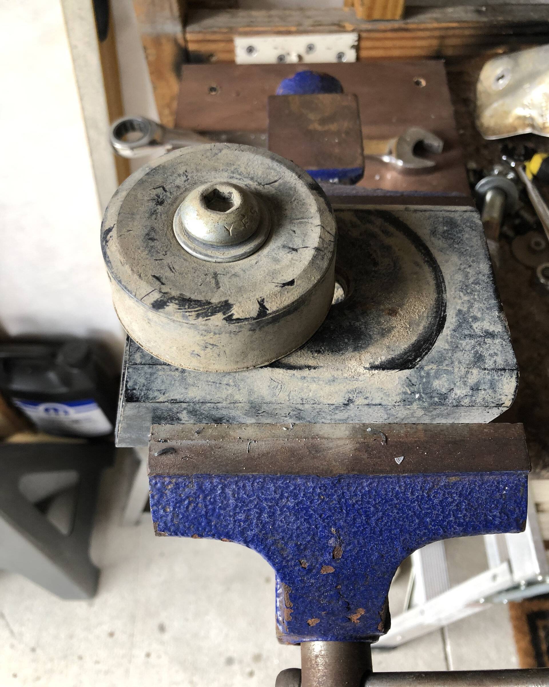

Ah, ok, that’s a 2” bump stop block I repurposed from a Mopar lift, then added one inch pucks and a a 3/4 nut for a half inch to get the 3.5” I wanted. I like tube spacer better, lol….. the hydros are adjustable so I think everything will come off of the axle pad, but I’d have to cycle suspension to be sure.

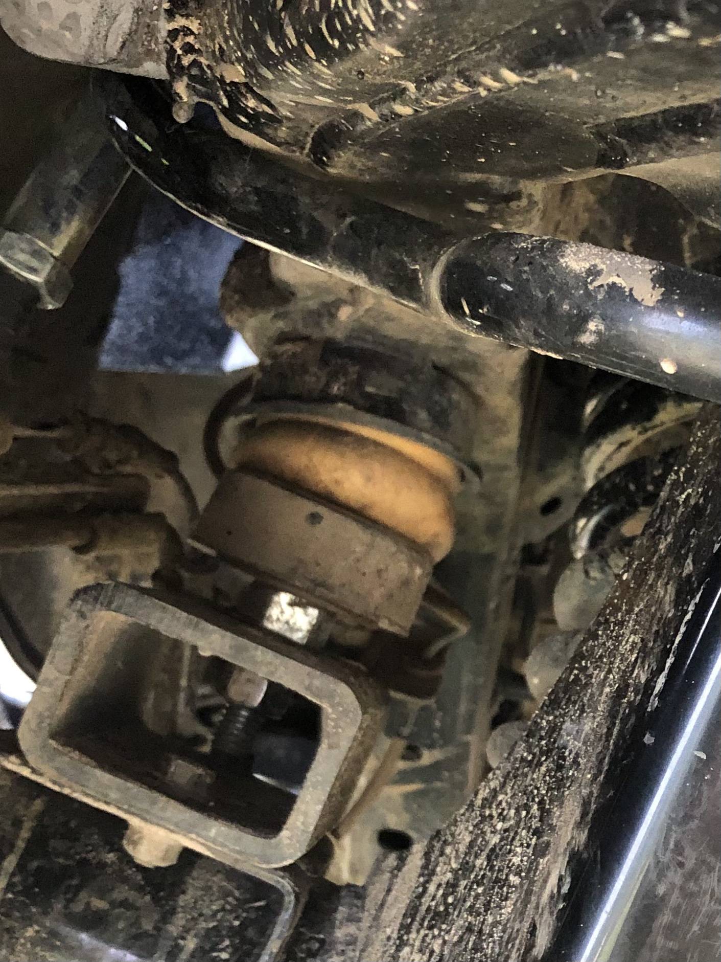

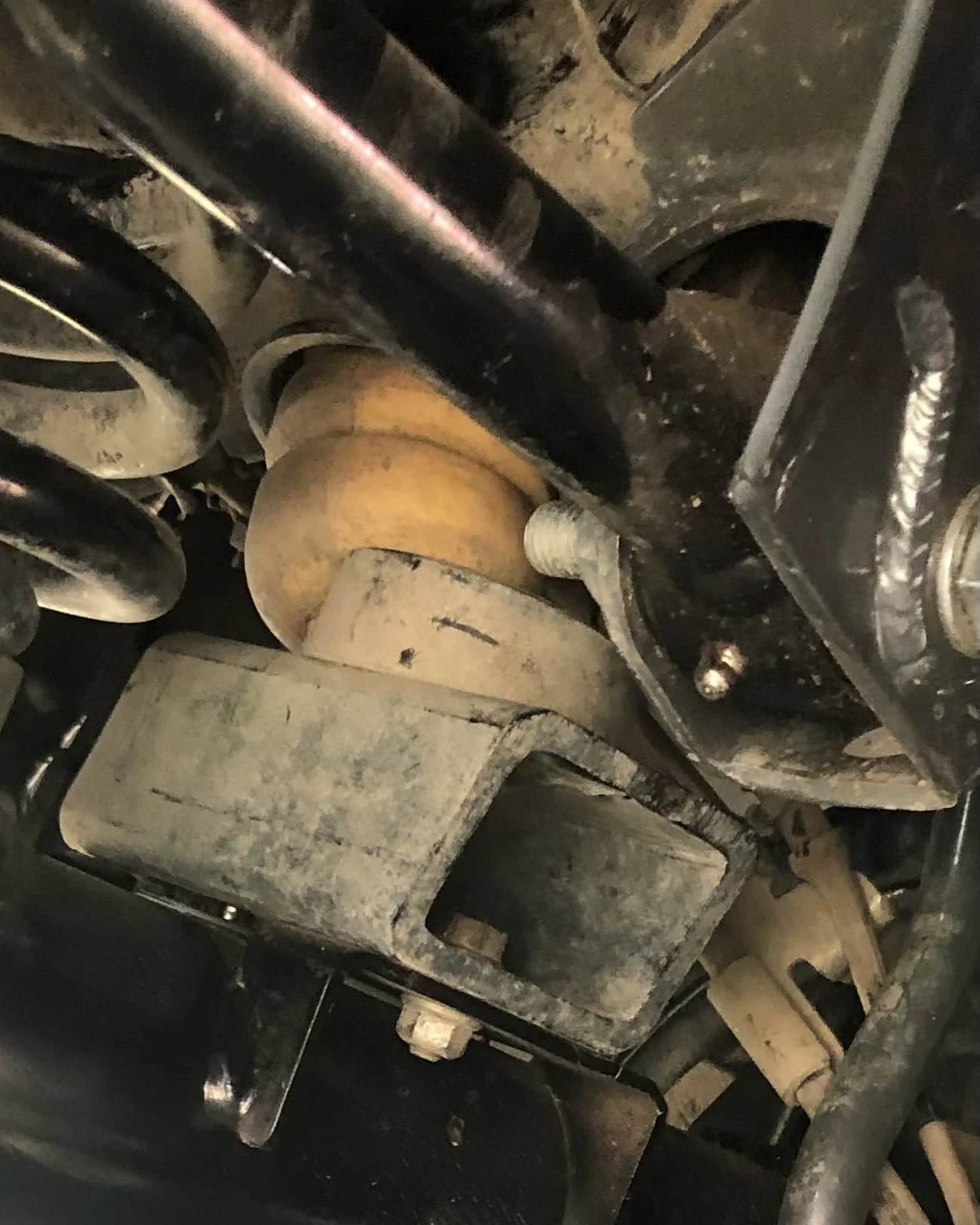

Here’s example of what @Moto_21 is talking about………when stuffed my bumps barely hit in the front…….
I’m considering hydros in the rear though, with my new setup I lost a half inch of uptravel. Doesn’t sound like much, but I only had 5” to start with, with these longer shocks……
In the rear I moved my puck location as a result of new arms, the axle doesn’t move back when it moves up anymore, hits square now ….Before/after……..

They are Rock Krawler 3.5” springs……. The more articulation, the more misalignment…..nature of the beast…you can minimize it with added bumps… but I have my suspension tuned for maximum up travel since I’m running longer shocks, and I only have 5” up travel. My bump stops still hit enough to be effective……I’ve clearanced my fenders, and concentrated on maximizing shock travel……..this setup isn’t for everyone, not ideal for bombing through the desert, but works extremely well for what we do, climb and crawl

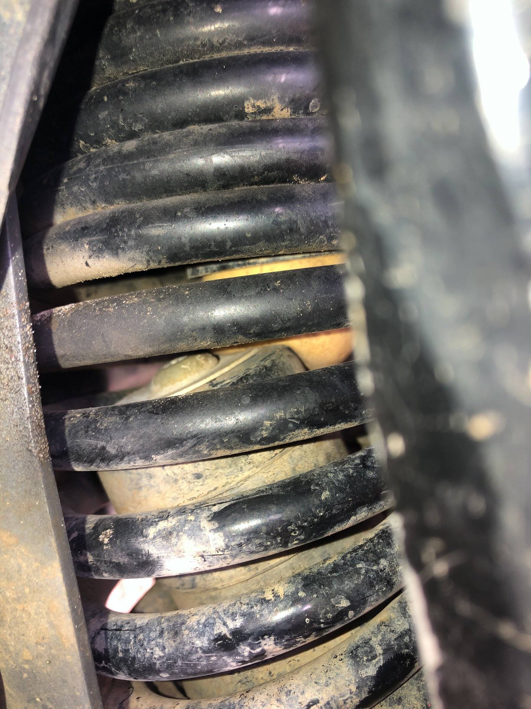

here are some more photos I have to help show what I’m mean, I feel like the springs will bind on themselves before the bump stop will be compressed
I couldn’t test any further because my jack was fully extended
