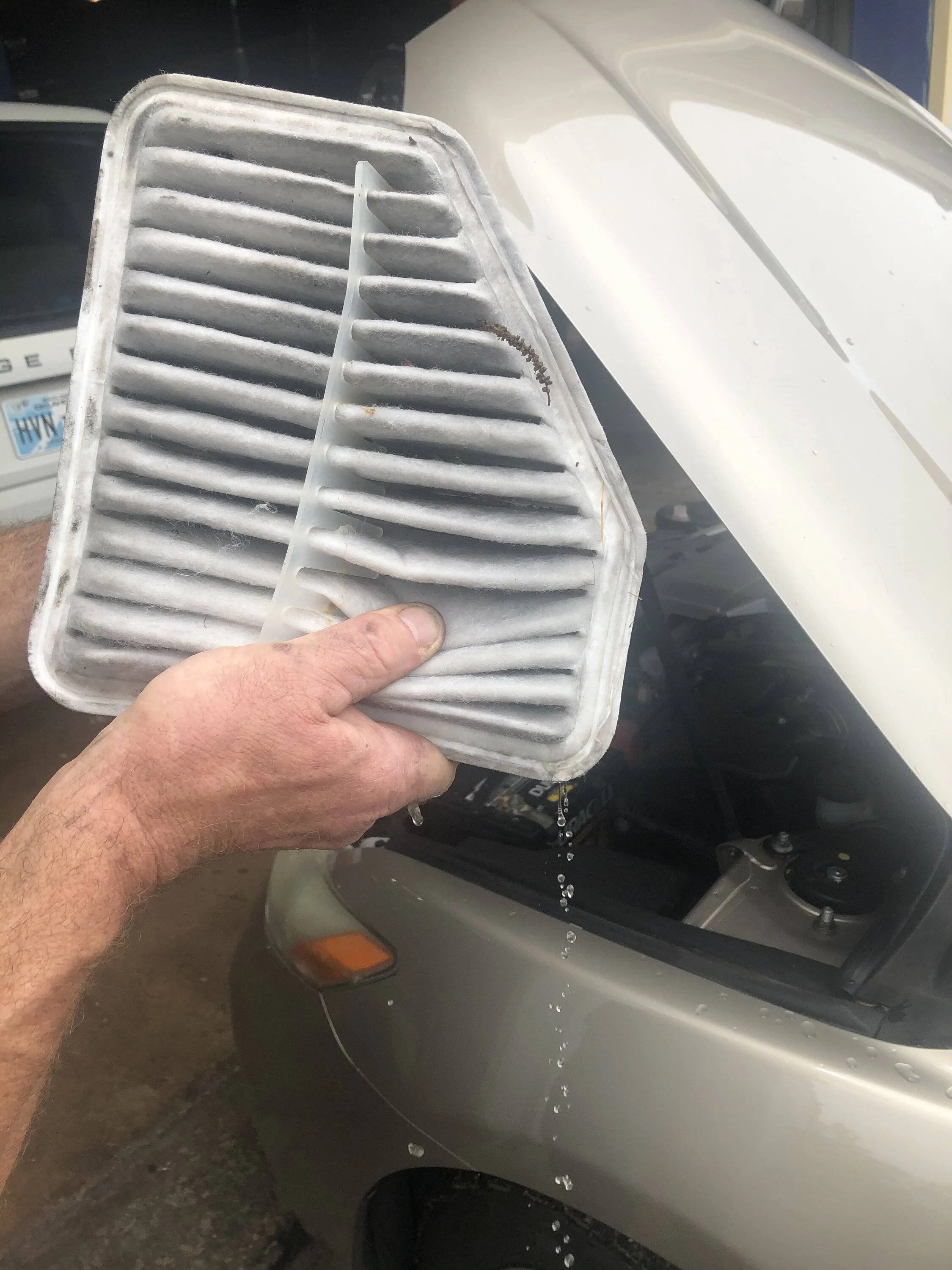

We’ve had a few of these lately. This one was totaled by insurance immediately, because the interior is very damp and smelly now. The engine survived, and it runs now. It’s probably still going to the scrapyard, poor thing.
