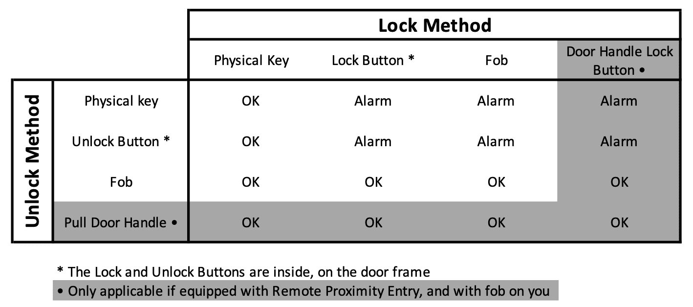

@Rhinebeck01
In regard to a JL/JT with proximity.....
To clarify your post..... once you lock with the FOB, opening with a key and not with the fob will set off an alarm...
IF you lock the door with a key, you can unlock any door/tailgate with a key or remote button push and not set off an alarm...
>>> Yes that sounds about right. I think the confusion comes from the 16 combinations of locking / unlocking methods. So I made a chart. Disclaimer: This only reflects my understanding of how things work. I have not tested this.
Jeep Wrangler JL how to lock doors while inside? Screen Shot 2021-08-29 at 15.58.12
