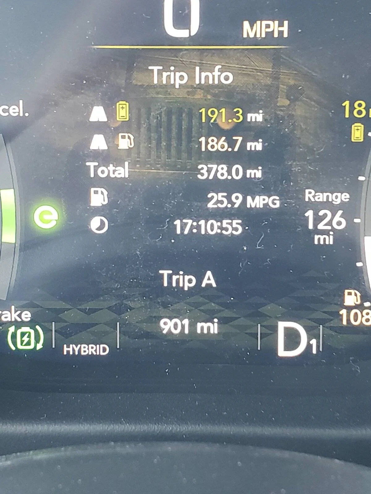

Here is my most recent test, this was using 11.3 gallons of gas. From these numbers, the MPG is being calculated as use of gas AND use of regenerated electricity. If it were calculated on gas only, my MPG should have read 16.52MPG, and if it was calculated on both electric and gas (including charges) it would read 33.45MPG.
I plan on testing keeping track of "miles added" with recharges. It will obviously be a little off but will hopefully confirm my suspicions that the MPG displayed is for hybrid miles not including charges.

Electric only miles are counted by trying to calculate "MPGe" and factor it into the MPG displayed. Its total BS to me. They should just have 2 meters, one for fuel used, one for kW/hr used.
If you reset your trip meter at a full charge and drive around, the active MPG screen will show 99 while moving in electric. If you look at your MPG average, it will represent the MPGe until the engine kicks on.

Yes. I think you are right. It’s is calculating mpge when running full electric . The way you can tell is when you stop moving, there is still some electric energy being used and your mpg(e) starts to drop.

Tried this on my next recharge and the MPG read the same at 25.9MPG (never showed 99). It did change slightly while driving in all electric tho...
