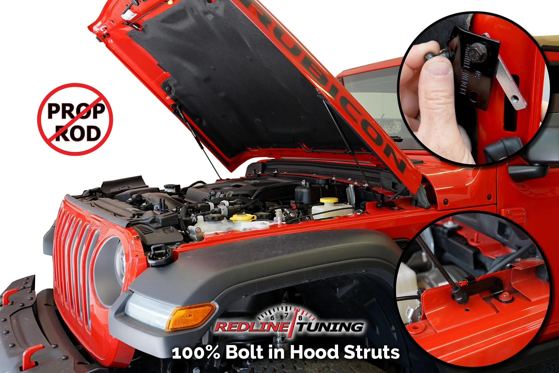

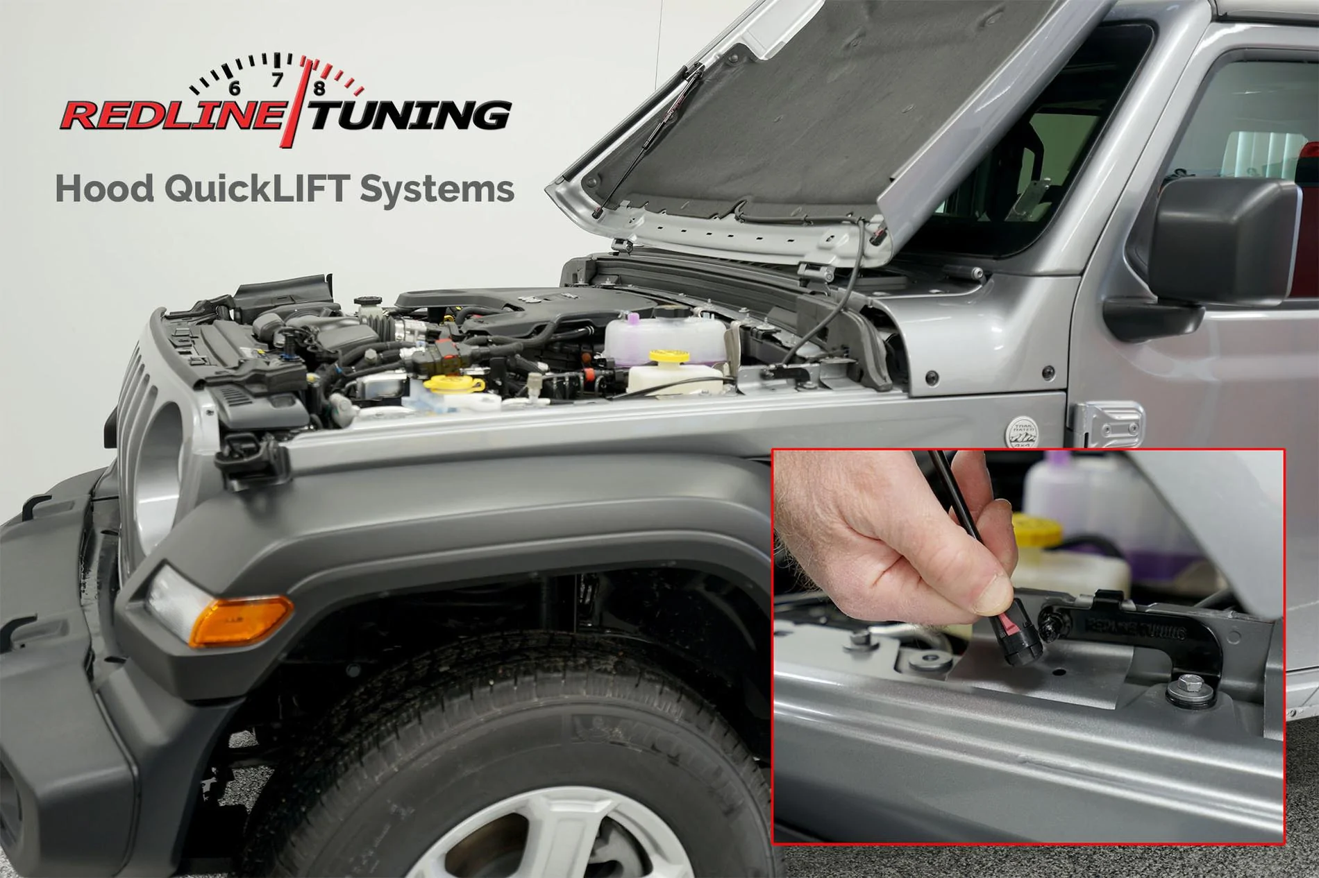

[QUOTE="They have Quick release end fittings on the lower mounts so I can release them and lean the hood on the windshield.
Thanks! I was just going to ask about this.[/QUOTE]
Jeep Wrangler JL Hood Strut Kit rt-qr-layout-jpg-jpg
Jeep Wrangler JL Hood Strut Kit rt-jeep-layout2b-jpg-jpg
QuickLIFT PLUS features:
* All black powder-coated mounting hardware
* Black e-coated gas springs
* 4 year warranty
available directly from our website here: https://www.redlinetuning.com/product-p/21-20003-02.htm
QuickLIFT ELITE features:
* 316L Stainless Steel gas springs
* 5 year warranty
available directly from our website here: https://www.redlinetuning.com/product-p/21-20003-03.htm
Free shipping in the CON. U.S. on all JL and Gladiator systems using coupon code "JL Wrangler forum" at checkout.
You can watch the video below to see how easy our installation is, the only tool required is a 10mm socket:
To see how the system functions and how easily you can release the gas springs to lean your hood back on the windshield please watch the video below:
Redline Tuning has been developing our Hood QuickLIFT systems for over 20 years and have applications for over 350 unique vehicles, check out our website for your vehicle application.
Please contact us for any questions.

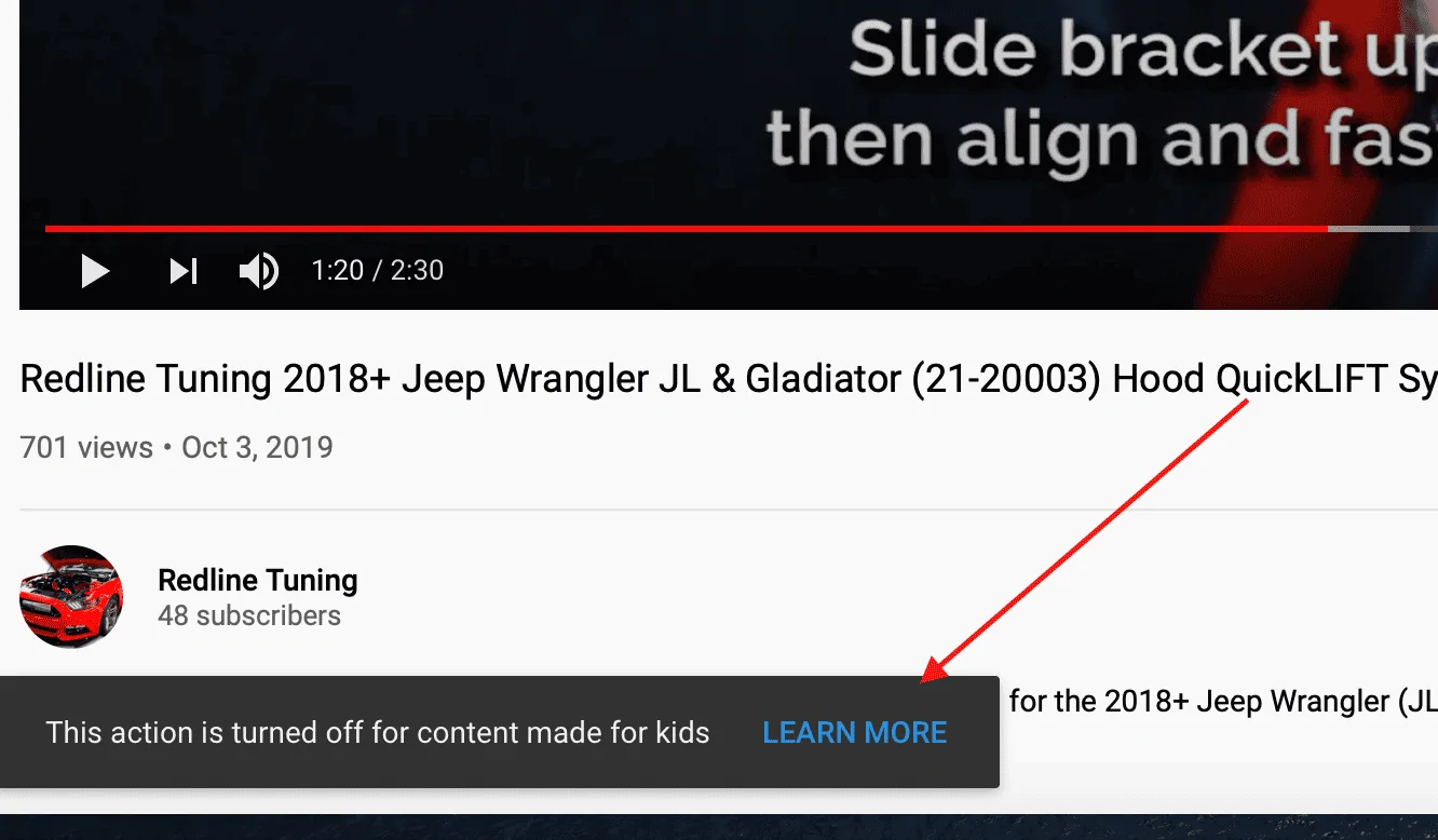

Pinging @Redline Tuning ... you have your settings for your Youtube installation video as being content made for kids so the video can't be saved to a folder. It would be great if you can change that setting so folks like me can save it to a Youtube folder (in my case my Jeep folder).
