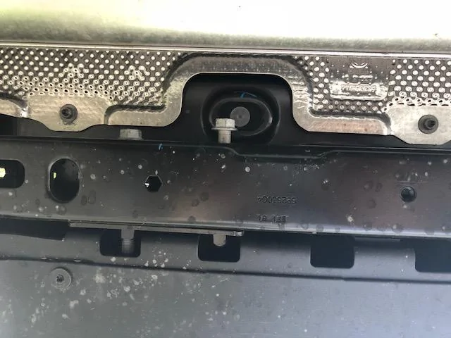

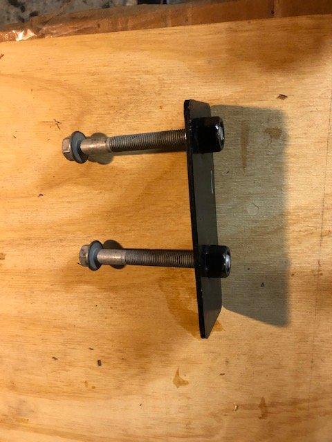

I installed a trailer hitch receiver today from "CURT", ordered it off Quadratec. The price was $104.22 with a tax of $6.25 it came to $110.47. Install was easy enough though I have a steel bumper and there was what I would describe as a metal spacer back there. That brings me to my question.... what is this thing?
The first picture shows it while still attached, I have started to back out the nut. The second image shows it once removed.

It had to come out in order to properly install the hitch receiver.
As far as install it was straightforward as I mentioned:
  1. Remove that piece I don't know what it is (hopefully soon to find out, thanks in advance)
  2. Rubber mallet the hitch receiver in place and bolt it on
  3. And now whammy, you can attached a bike rack
Thanks Everyone

Glad I came across your post. I have a 2018 Rubicon Wrangler JL And just installed a Curt hitch (Curt 13392). That spacer with weld bolts is perplexing. Seems it’s only purpose is to hold two bolts (that require a 18mm socket or wrench) that seem to do nothing. The installation instructions from Curt say “Note: Some models have existing bolts attaching a plate with weldnuts on it. The hitch will need to be slid between the bracket and the mounting tube with the factory hardware reinstalled, securing the hitch”. There is no fricking way to slide the hitch between that bracket (spacer) and the mounting tube. I had to loosen the two bolts that go into the bumper with a 16mm socket and had to use a pry bar to slide the Curt hitch over the mounting tube and then use a rubber mallet to get the hitch on fully. Then I just used the 3/4” bolts that came with the Curt hitch. I just saved that factory bracket (spacer) with the weldnuts and the two 18mm bolts off to the side , though I don’t see a reason to keep that long term.
