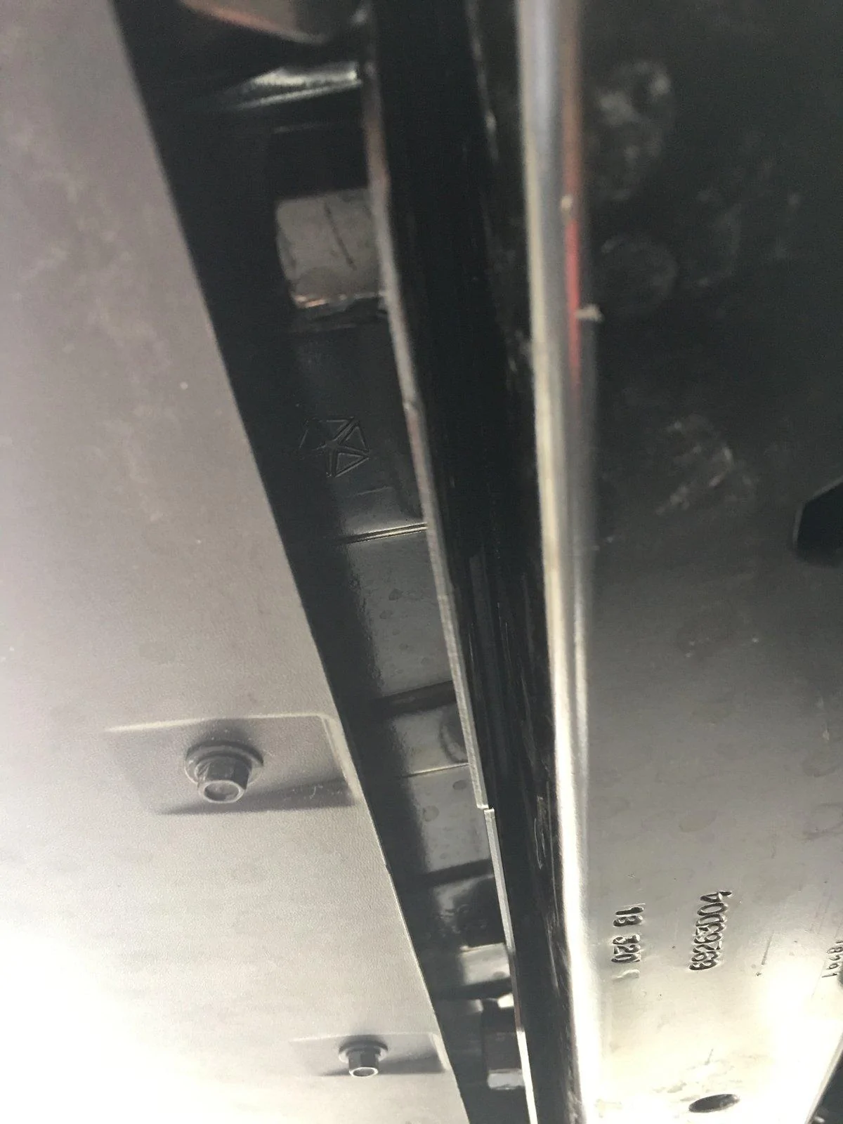

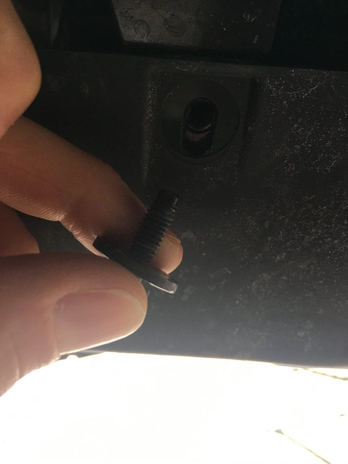

I installed a trailer hitch receiver today from "CURT", ordered it off Quadratec. The price was $104.22 with a tax of $6.25 it came to $110.47. Install was easy enough though I have a steel bumper and there was what I would describe as a metal spacer back there. That brings me to my question.... what is this thing?
The first picture shows it while still attached, I have started to back out the nut. The second image shows it once removed.
Jeep Wrangler JL Hitch Install Question image1 (1)
Jeep Wrangler JL Hitch Install Question IMG_2594
It had to come out in order to properly install the hitch receiver.
As far as install it was straightforward as I mentioned:
  1. Remove that piece I don't know what it is (hopefully soon to find out, thanks in advance)
  2. Rubber mallet the hitch receiver in place and bolt it on
  3. And now whammy, you can attached a bike rack
Thanks Everyone

There is another forum thread where this "spacer" as you call it was mentioned. No one knew exactly what it was, but all reported they removed it.
Save it obviously but don't worry about it's removal.

Glad I found your post! I have the steel bumper as well.
Tried to mount my MOPAR trailer hitch last weekend and couldn't because of that weird spacer.
Didn't know it could be removed - how did you take it off after removing the bolts?
Thanks!

Did you ever figure out how to remove that spacer after taking out the bolts? I just picked up a new 2019 JL with the steel bumpers and am trying to install my old JK hitch. I removed the two bolts as toomanyhobbies did in the OP but my spacer seems to extend into the bumper (not just a flat plate that allows it to be removed vertically down) and looks as if it won't come out unless I remove the bumper to slide it out horizontally.
I have the same issue. how did you get the "spacer" out?

The spacer use a small pry bar open the gap after the bolts or out and it will fall out don't get hit in the face because it is steel.
The spacer wouldn't come out for me the way it was described in the CURT receiver instructions or based on the other comments above. I have a 2019 Sahara without the steel bumper option. My "spacer" plate is also larger as one reviewer mentioned. There were 2 bolts and 2 screws that needed to be removed when installing my CURT receiver hitch. I removed the 2 bolts like everyone described but tried to pull the plate out and it wouldn't budge. I also tried to slip in the hitch and it was way too tight. The only way it worked for me was to remove two screws that also attached to the plate. Once I did, the plate moved but still couldn't be removed. However, it gave much more wiggle room and I was able to slide the receiver perfectly into place. I used 2 of the hex bolts that came with the hitch and the 2 original bolts as they fit much easier and reinserted the two screws that I had removed. Really solid hitch but need some updated instructions :)
