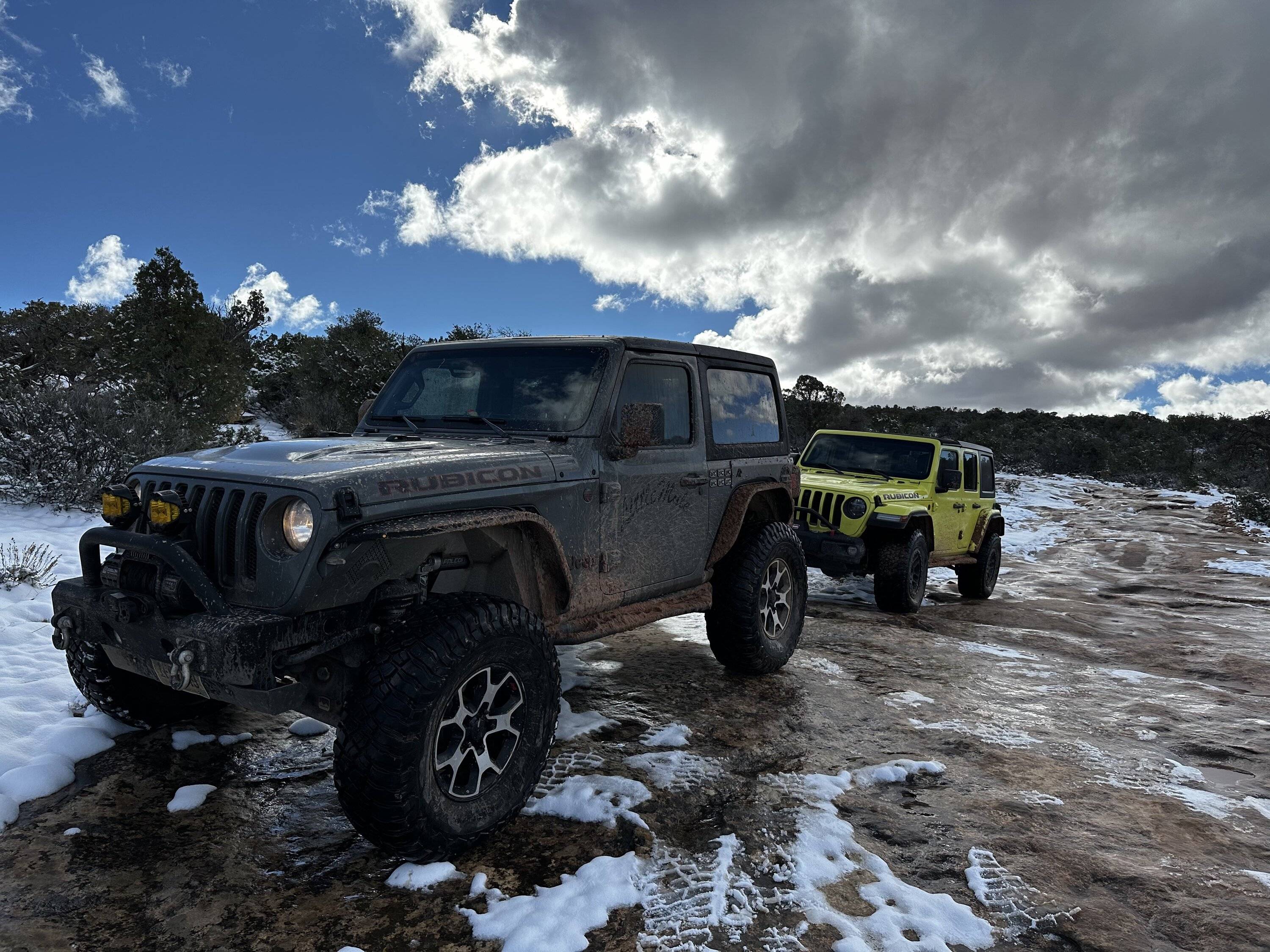

I went with 37s and a 3.5” lift on my two door. You’re definitely a little tippier, but no regrets on the highway. Concur with getting the caster right!

You generally get what you pay for. If the kit just contains springs & shocks your geometry will be off and it can be detrimental on the highway. The biggest thing would be adjustable lower control arms to not reduce your caster. That's huge on the highway. Then adjustable track bars to re-center the axles. Lifting with the stock track bars will shift your axles to the driver side in front and passenger side in the rear. How much will depend on how much you lift. While driveable it's obviously not ideal. Better off centered.
When I did my lift I got all the parts to fully adjust. 2" OME springs, shocks, adjustable UCAs/LCAs and Track Bars. Drives better than stock on the highway because they're good components and everything is perfectly adjusted for the new height.
Some might consider that overkill and unnecessary. They're kinda correct but my engineer OCD wouldn't accept "good enough" and I think it's completely worth it for how well it drives.

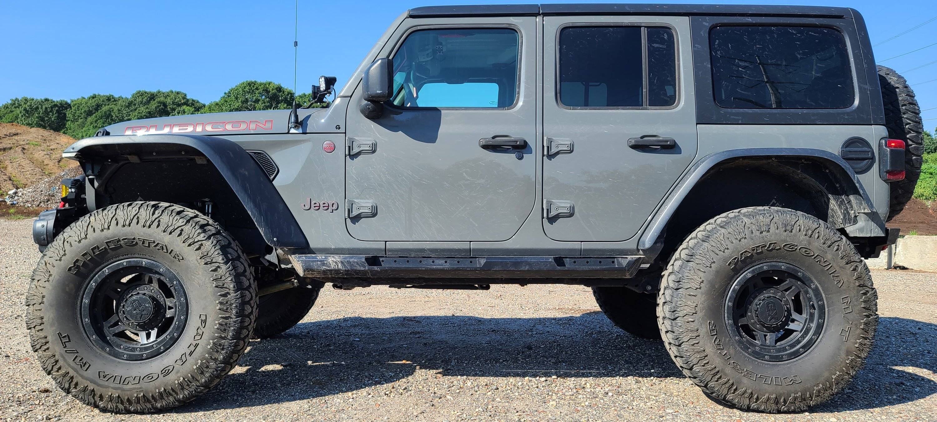

You can also gain clearance by chopping your fenders to keep a lower center of gravity and keep your suspension stock or at least the parts req'd to a minimum. @Headbarcode and many others have done the fender chop and it looks great when done well!
Or if not longer shocks, a good spacer lift will also include relocation brackets for the factory shocks. That will maintain factory suspension travel vs limiting down travel with just spring spacers.
That approach can save some money for a possible future swap to an actual suspension lift.
I know that you know this, blnewt, so it's meant for other readers who are working on their Jeep knowledge.
And yeah, a fender chop can increase tire to fender clearance by about 3.5" in the front and 2-2.5" in the rear. Rubicons and Saharas have 2-piece fenders, which makes it easy to split the outer shell from the innards. The Sports have 1-piece fenders that can still be chopped, but with the added step of cutting a similar parting line, which is easy with a smaller cutoff wheel on a grinder or dremel type of tool.
