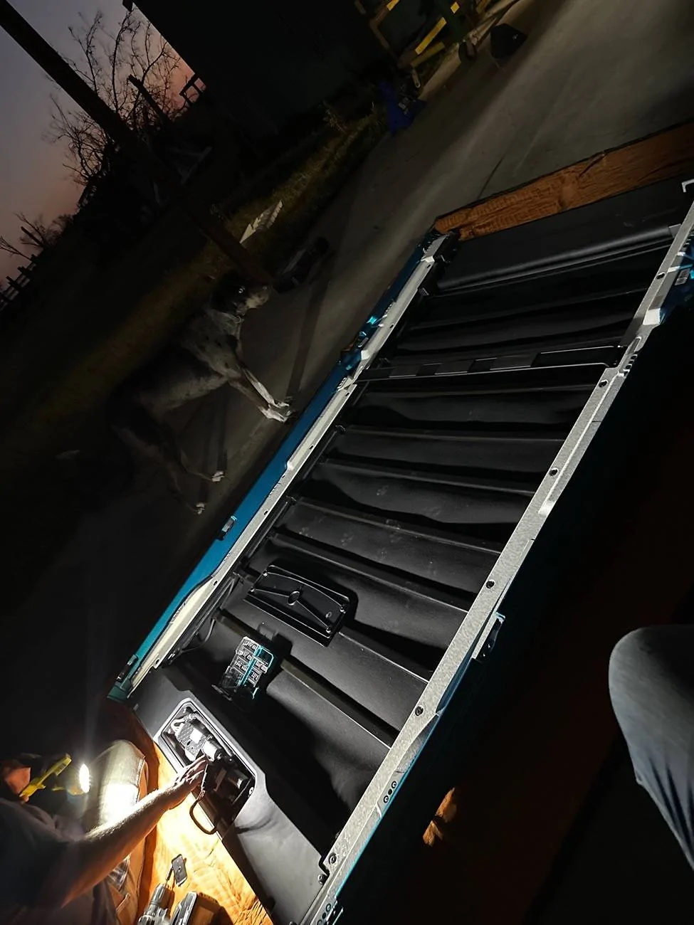

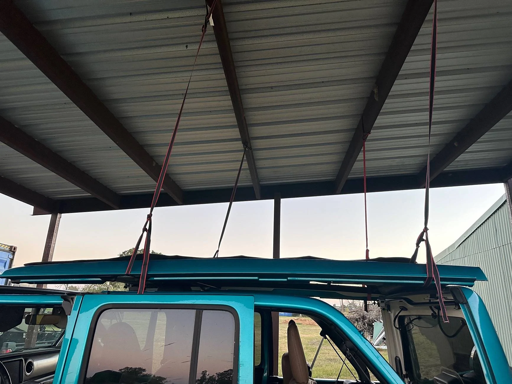

Two months ago when mine first happened, I searched the net for any info that led me to hope it might be simply due to a screw working itself out and falling into the track.
We’ve taken off the top and trying to investigate
