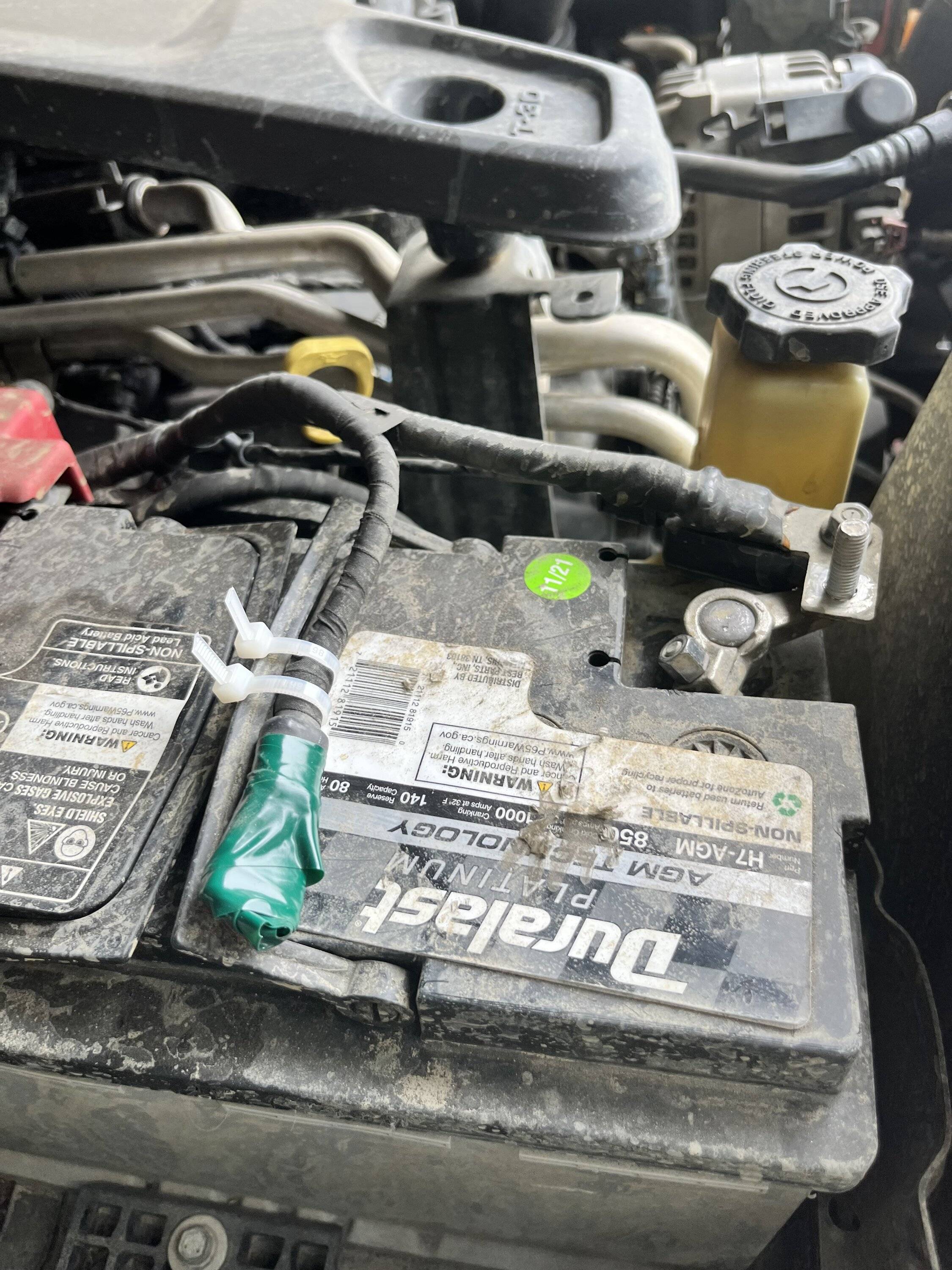

No need to remove the battery. Negative cables are right there at the negative terminal on the top of the battery. AUX ground is the smaller diameter cable. Remove it, wrap the terminal in something like electrical tape and tuck it aside.

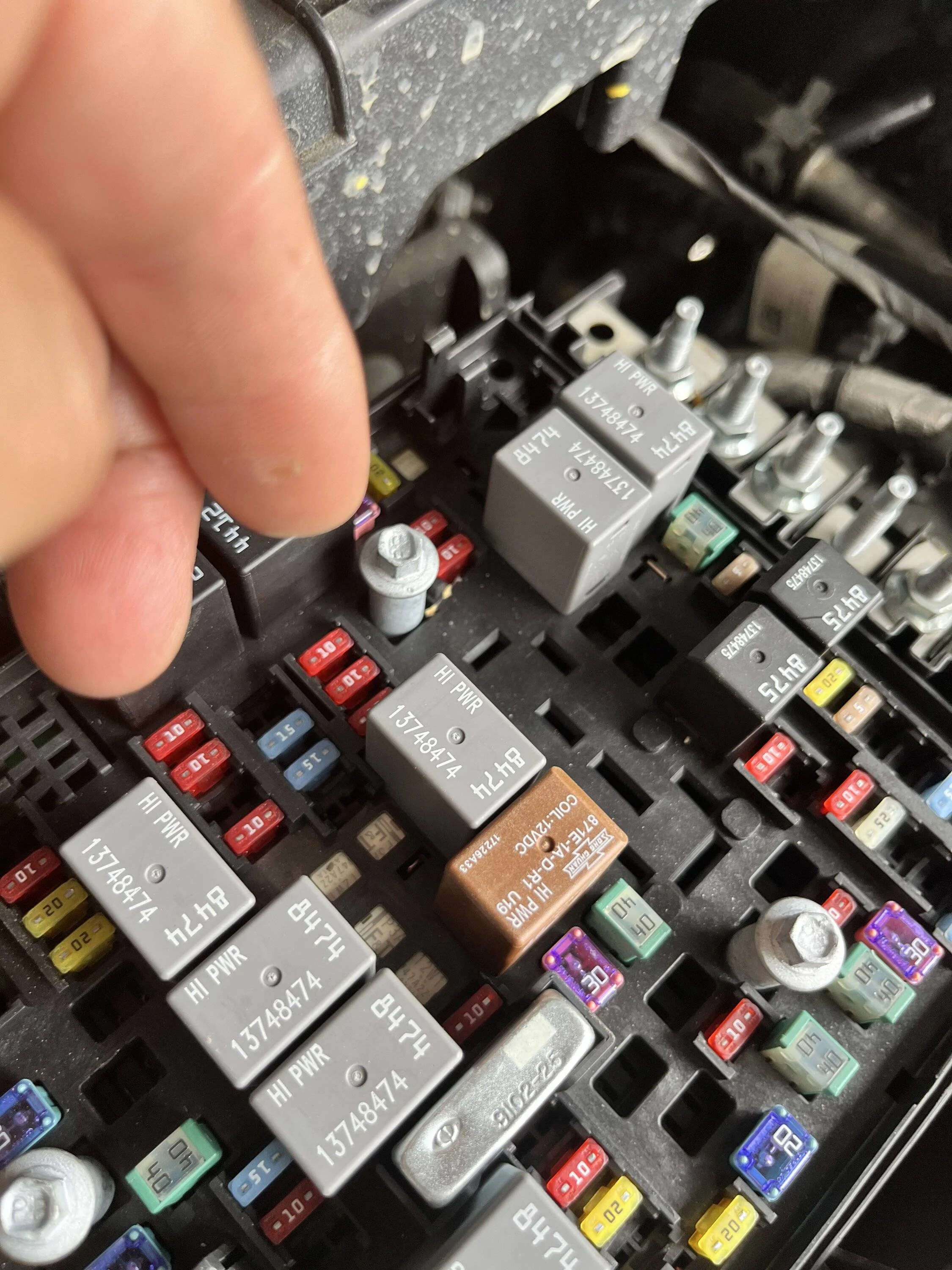

Okay so did just that removed fuse f42 and place in spare f49 spot took negative and only negative off main battery, overtaped with electrical tape. Check engine light is still on and on first start up I was back to shifter not get out of park all lights coming on etc, turned Jeep off and everything was fine again but now engine light is back on. Should I disconnect the Positive as well on the Aux battery?
