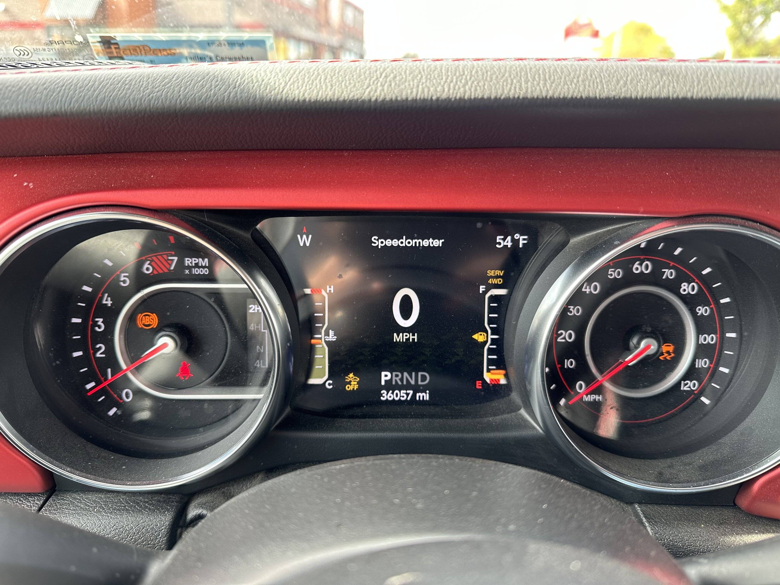

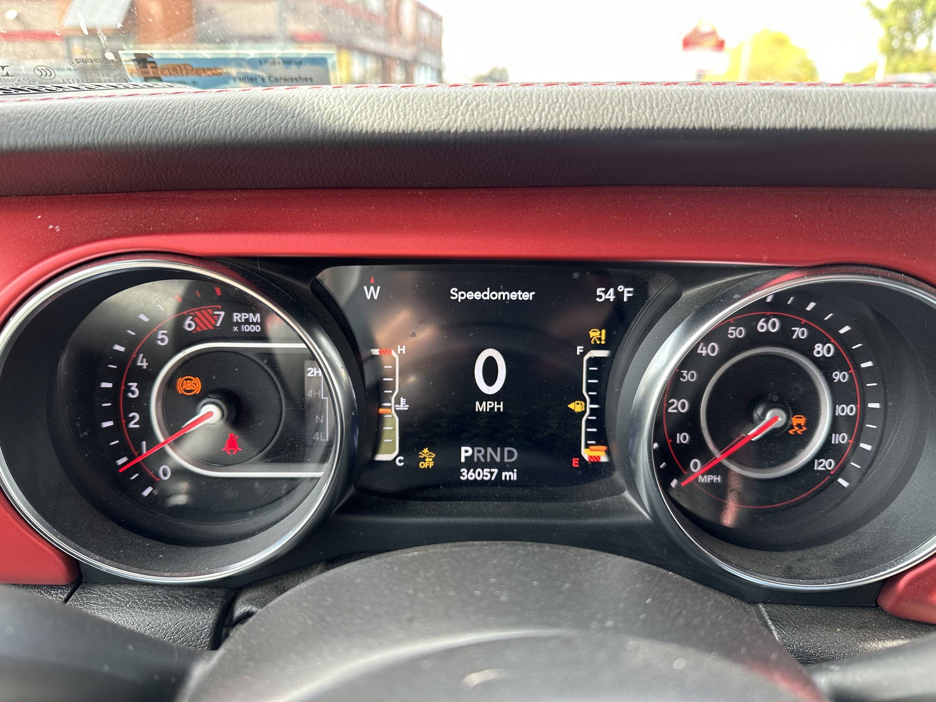

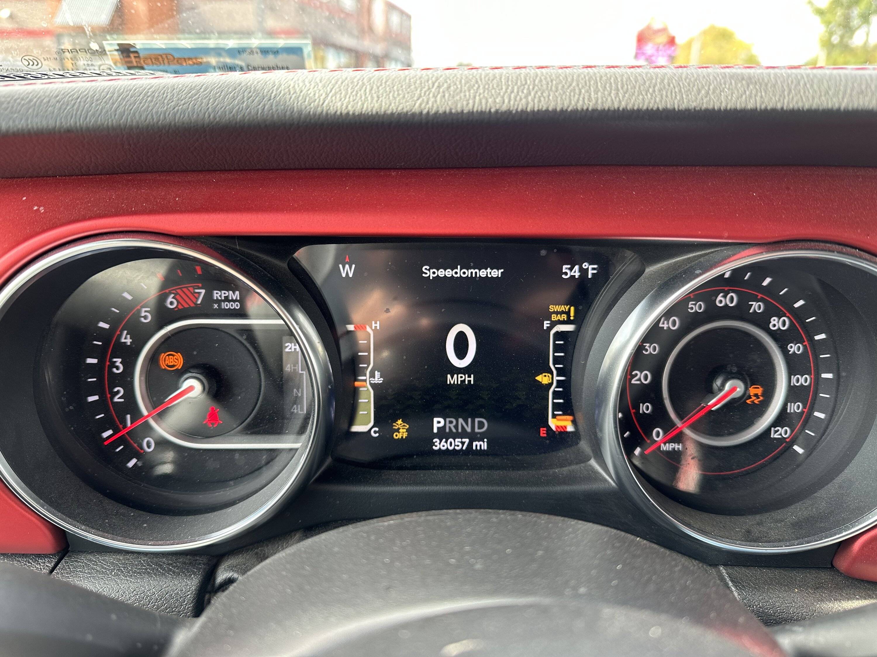

I hit a big pothole today and got all of these alerts at once. It’s cycles through these 3 different warnings above fuel gauge. Anybody see this before?

check to make sure the negative battery terminal is on snug, sometimes a loose ground can make dash lights do funny things

Wheel Speed Sensor maybe?
Easiest way is to get the codes pulled and go from there.

Or loose fuses that the bump jolted out of contact.

I know what's wrong with it! There ain't no gas in it!
But seriously...
The pothole probably rattled a wheel speed sensor (or connector to a wheel speed sensor) and disrupted the signal. That's all things that display when wheel sensors go out. I've had that happen on a very washboarded road and it went away after the Jeep was shut off for a couple hours, never to happen again.
