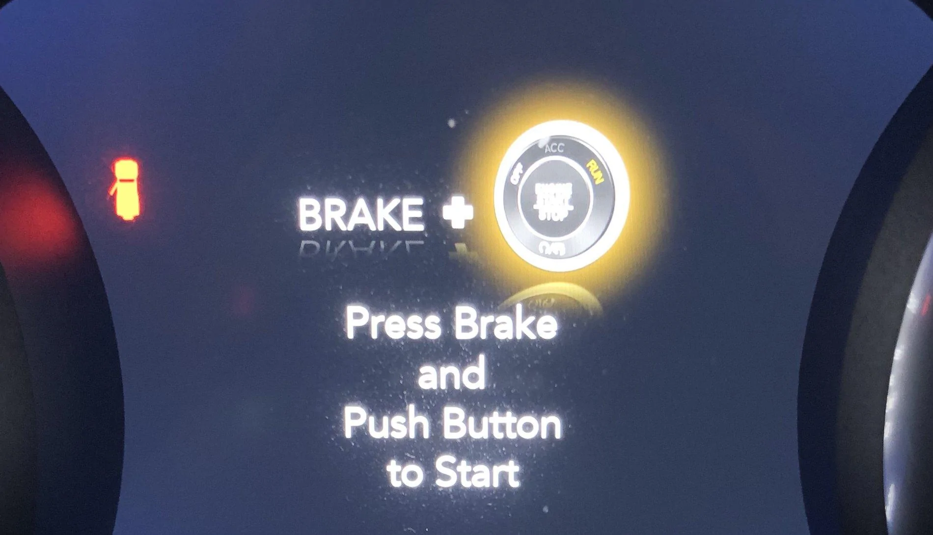

Here is a pic of the message I had that minus the run status it normally goes out normally within a minute or two after shutting off and closing all the doors, I have not timed it to see how long it takes to go out but it seems to vary in time so maybe it’s just a bug but when it stayed on today for like 40 mins had me a tad concerned but it’s only done it once

Dont leave your fob in the car. It thinks you just got in and will be starting the motor. It will also drain your batty eventually. Fobs should be in your pocket.
Really, So if I leave the fob in the Jeep is bad even if I keep it in the garage ?
