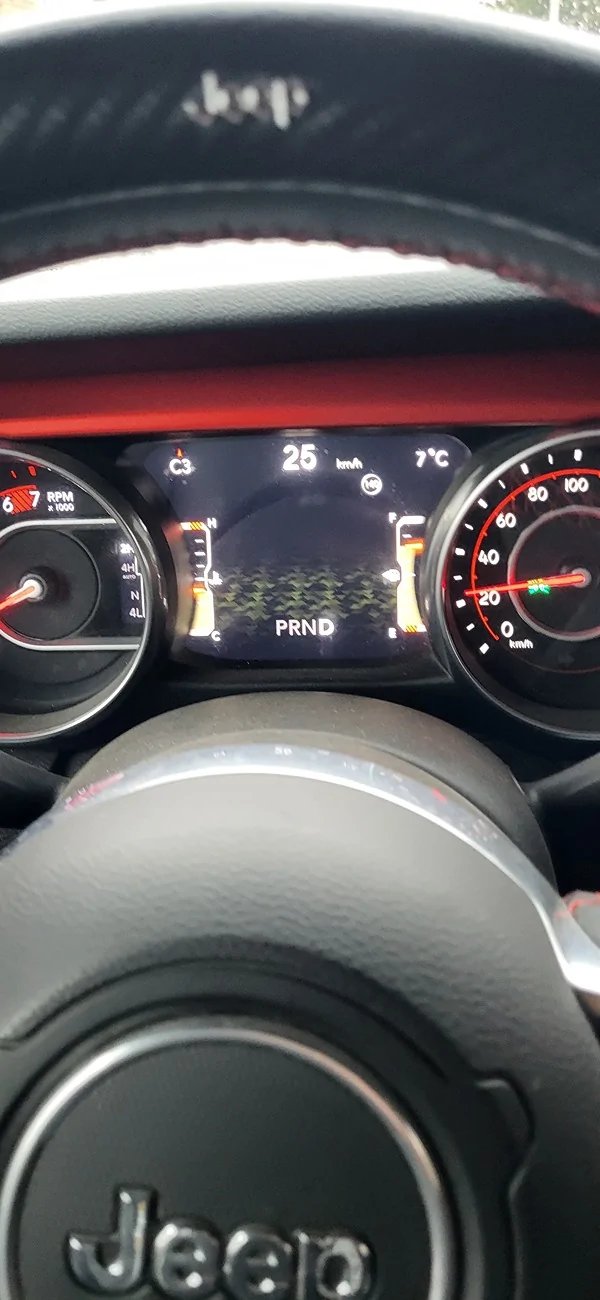

Good afternoon. help me determine the cause of this condition

the menu is empty.
My problem is not permanent.

It's not the battery or fuses. Mine does this occasionally, usually cycling through menu restores it. Never permanent. A quirk of the older models, I think. Mine is a 2018. There's a TSB to update the display, but I never cared enough to get it done since it's a very minor issue. There are other weird things like displaying 800F and 99999999 on the odometer. I believe the problem occurs at startup when the display gets erroneous data via the CANBUS.

I’ve seen these issues discussed on this forum before but personally, if it’s still under warranty I would take it to your dealer to have it fixed. That way, the problem/fix will be documented. Good luck and happy Jeeping!
