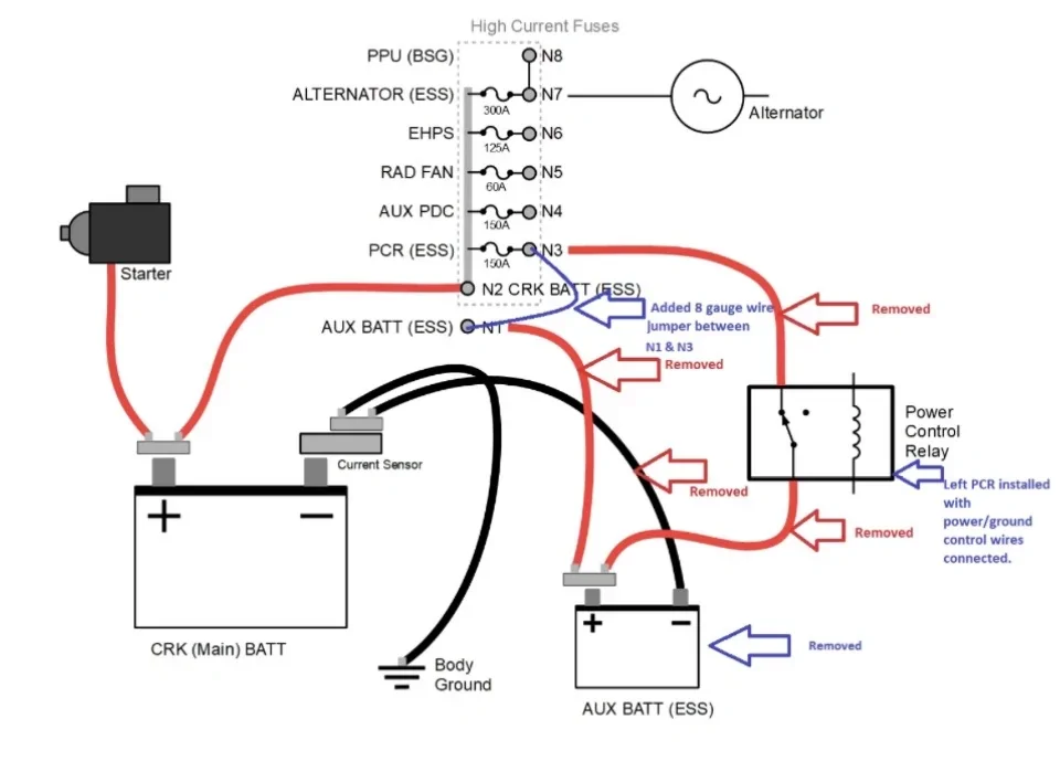

I can't take credit for this, but I found this visual reference floating around online (I think the JT forum maybe) and it helped me knock my Auxillary battery delete out in no time, so wanted to post it up here. Use this as a reference if you want to truely eliminate all the wiring and everything else involved with the aux battery delete. The wires removed work great as the jumper wire for N1 to N3.

Great find, thanks for posting this! Did mine recently, pulled F42 fuse, removed ESS battery, wrapped up cable ends and put back in box...done. Wanted to remove the secondary battery positive and negative cables but couldn't really see where they were routed to and was short on time. This is now on my list.
The added 8 gauge wire between N3 and NT (Aux Battery ESS) is necessary because of the positive wires you removed, this completes the circuit as Jeep originally intended. Not sure what this wire is needed for?
Also, I'm assuming you unwrapped and the re-wrapped with battery cables with same type Jeep black cloth tape?
EDIT: Wonder if Jeep or some other company makes a nice plated stamped copper bit to bolt between N1 and N3 connections?
Yeah I think just one piece of that tape needed put back on. I was pretty deliberate and strategic with my razor blade cuts to minimize lost harness wrap. Everything else came out with the unneeded wires. I pulled the fuse box and battery tray and intake box completely out of the way and it made things way easier. The n1-n3 jumper was required to complete the positive side circuit that was removed. I tried without it and had no power to anything.

Generally, one battery wipes out the other, causing annoying warnings on the dash and having to spend money on two batteries versus one when replacing. The stop start function can still work just fine on the single large battery, if you set yours up like the diagram I put on post 1, then you can still have stop start. Tested and verified this on mine, it'll just use the main battery to do it.
