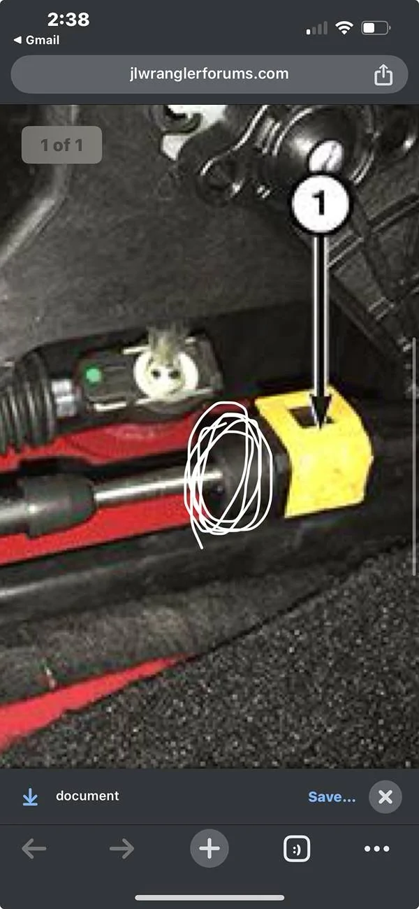

if I adjust my shifter the way it says to do so in these PDFs, I can barely get into first. What I do, instead, is, with the neutral gate cable (the one on the right side of the shifter with the yellow tab) unlocked, from neutral, I push the stick slightly to the right while watching the neutral gate cable until the green markings line up. This has resulted in, dare I say, the best shifting in my jeep since the ACT clutch.
I added a screenshot of where the green markings are in my neutral gate cable. Sorry but it is really hard to see on this photo but I can see it on my cables. I’m sure you’d be able to see it if you went in and adjusted them.
I wonder if maybe a detent in the transmission is broken or if the cables got kinked during the install because my shifter also feels really loose afterwards. Really need to figure this out but I really don’t wanna spend more money chasing after this issue.
