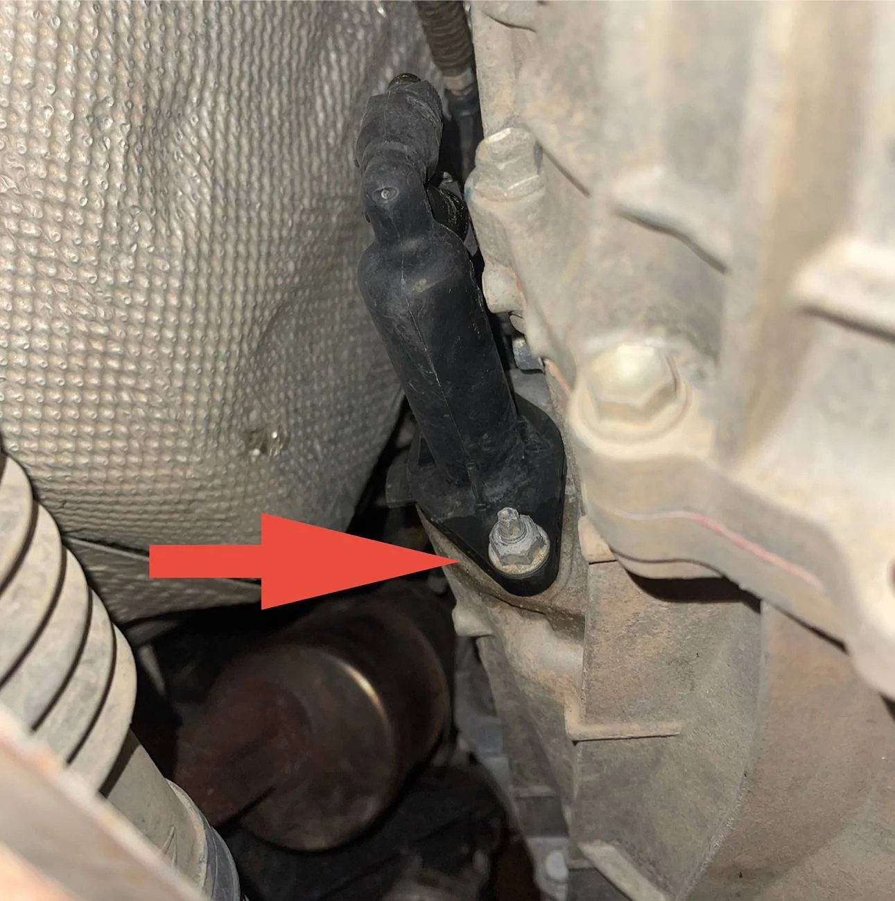

    • Residual oil around the slave cylinder (SC) flange and bellhousing. (see photo)

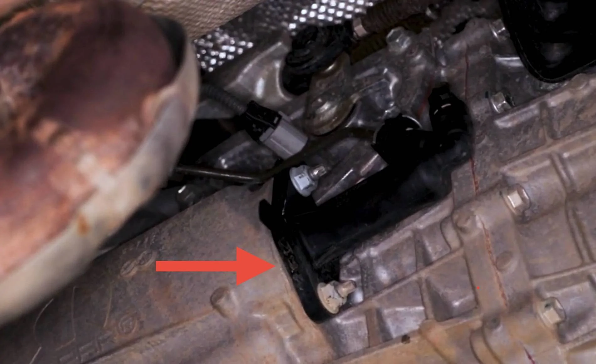

This indicates a potential leak causing incomplete clutch disengagement or retraction. Comparing this to their ACT Jeep Gladiator install video where they used my truck (see photo), the oil residue is a recent development after 30k miles of use (92k miles total operation).

(photo below shows oil residue on slave cylinder @92K miles on ODO)
Jeep Wrangler JL Help! Issues after ACT Clutch install. slave cylinder
(photo below shows NO residue at the time of ACT install April 2023 @62K miles)
Jeep Wrangler JL Help! Issues after ACT Clutch install. slave cylinder at act
