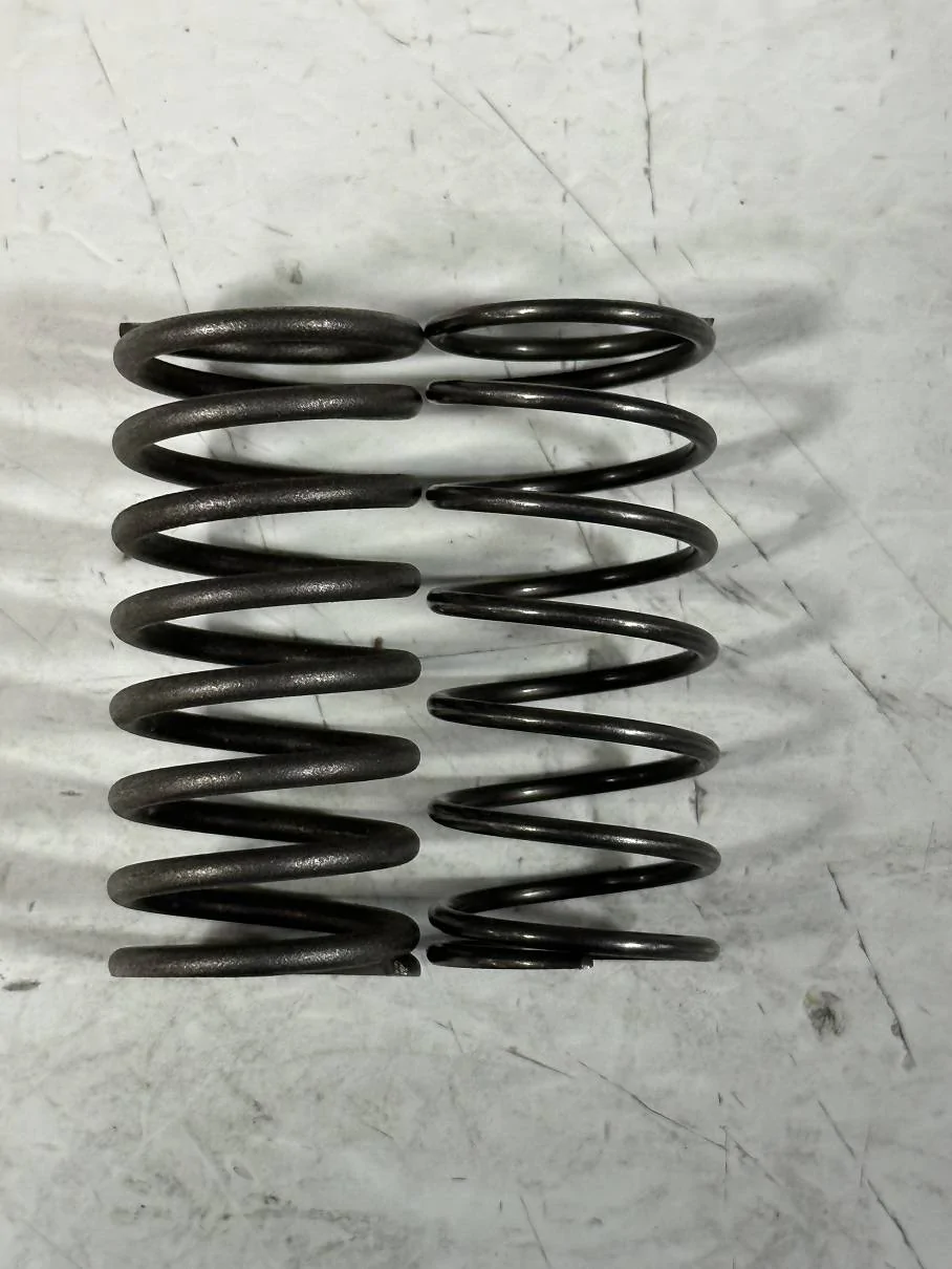

I ended up removing my ACT JL clutch spring, it was about 1/4" short and I believe around 3K RPM would cause an annoying intermittent rattling sound when my foot was off the clutch. Anyone else experience this? I put the OEM back in and no longer getting that sound. The spring is thinner and has less tension but should not be shorter. I would try again if ACT made a version 2.0 of that spring.

How long ago did you install the ACT spring? I installed mine in May and haven't noticed any rattling. When I first got it and compared it to the original, I could see they were the same length and diameter, just made of different wire thicknesses.

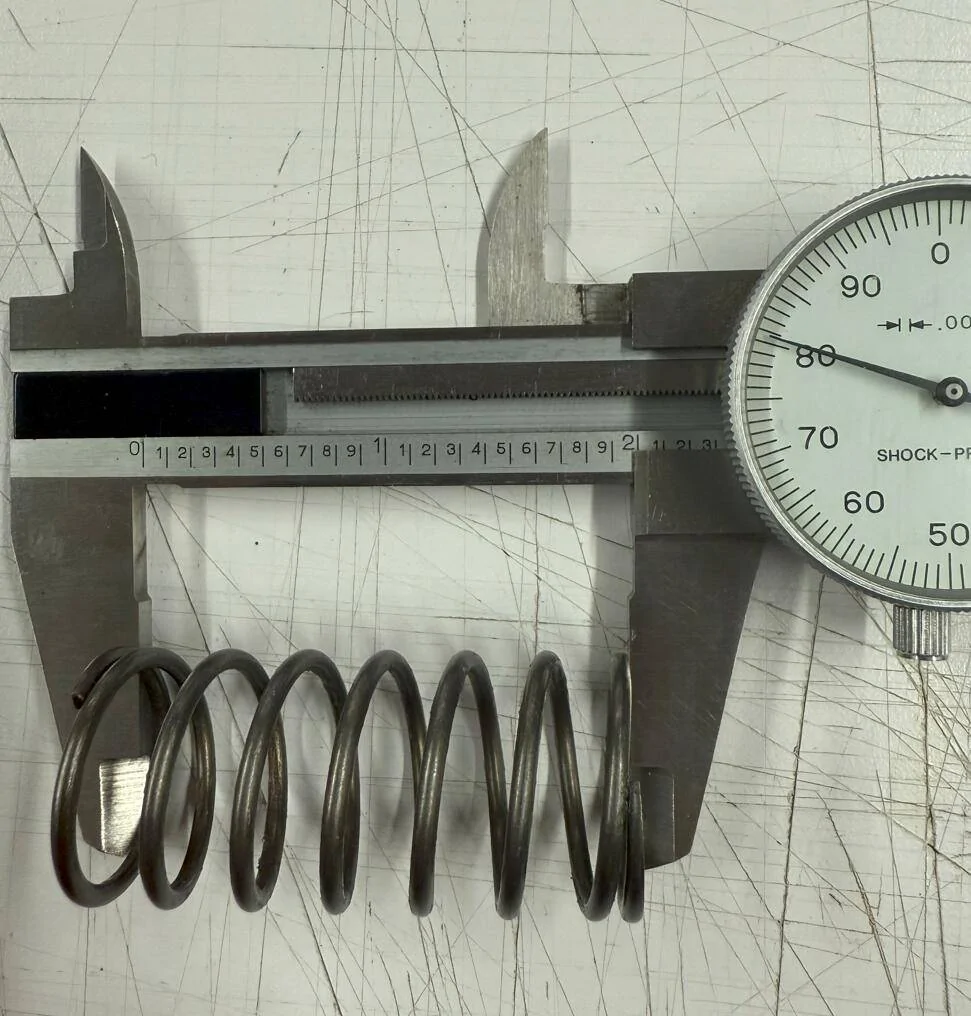

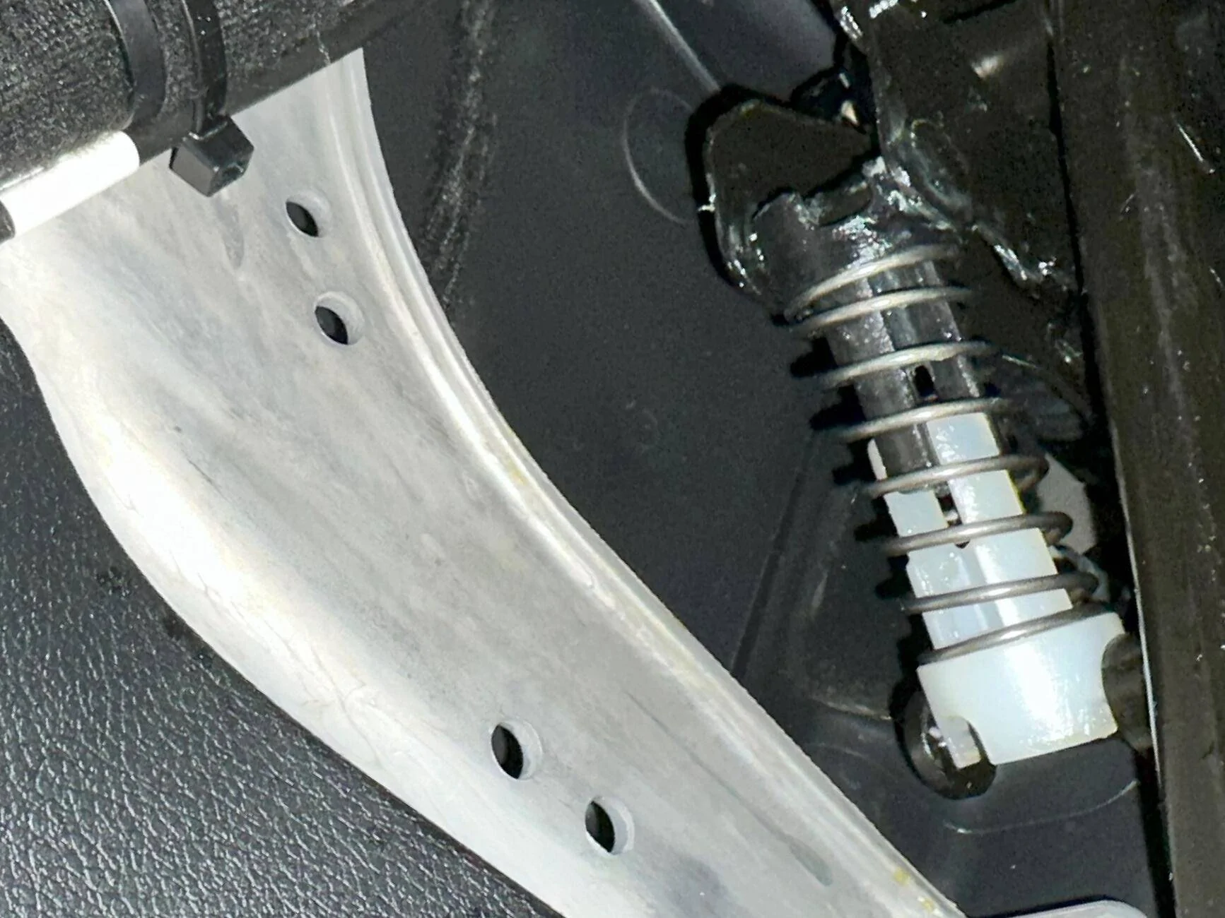

I purchased and installed the ACT compression spring 10/2023 so just over a year. My version was about 1/4" shorter than the OEM it replaced. There was a small amount of slop.
The measurement photo #2 (despite the angle) is not applying any pressure to the spring - at all. It's the iPhone camera causing the distortion.

Thanks for the good info. I'm glad I held onto the original spring. I suppose I'll be putting it back in 6 months.

Hopefully not, I noticed a big difference going back to the OEM spring, clutch is now very light, and I had to "relearn" the clutch again - took a few drives. It seems all manual transmission are slightly different with their quirks and such. Hopefully it's just that mine vibrates or is not balanced as well as yours and you never see this issue. I do prefer the ACT spring, just needed to get rid of the rattling.
