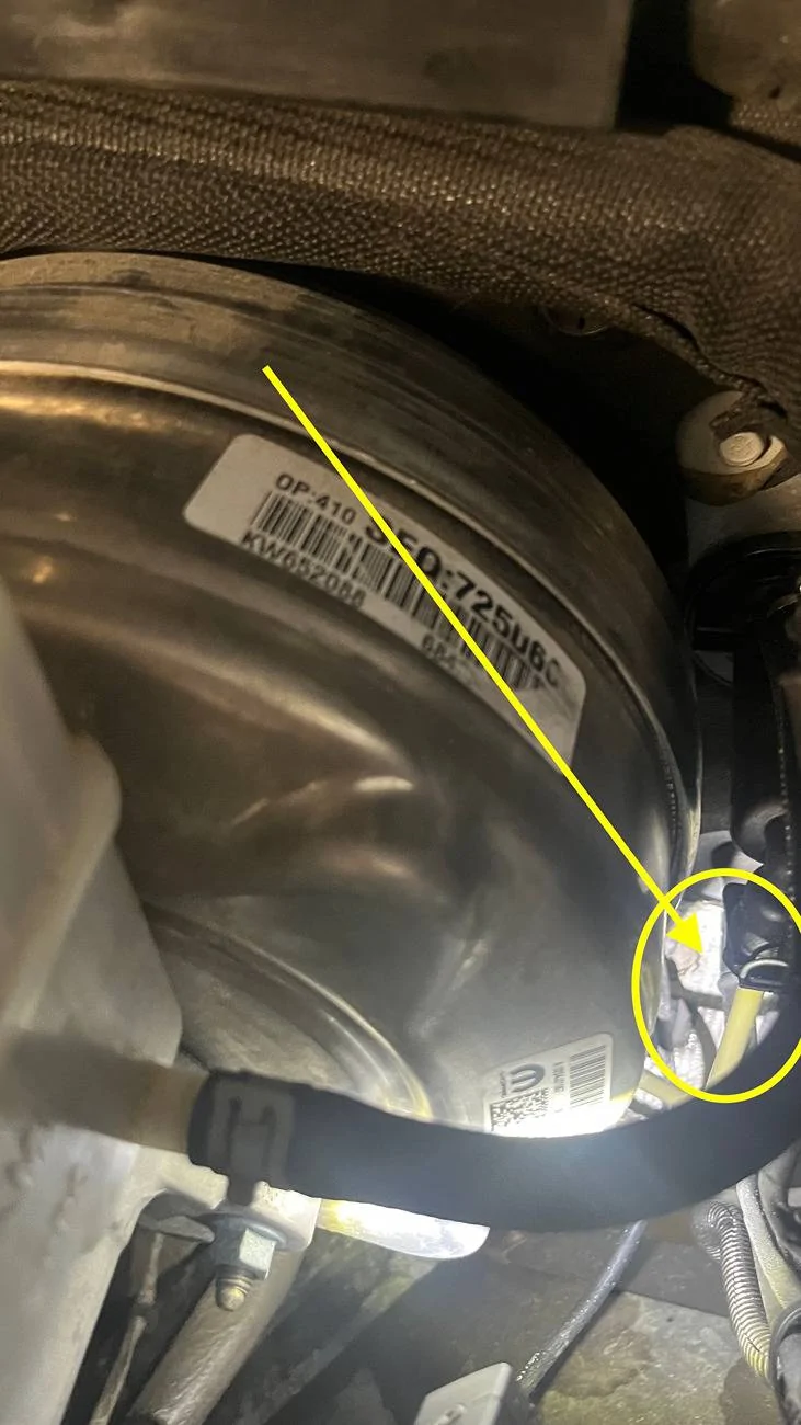

Ok reporting back in..... I drove it out to Malibu and back (around 80 miles). First half of the drive was fine. Then every other time or so had issues going into 1st gear. By the time I made it home it's trash again. Locking up in 1st and reverse.
And again last night when I drove it I had no issues at all getting into 1st gear which is how my Jeep was driving before it at went to shit 2 weeks ago.
I got home and checked under the hood. Well, the spot where the master cylinder and hydraulic line connect looks wet again. I felt along the line and there were drips of brake fluid. So I don't think it was the master cylinder at all but maybe something is wrong with this connector on the hydraulic line?
If there's fluid coming out this has to be where the air is getting in. Then after driving around it gets all this air in there and it becomes difficult to shift again. That's my theory but if anyone has thoughts on this let me know.

Are you out of warranty? This could be argued that it’s covered under 5yr 60k drivetrain warranty. You shouldn’t be having to shell out money at an independent shop for this if the hydraulics are the real issue.
I'm out of warranty. I'm almost at 100k miles now.
Is that fitting "integrated" into the master or the line itself or a separate piece altogether?

It's in the line itself. @roaniecowpony just tracked one down in downtown LA. So tomorrow I'm off to downtown to pick it up and we'll start over again.
