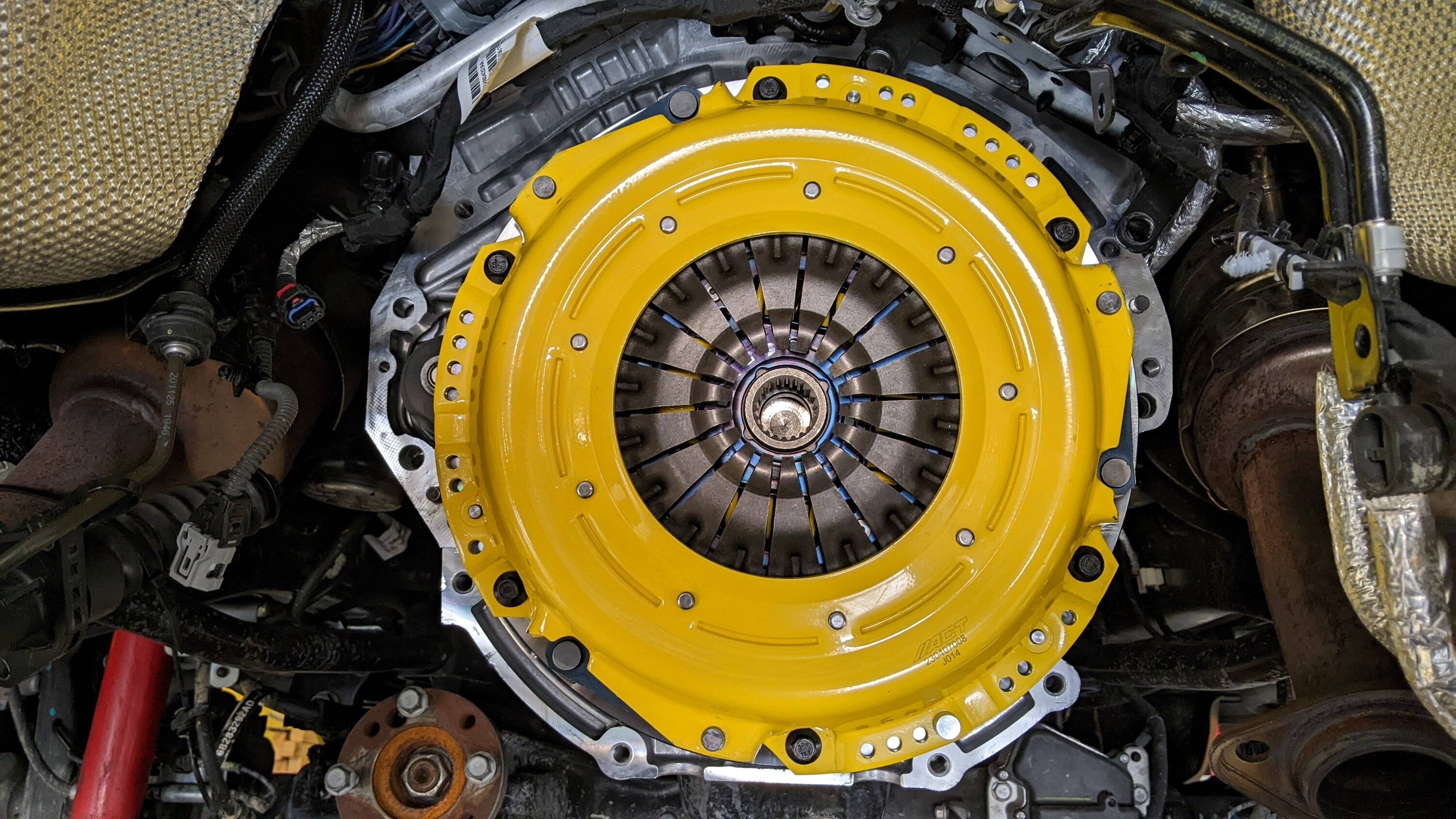

ACT JP6-HDSS-HD-O/Perf Street Sprung: pro-mass flywheel, 11" clutch disk, HD pressure plate, 479 Ft-Lb torque capacity, MSRP $1399.00

Review: The following was immediately noticeable after installation of the ACT JP6 kit:
- The clutch pedal itself is noticeably stiffer, but not too stiff. Holding the clutch pedal in at an extended traffic signal is no problem. I do not consider this a detriment.
- Clutch engagement is near the top of the pedal release and consistent every single time.
- There is no jerking or bucking in reverse, or any forward gears.
- There is no discernible gear noise from the JP6 clutch system when compared to the OEM clutch system.
- There is no discernible lag in engine rev speed with the JP6 "Pro-Mass" flywheel when compared to the OEM clutch system
- Being able to bypass any R&R of the hydraulics of the clutch system during installation is a major benefit of the ACT kit.
- My JP6 kit was complete, well packaged, and easy to install.

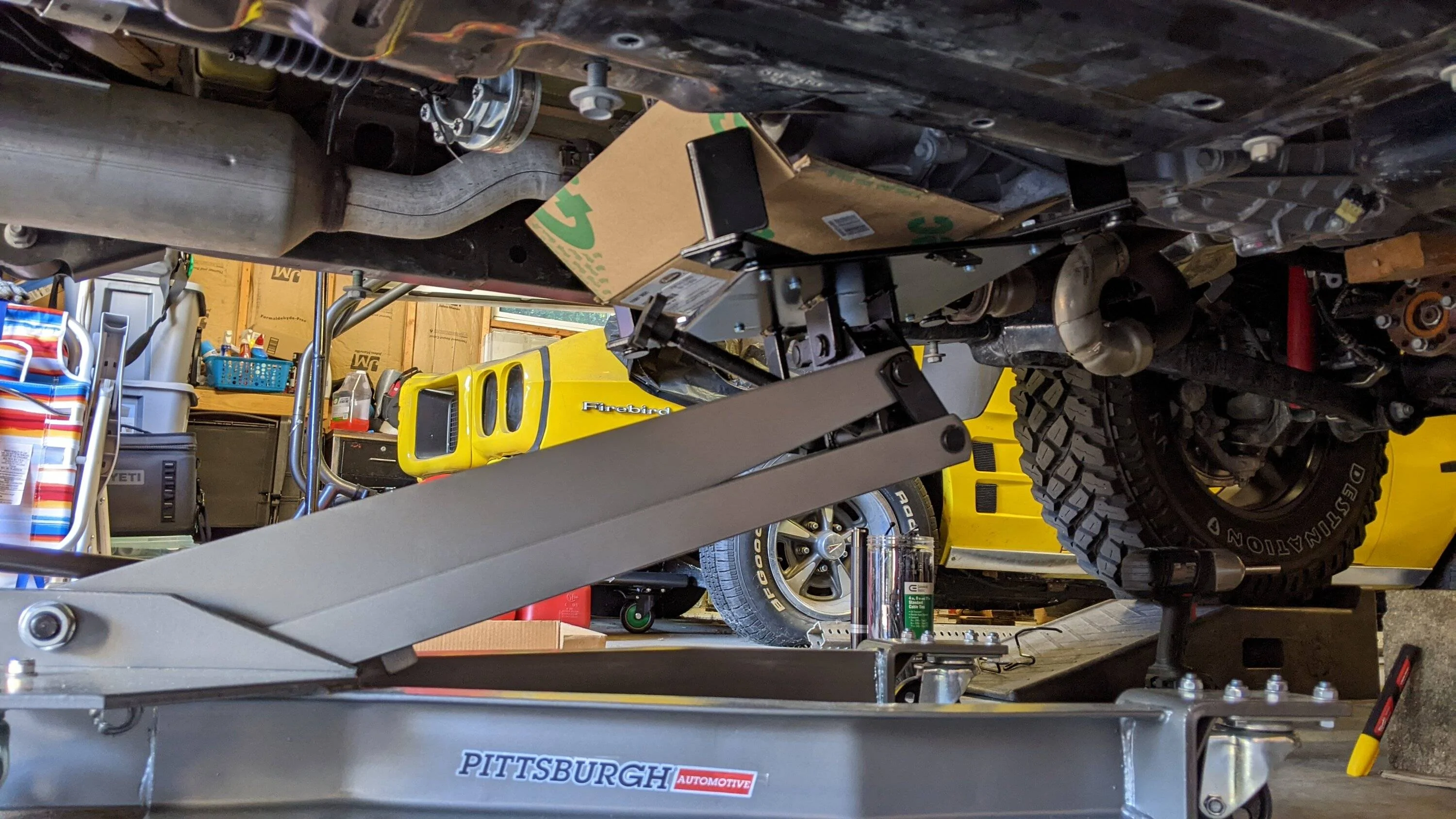

Anyone familiar with Motortrend's Roadkill will recognize my cardboard "list" which I created during disassembly in conjunction with ACT's installation video. The list made reassembly much more organized by being able to work backwards and not forget any bolts or connectors. Also pictured is the lucky recipient of an ACT JP6 clutch kit.

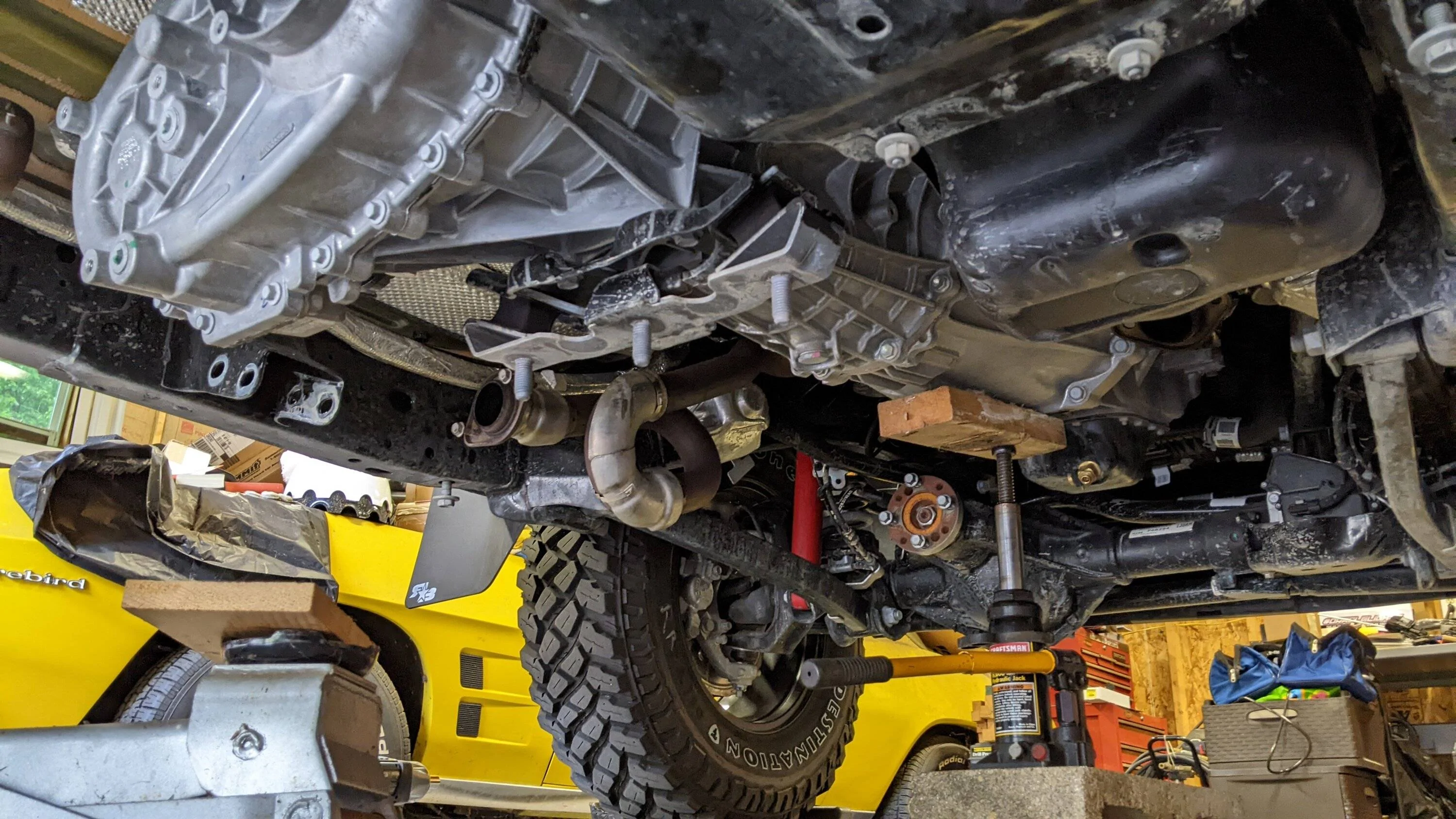

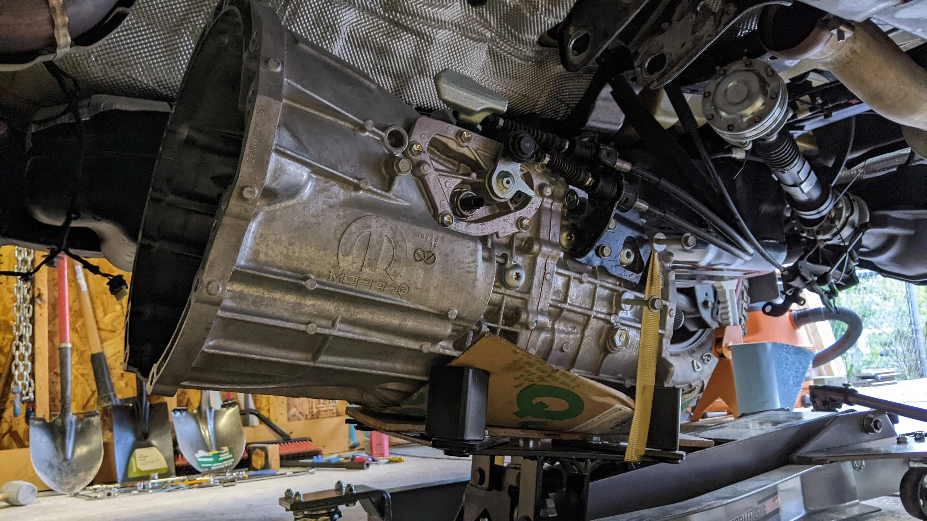

Jeep on ramps and jack stands is the best clearance I could get:

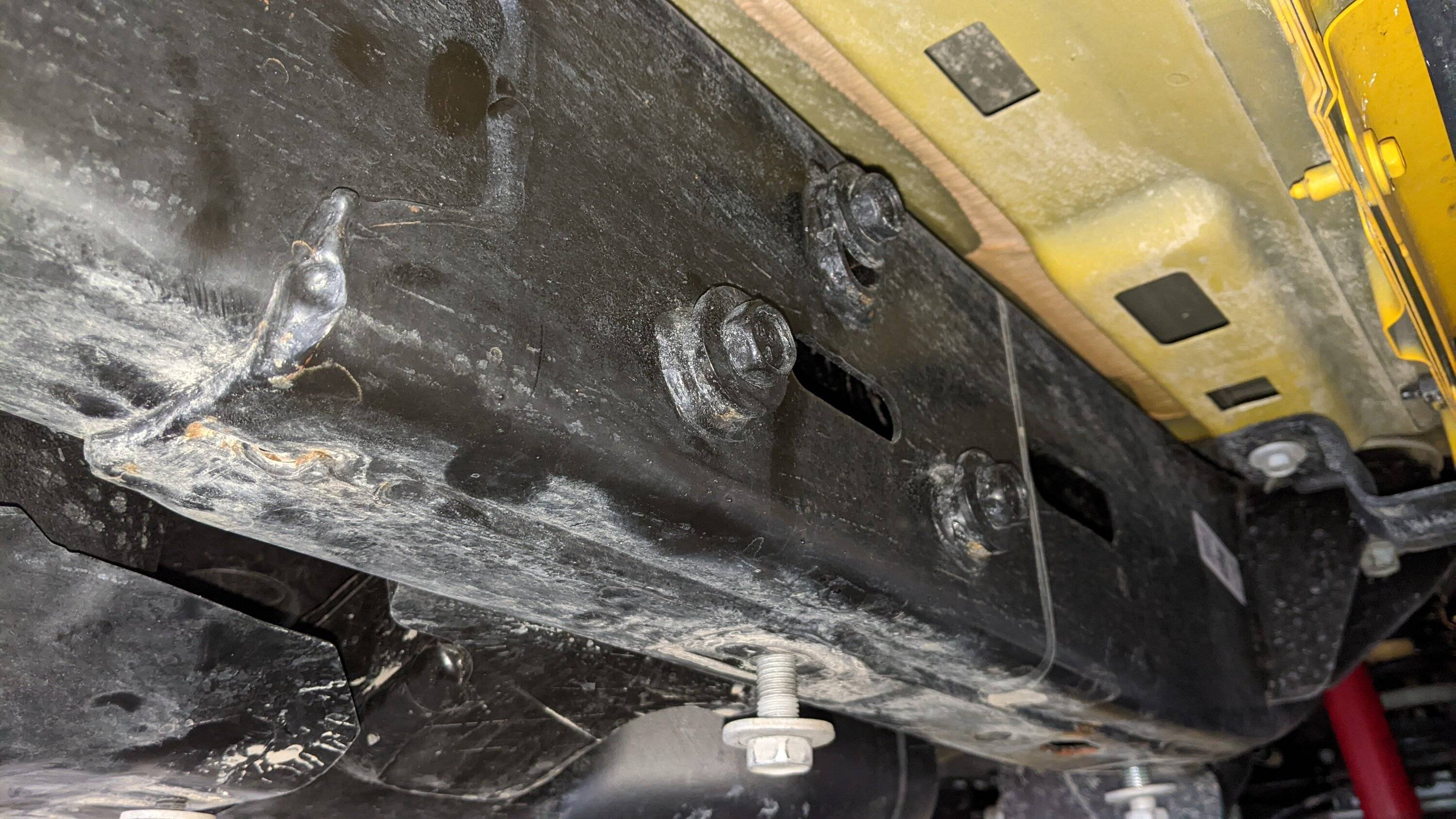

Remove Skid Plates with 18mm / 13 mm wrench or sockets

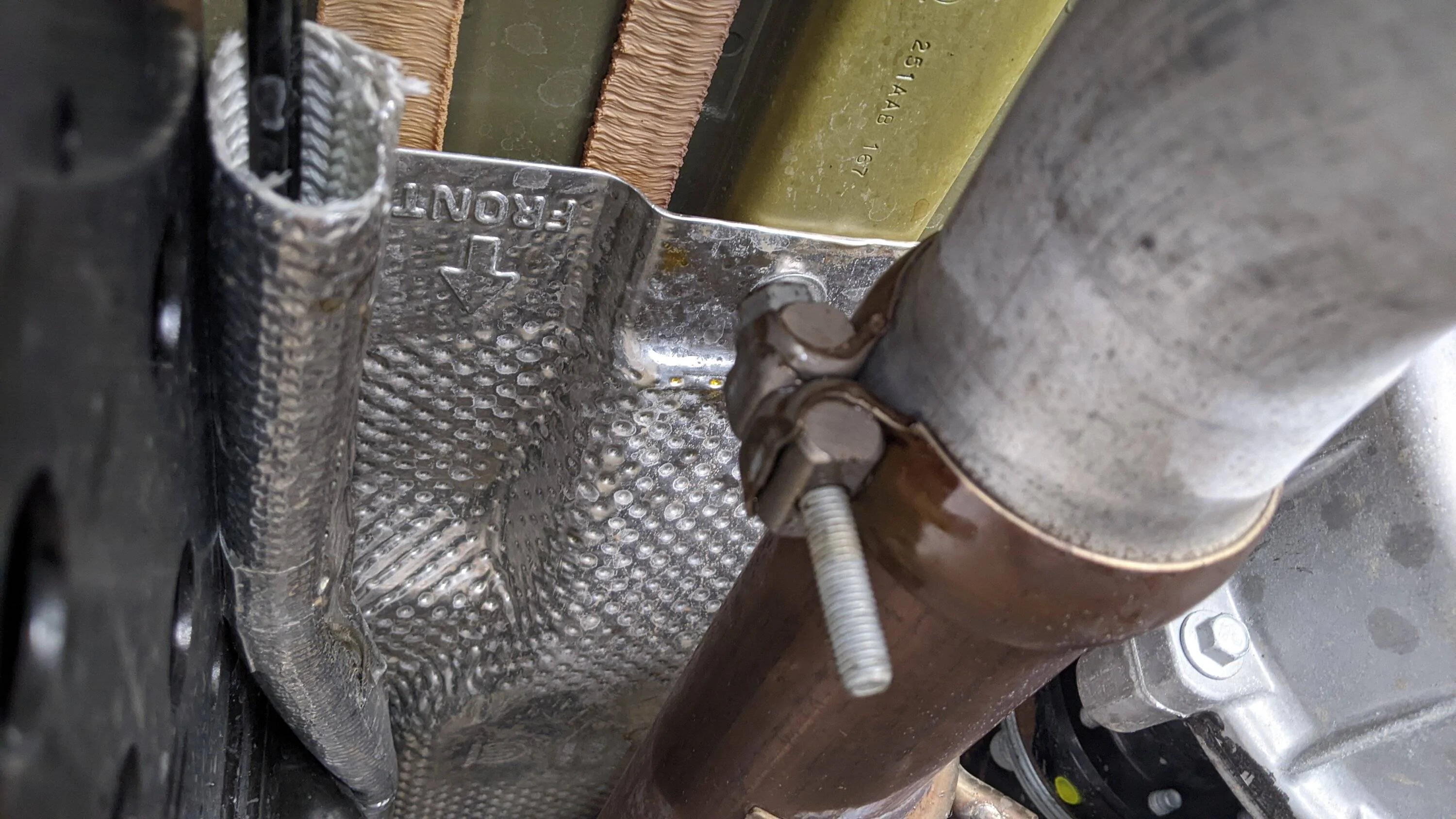

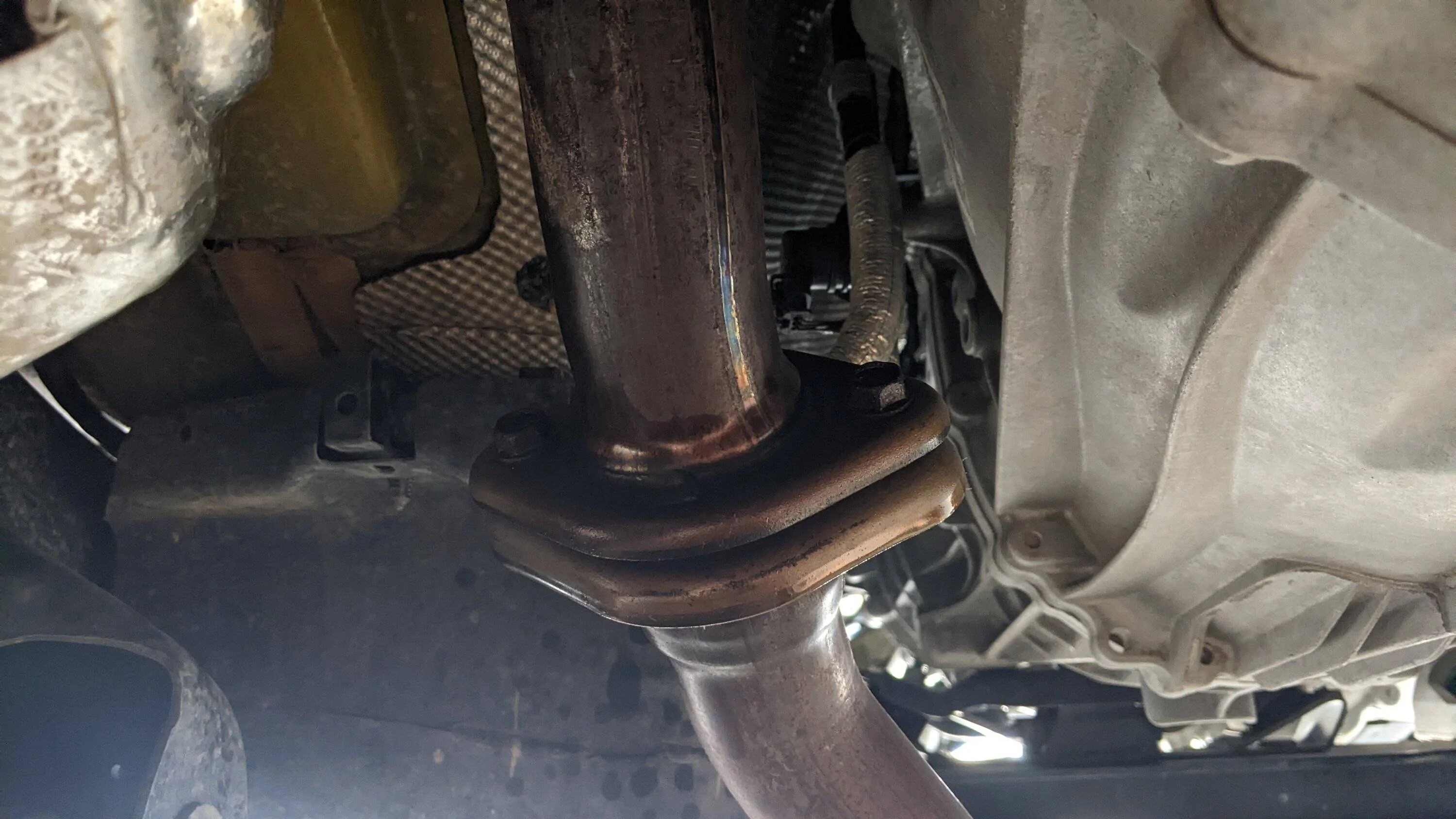

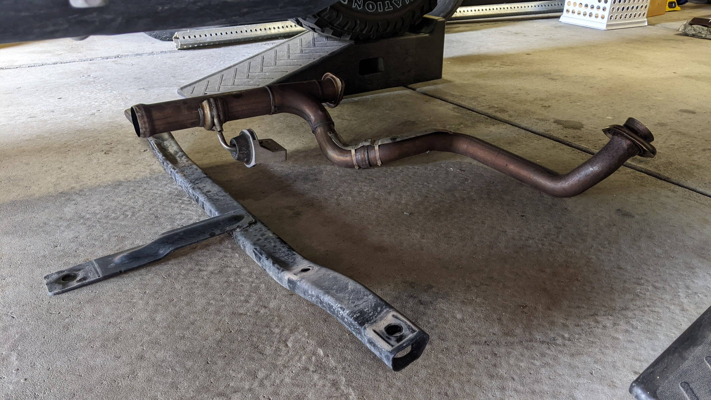

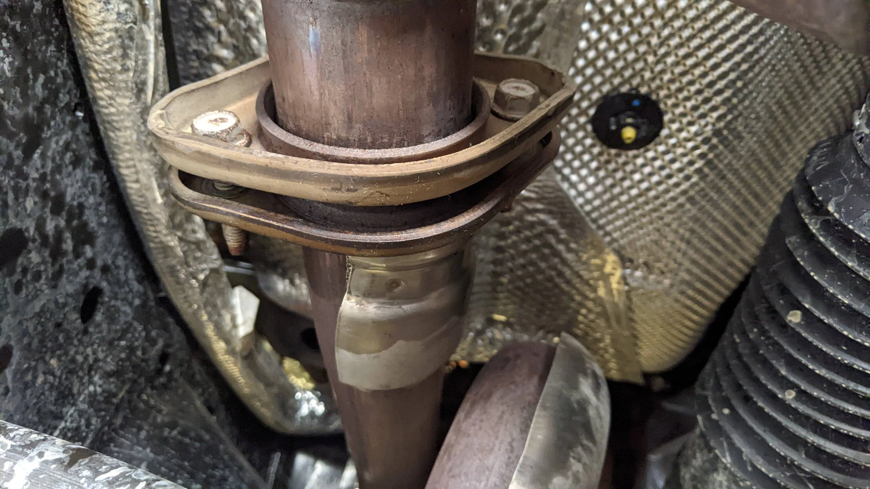

Remove driver/passenger exhaust clamps and isolator with 13 mm wrench or socket:

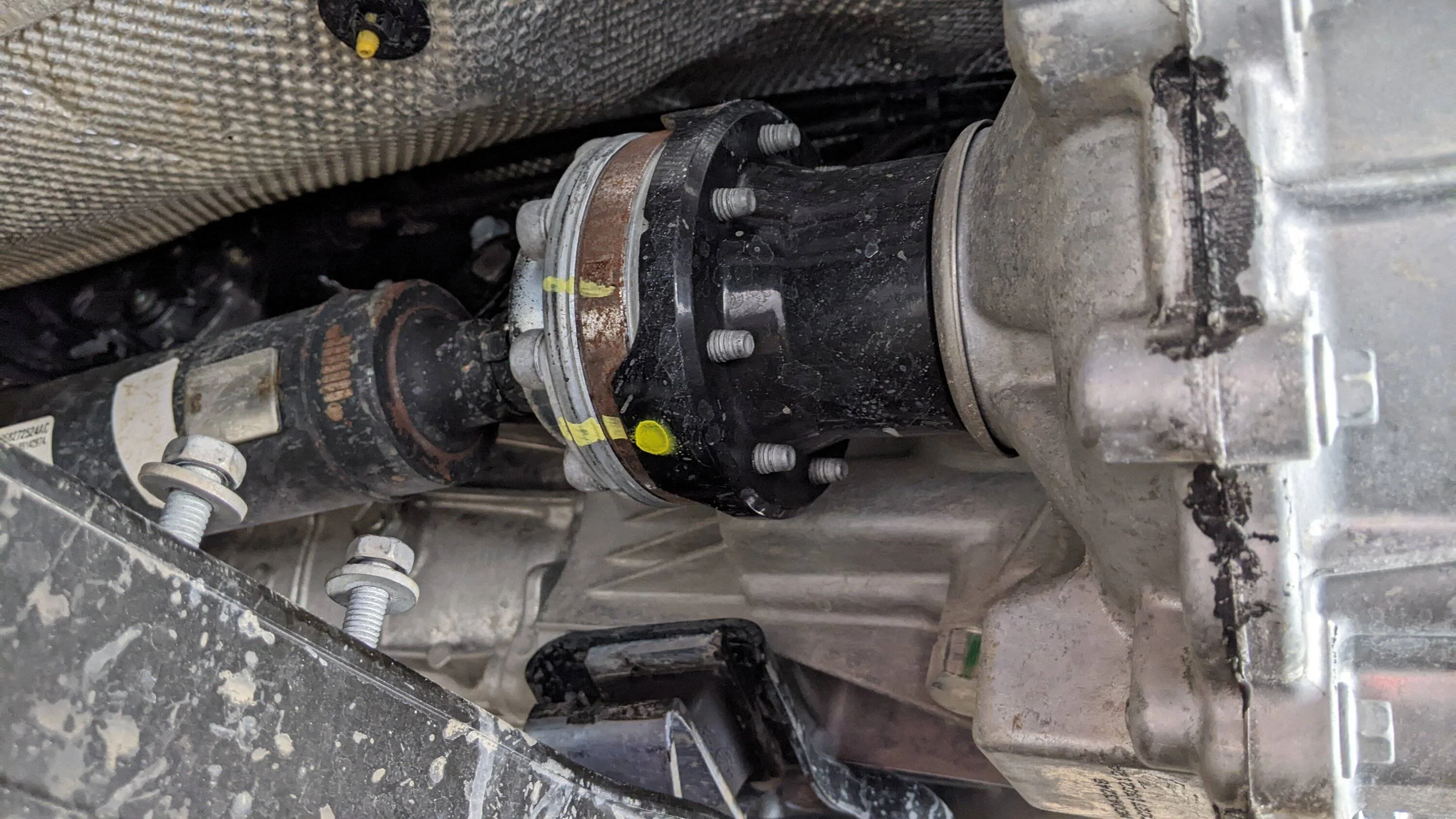

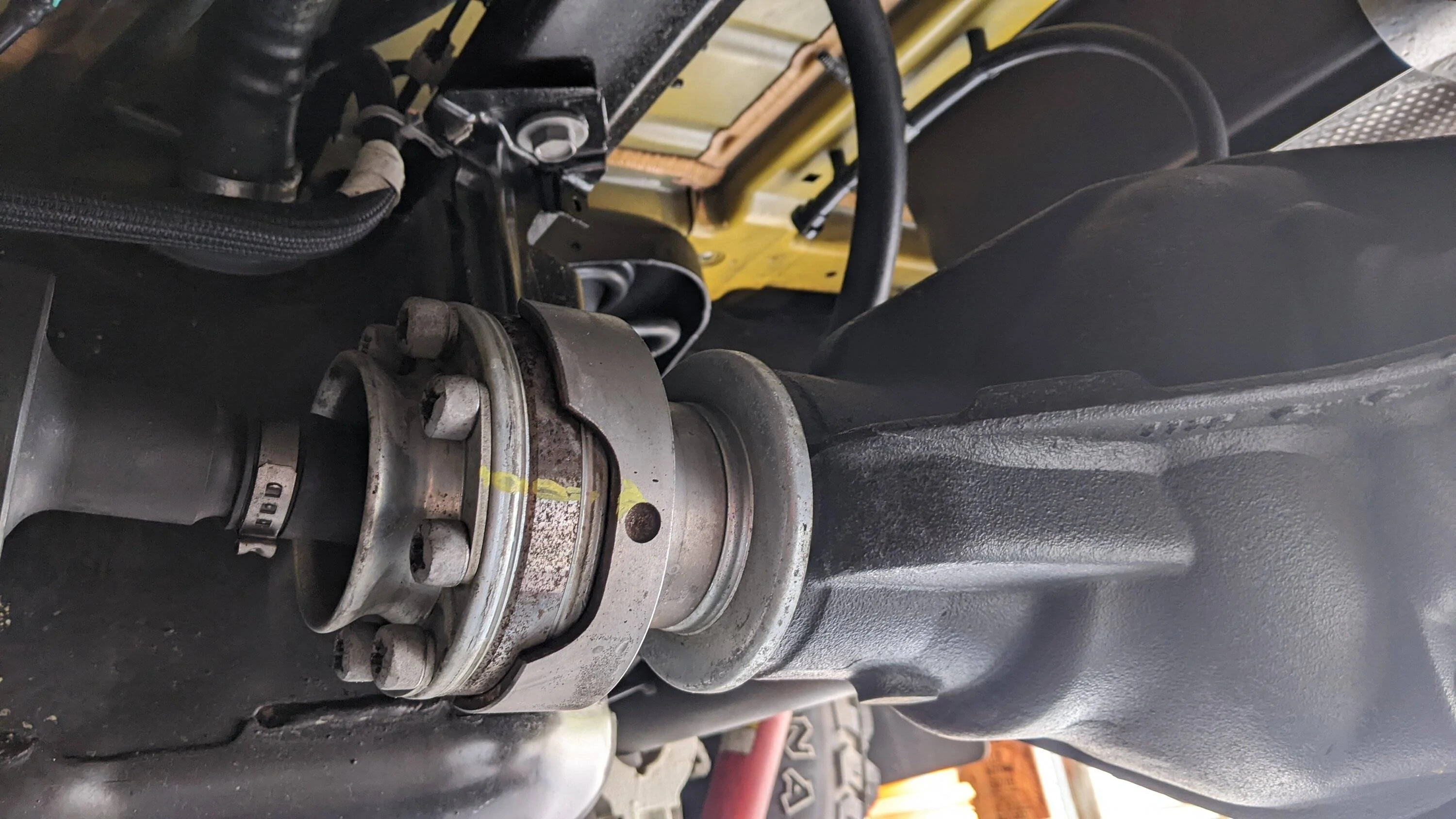

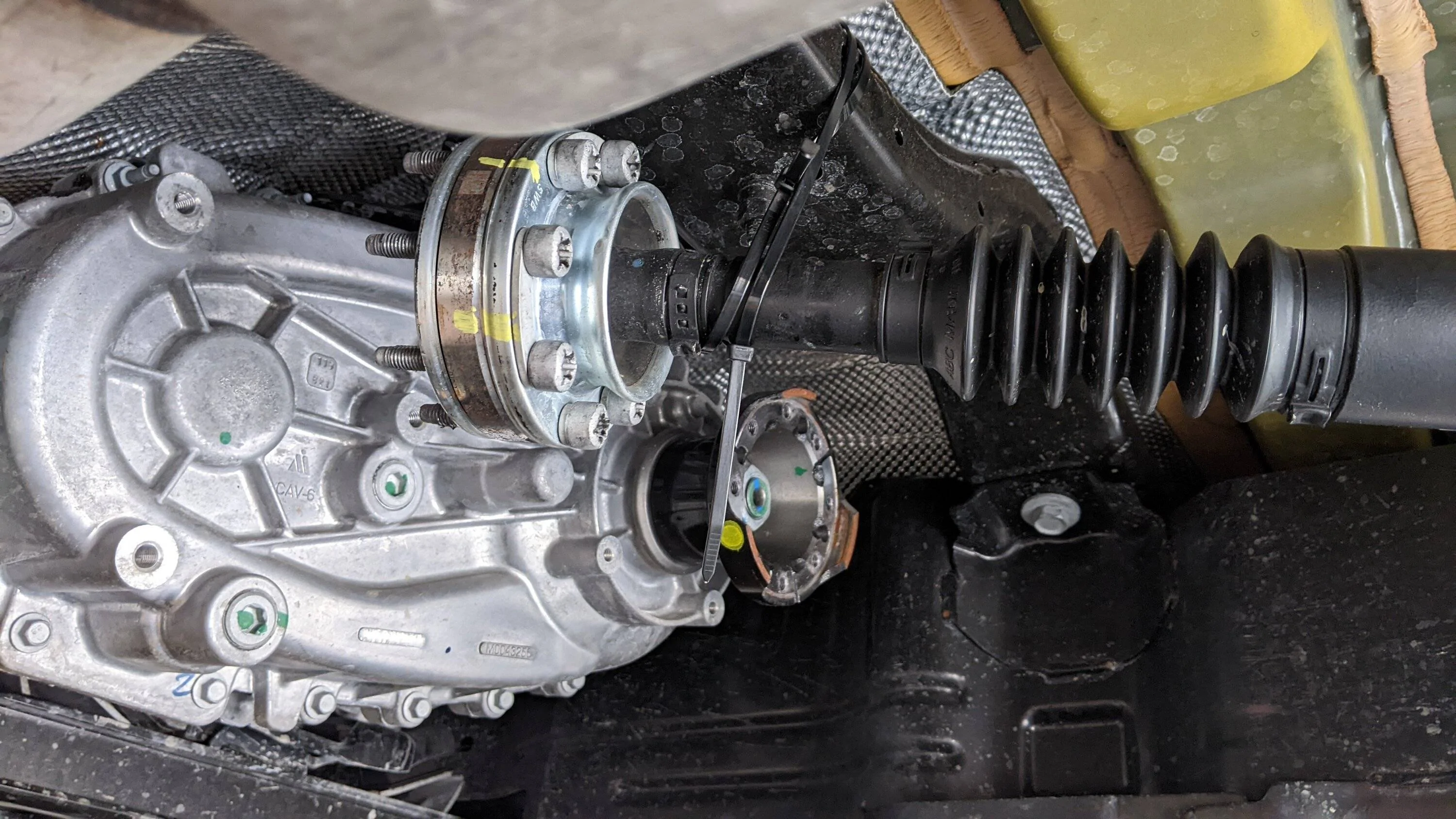

Remove rear driveshaft @ transfer case (zip tie out of the way and leave connected at rear axle) with T50. Remove front driveshaft completely with 15mm wrench or socket @ front axle and T50 at transfer case:

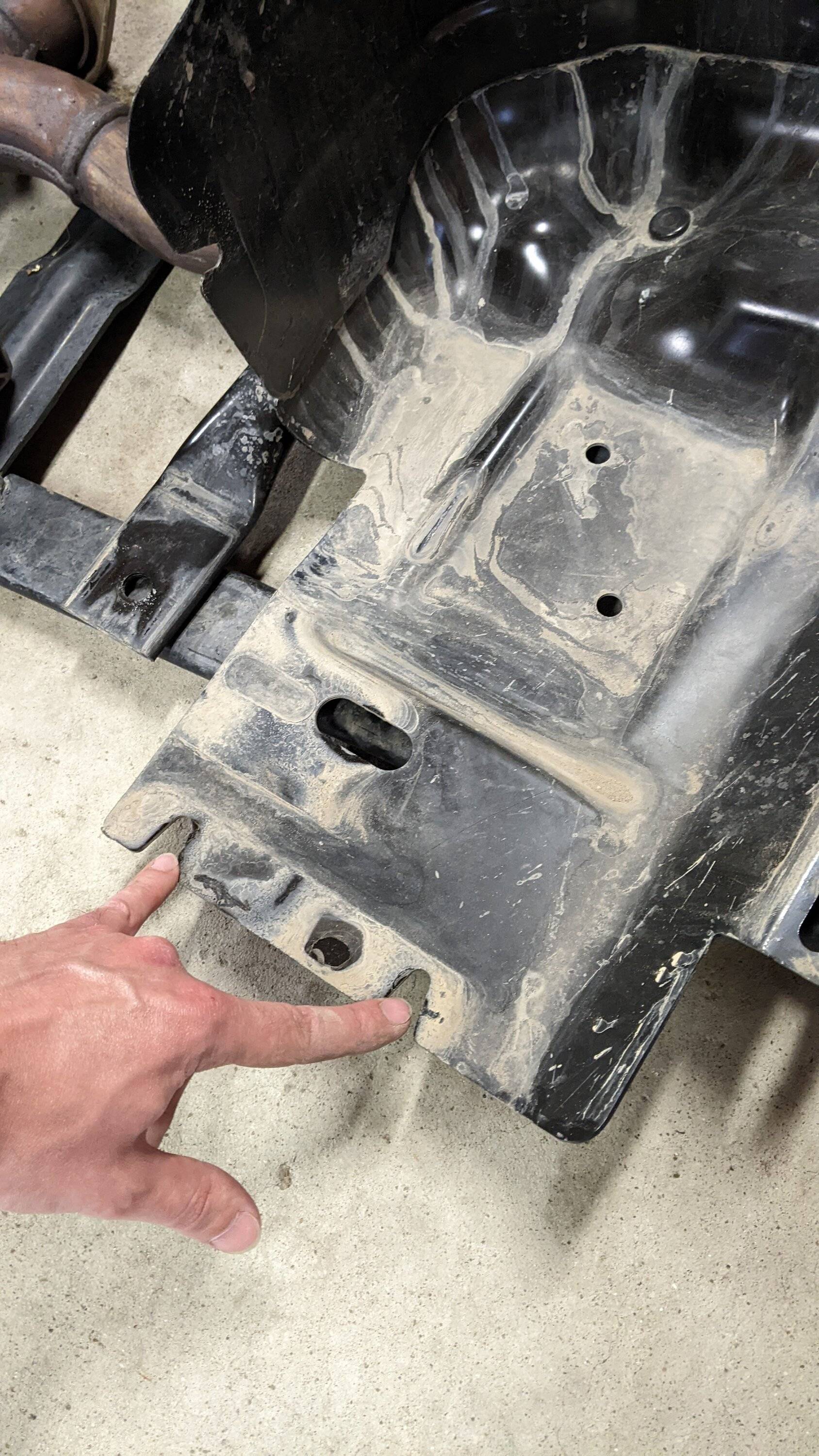

Remove fuel tank skid plates and hose clips with 18mm and 13mm wrench or sockets:

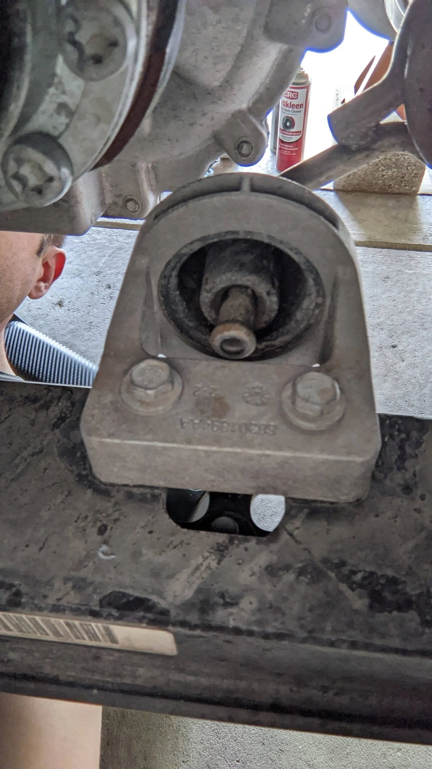

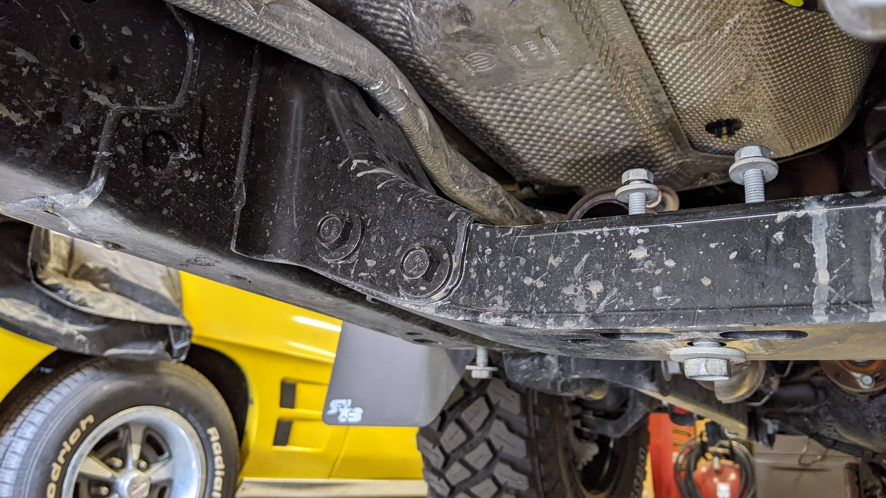

Remove transfer case to cross member mounts with 21mm wrench/socket and driver side and passenger side cross member bolts with 18mm wrench/socket and remove the transfer case cross member:
Remove transfer case to cross member mount with 16mm wrench/socket (Not Pictured)

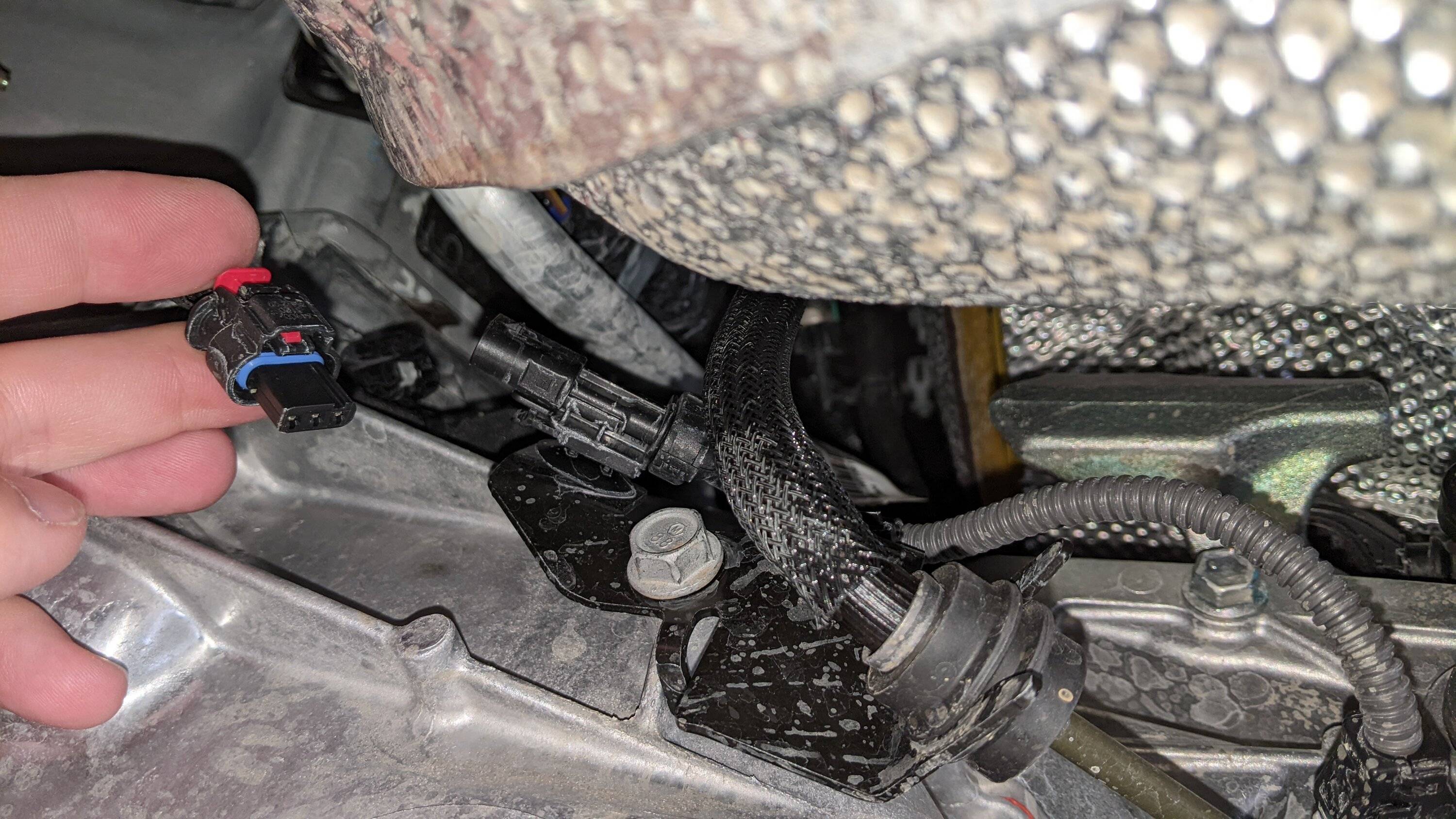

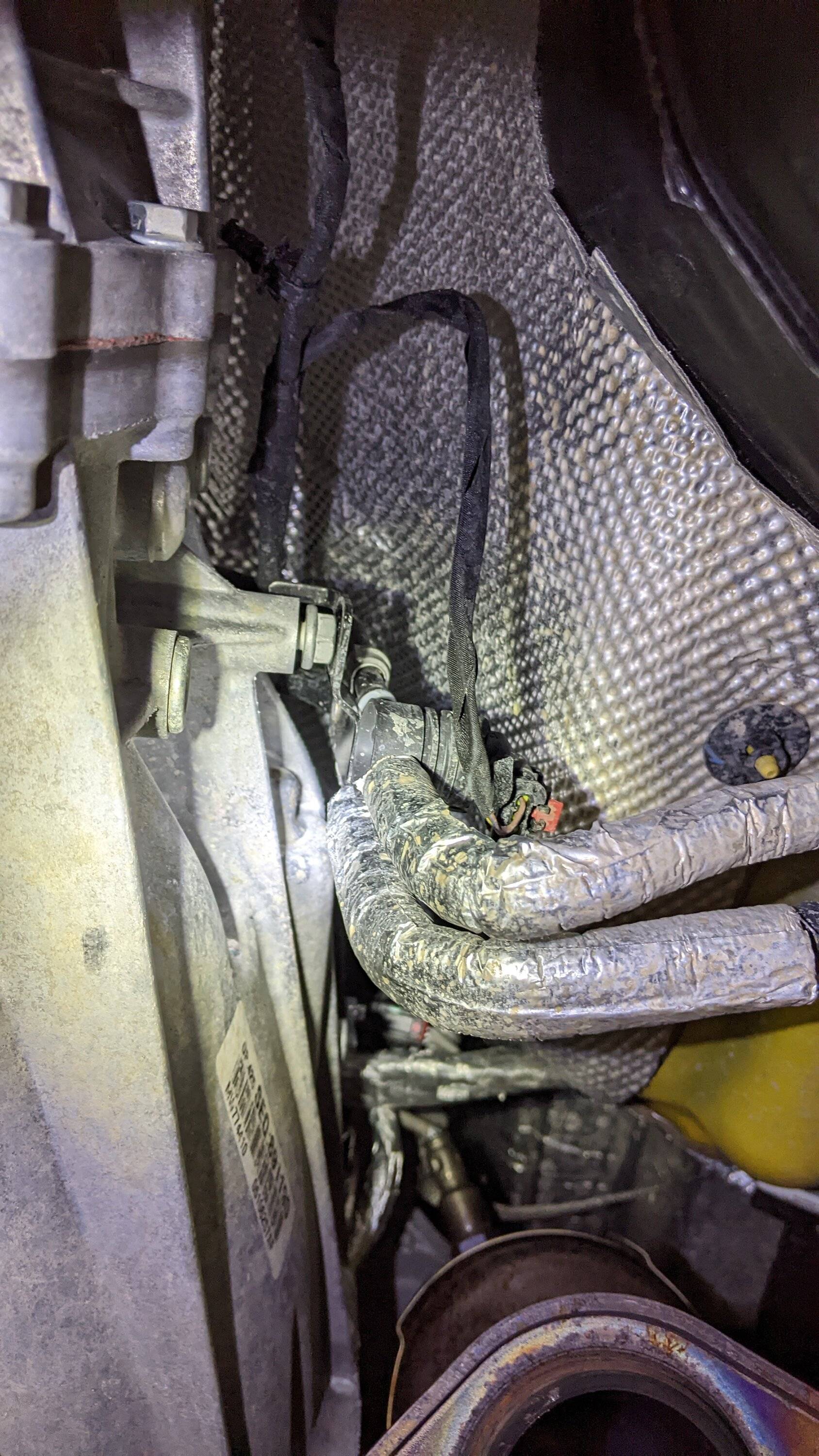

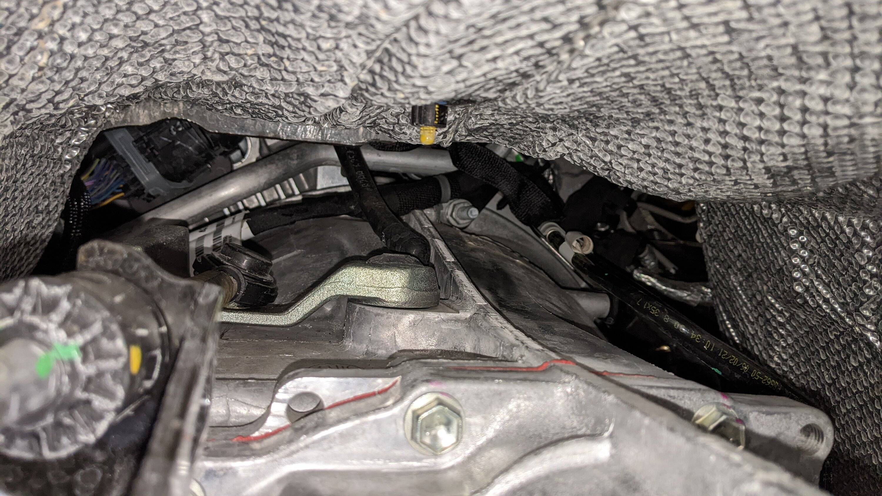

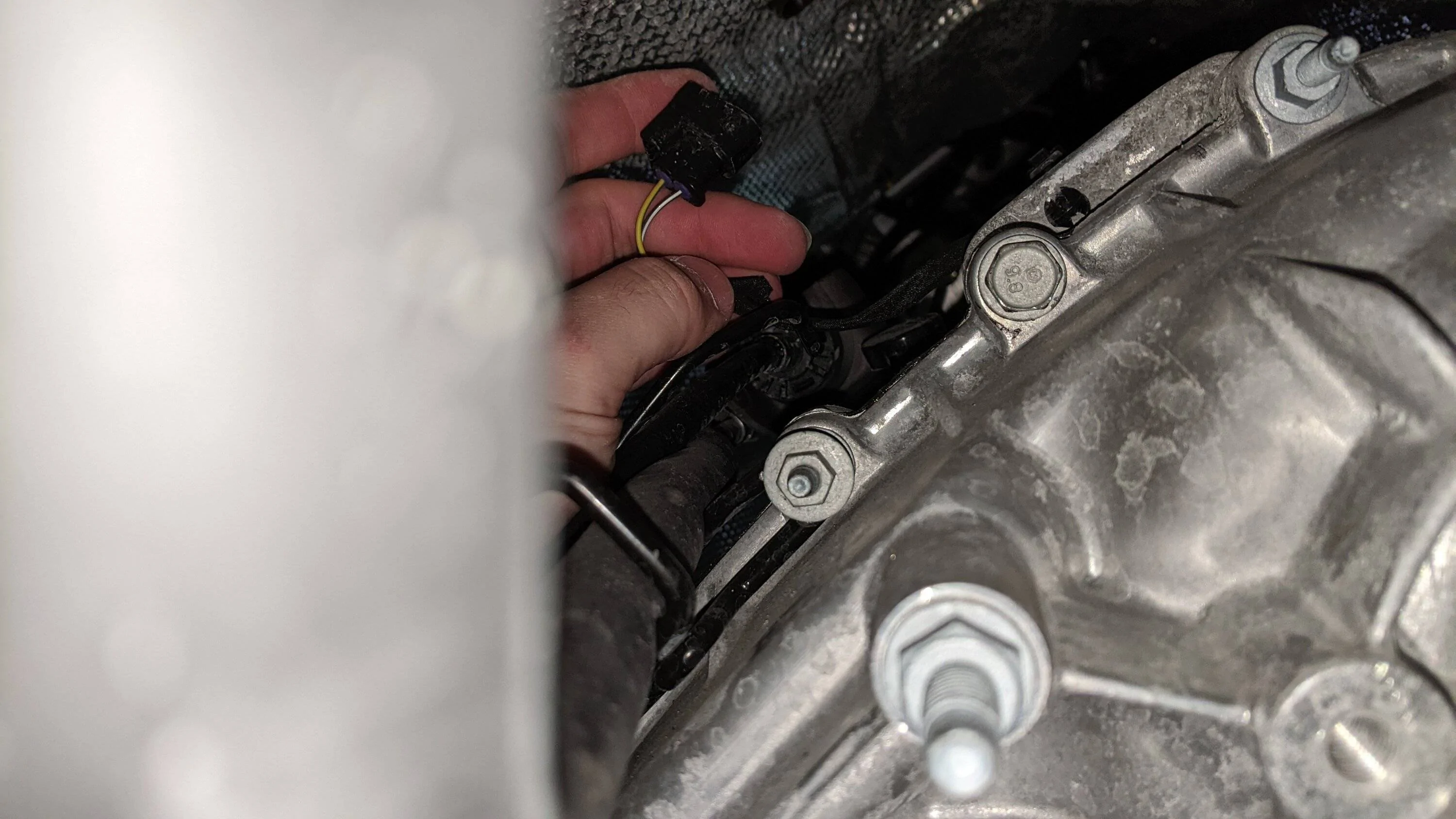

Disconnect top transfer case sensor connector, top transmission sensor connector, and wiring Christmas Trees (trees will probably break):

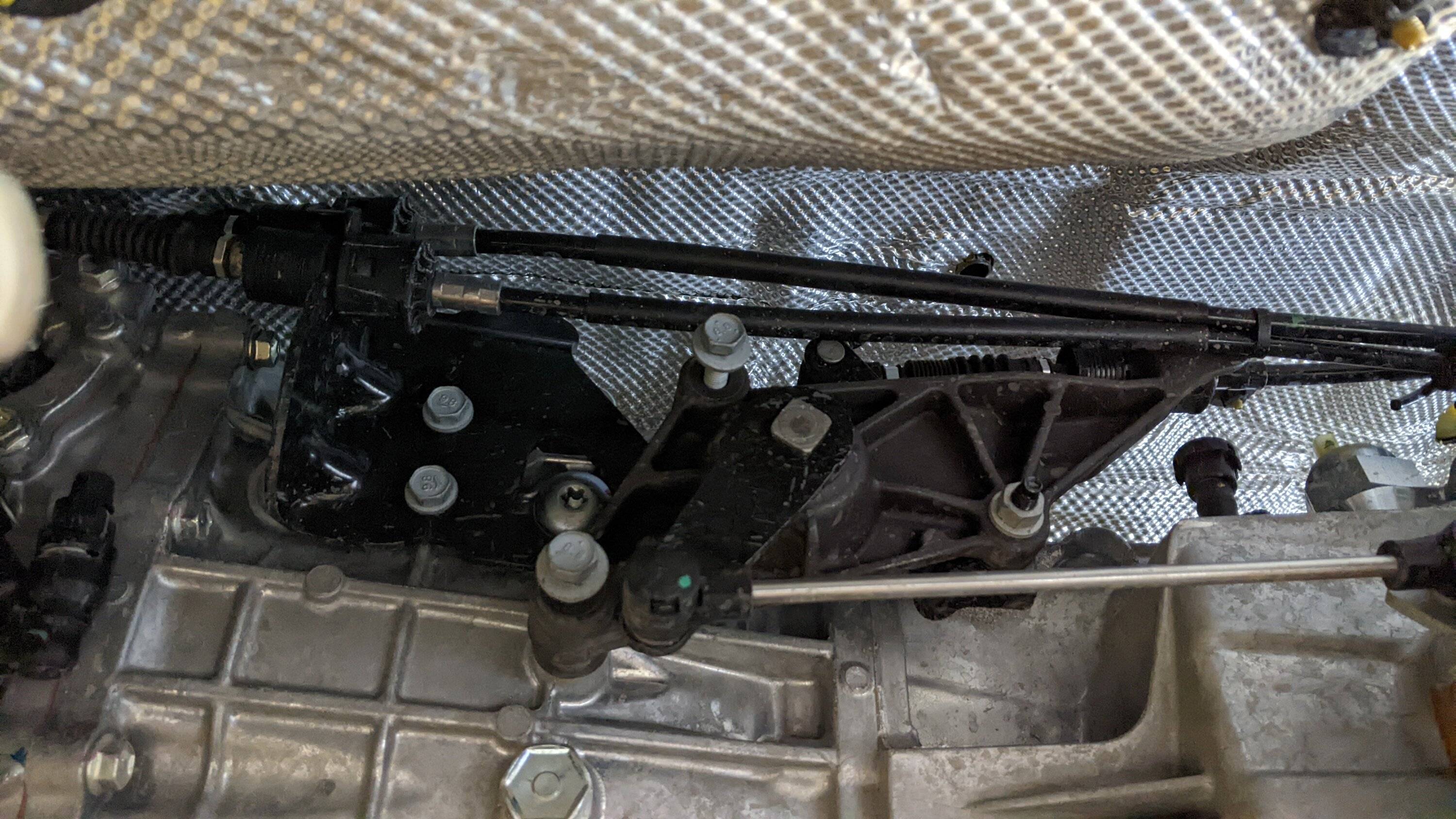

Remove right side fuel line bracket with 13mm wrench/socket and top transfer case shift cable bracket with 10mm wrench/socket:

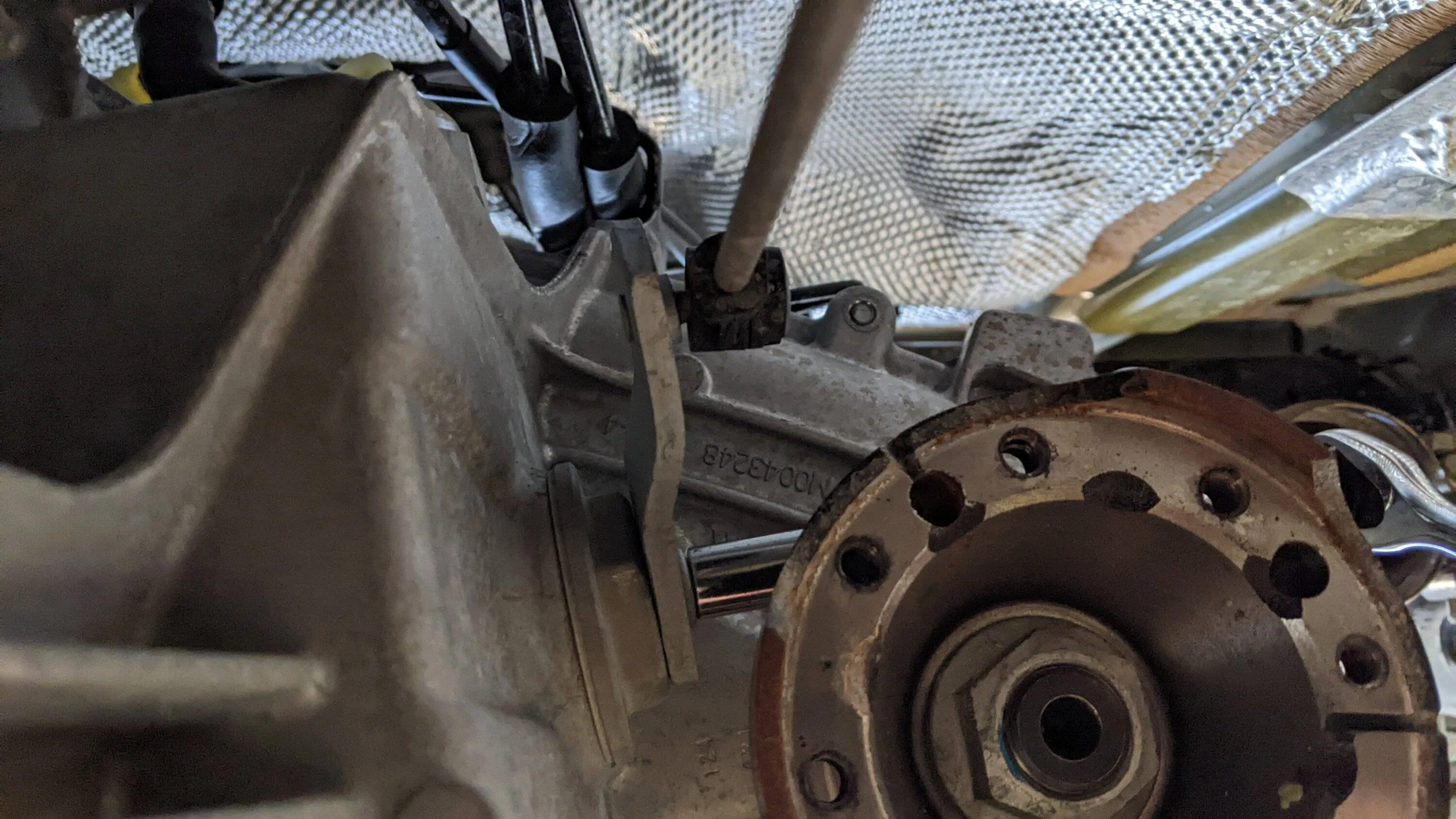

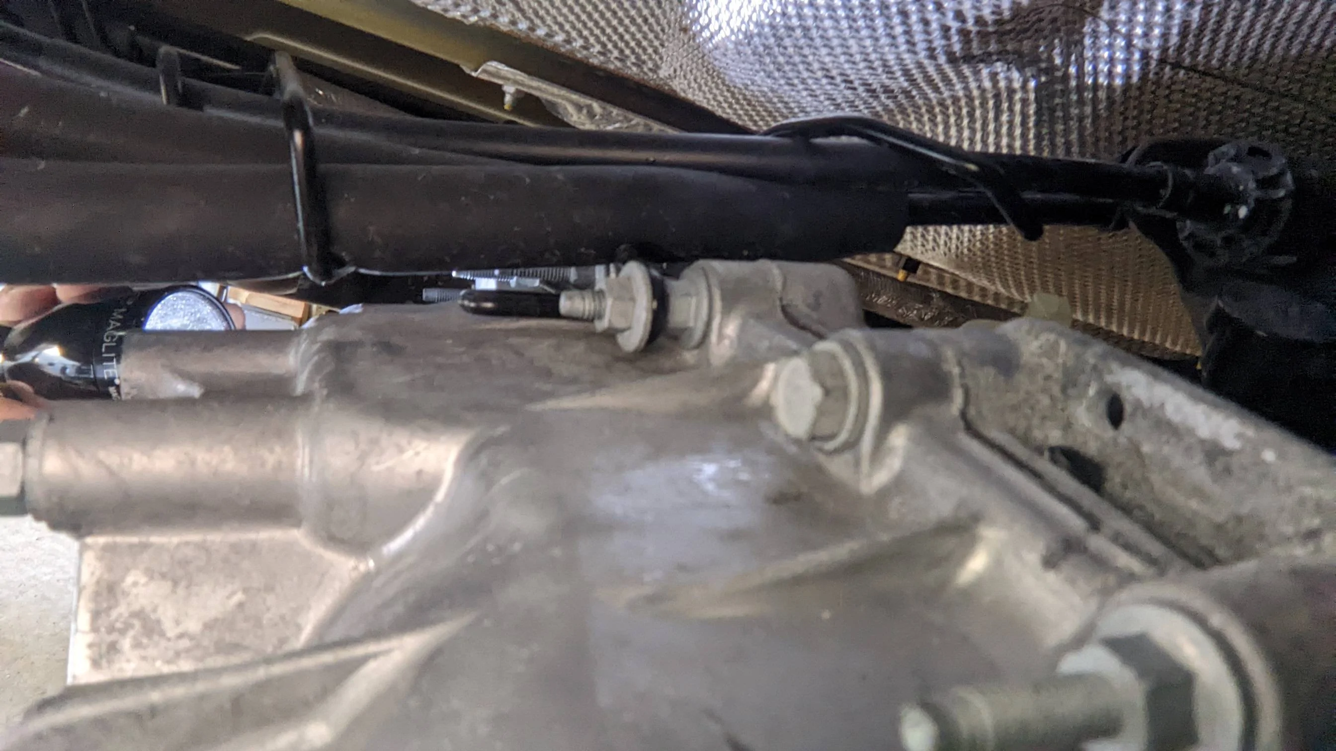

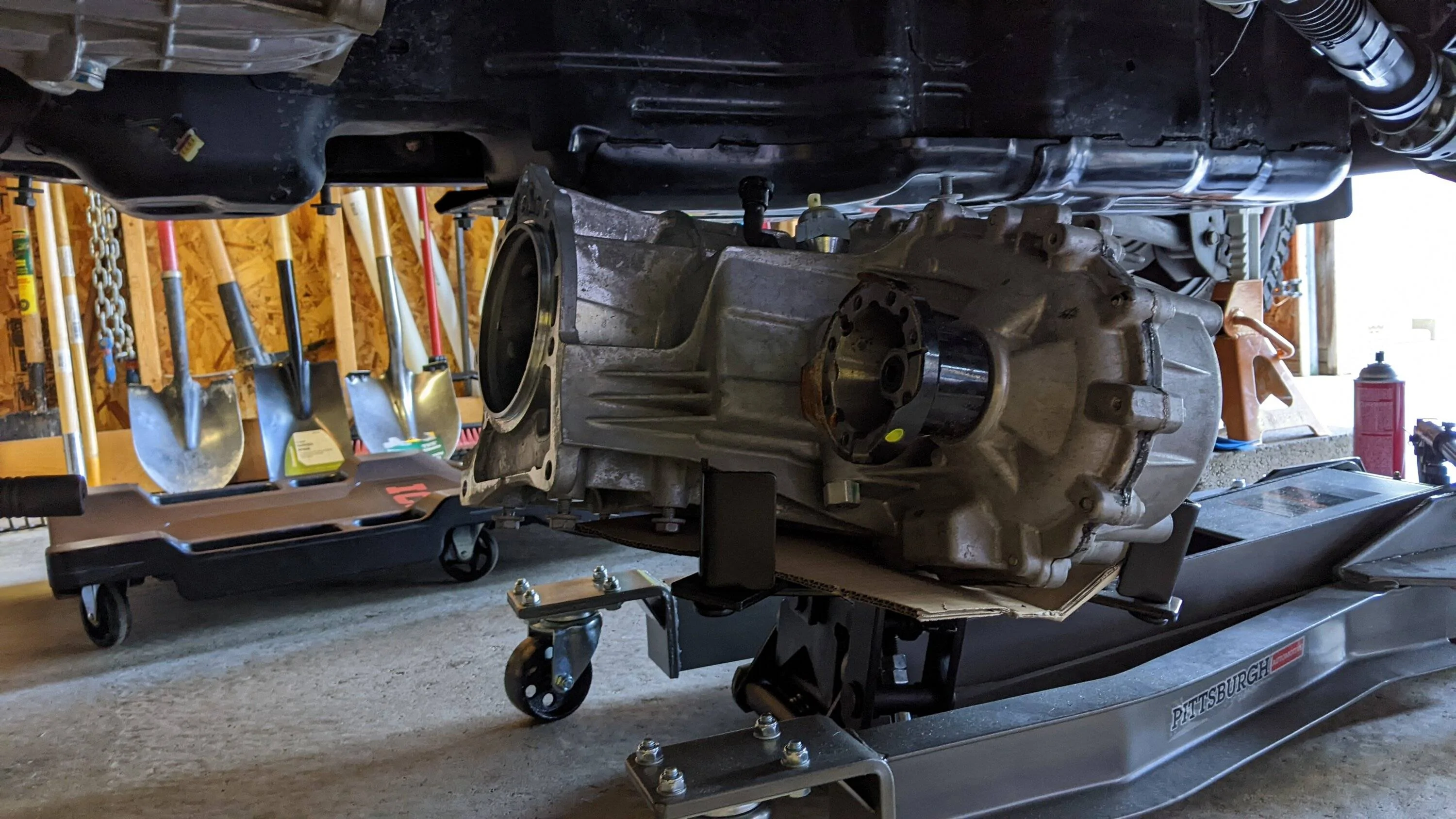

Disconnect transfer case linkage from transfer case with 10mm wrench/socket and remove transfer case shifter linkage bracket with 10mm and 13mm wrench/socket:

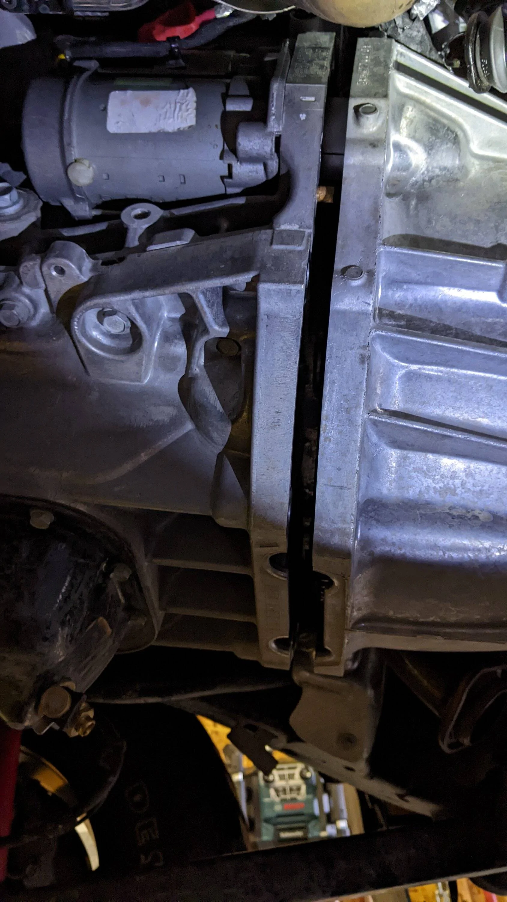

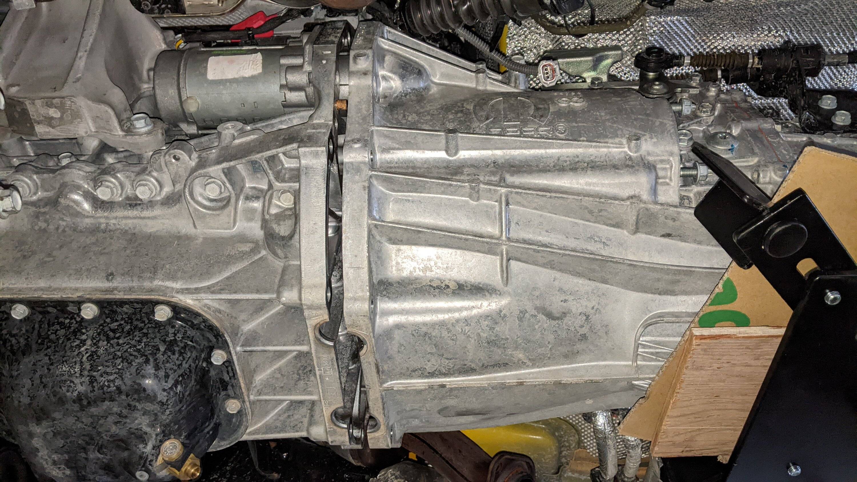

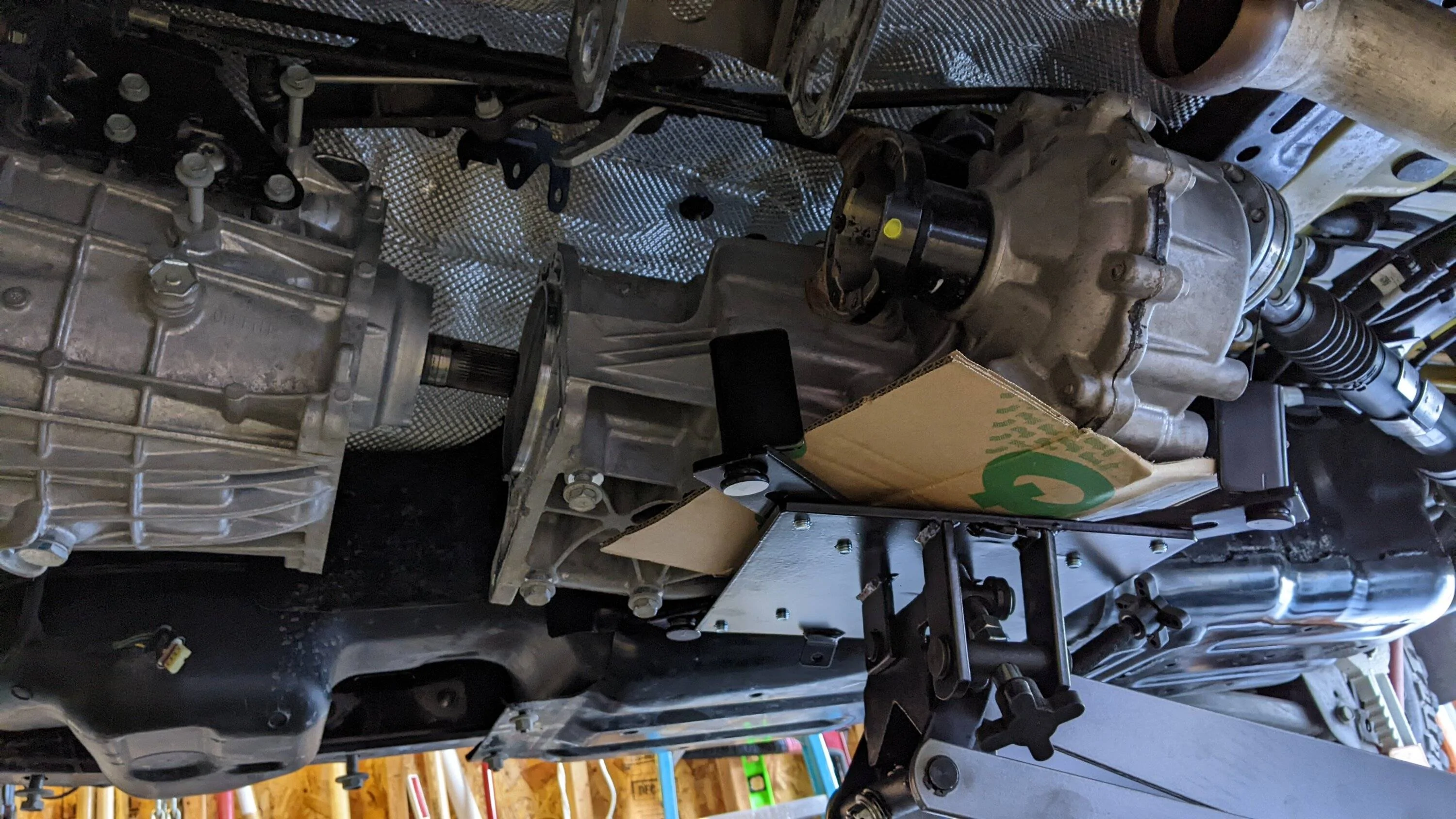

Unbolt the transfer case from the transmission with 13mm wrench/socket and divorce both. The transmission and transfer case are individually sealed units so no worry about leaking fluids:

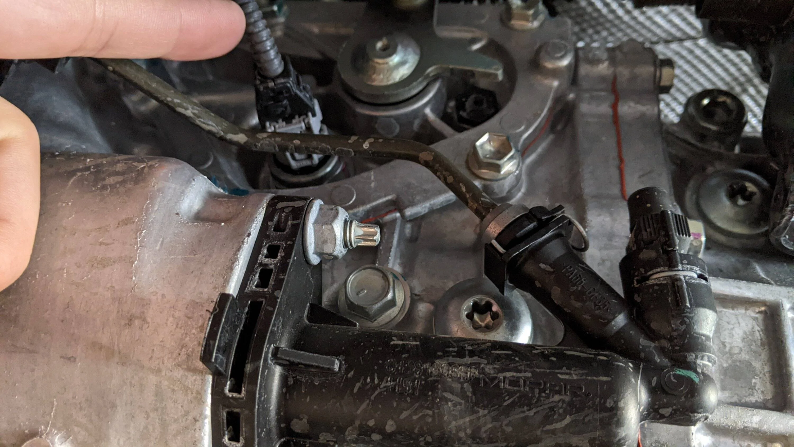

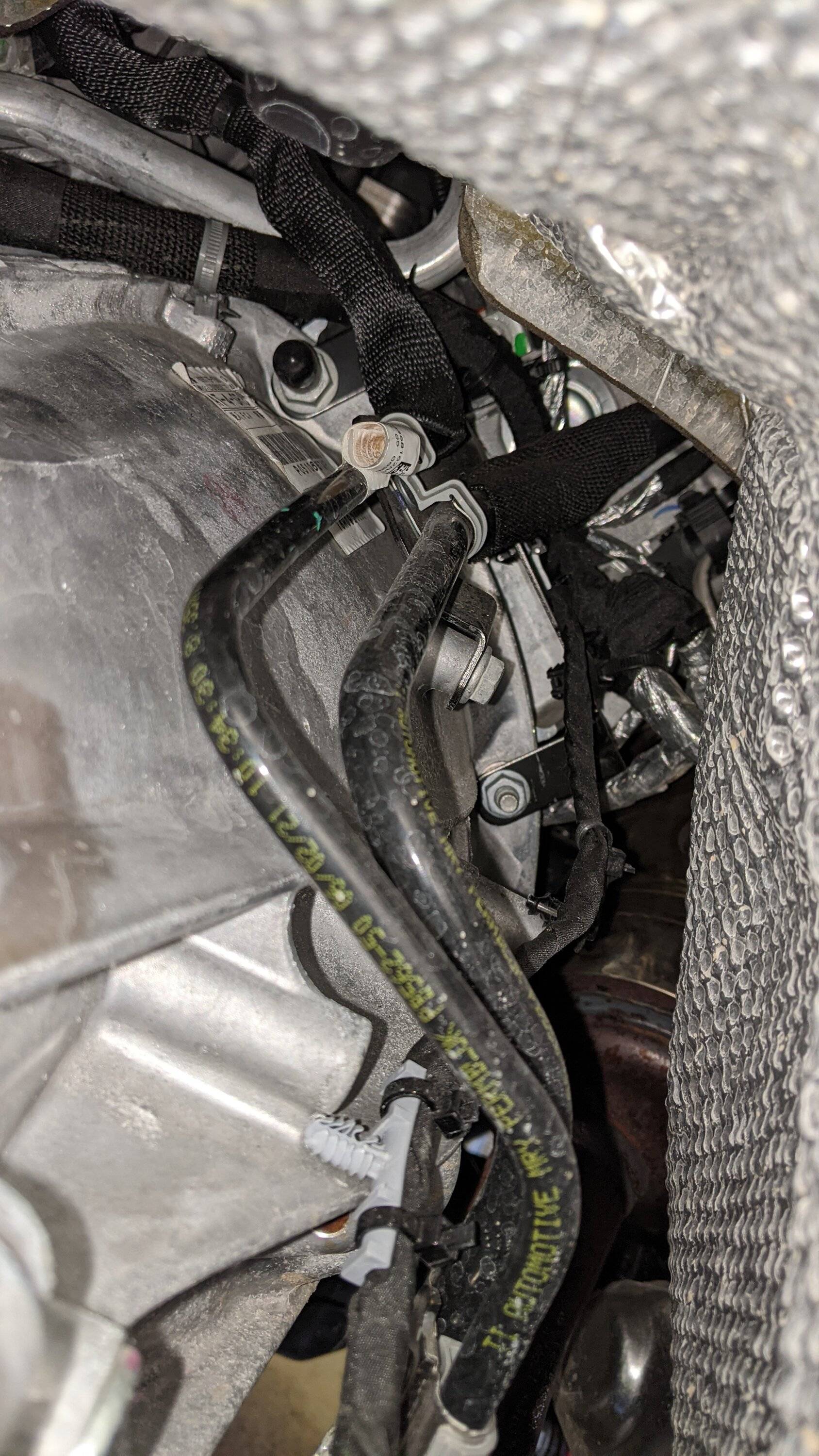

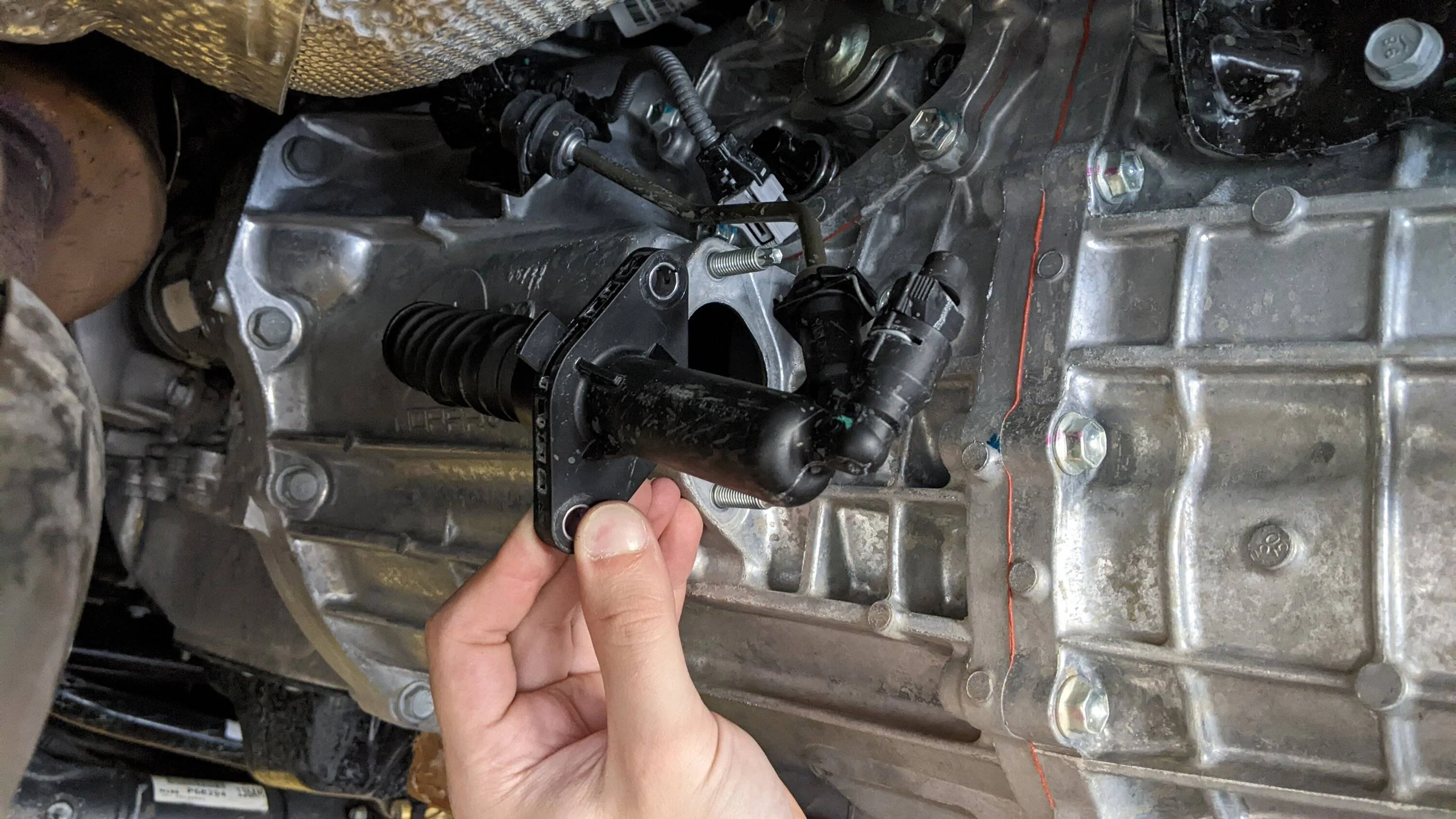

Remove slave cylinder bracket/position sensor with 13mm wrench/socket and slave cylinder nuts with 13mm nuts/5mm studs. Zip tie slave cylinder out of the way:
Remove the fuel hose clamp on top of the transmission with 13mm wrench/socket and push-on transmission vent hose:

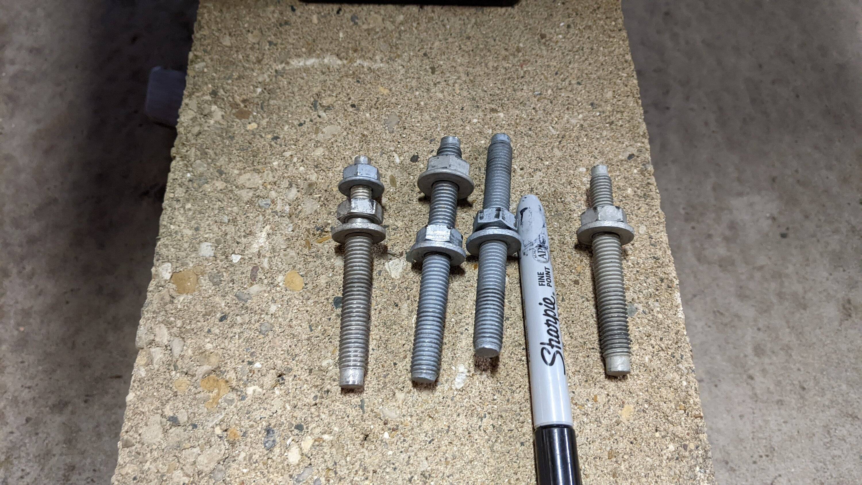

Remove top four bellhousing/ fuel hose bracket stud/bolt combos with 15mm socket, starter bolts with 15mm wrench/socket, remainder bellhousing bolts with 15mm wrench/socket and divorce the transmission from the engine:

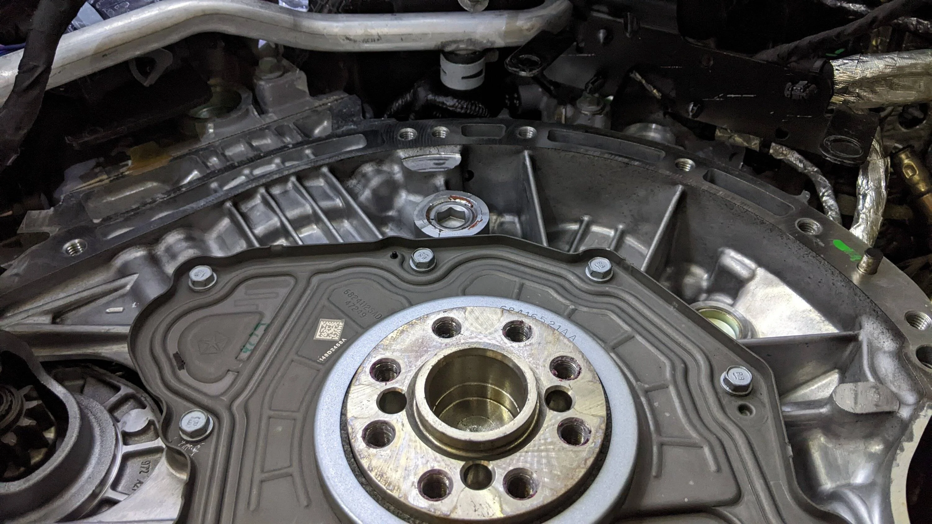

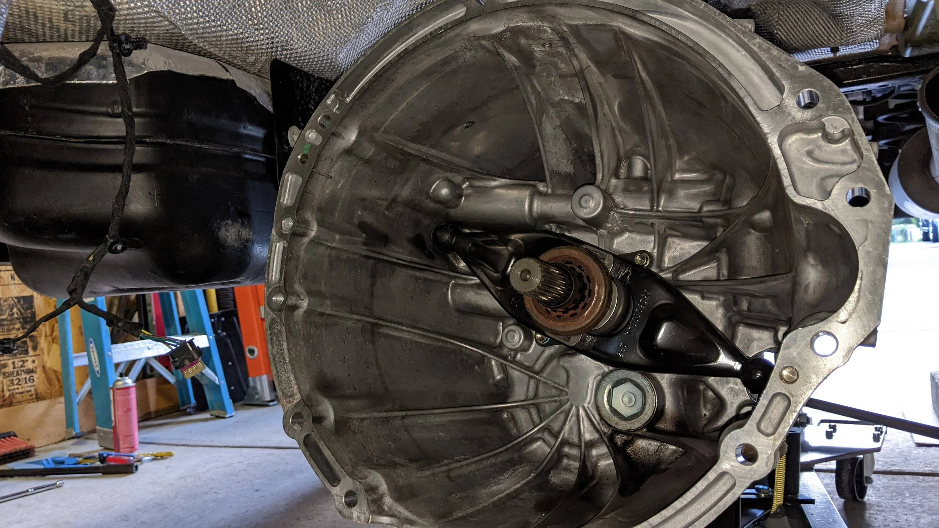

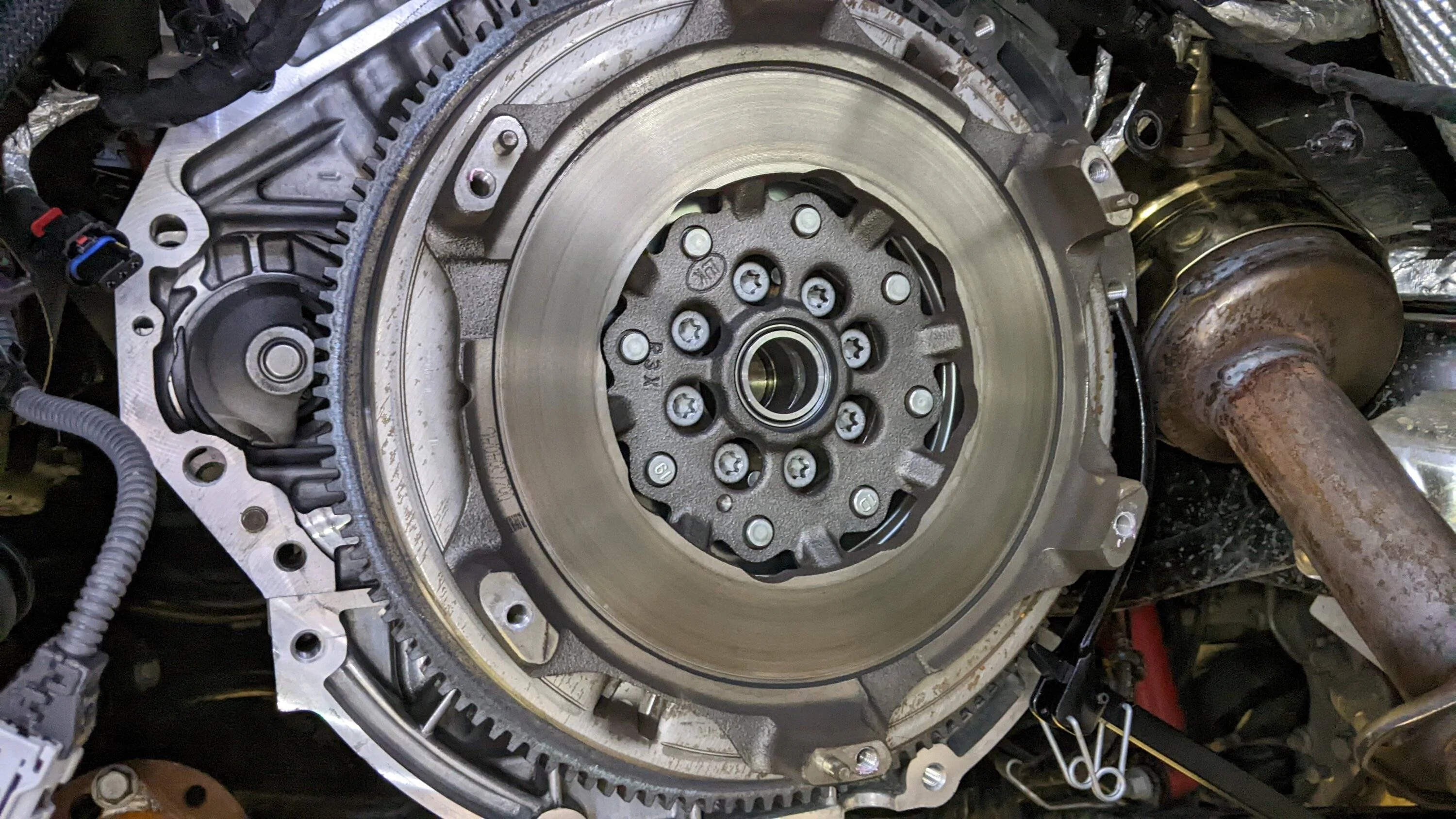

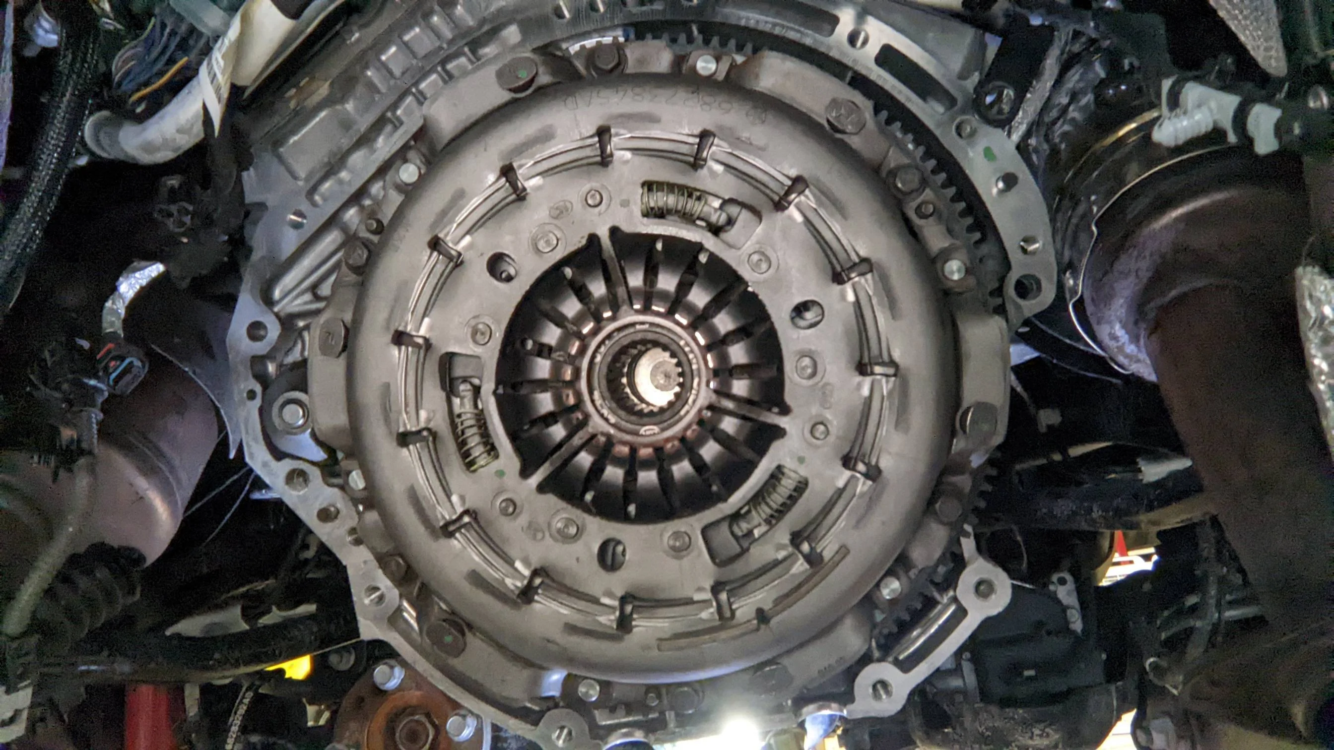

Remove the six pressure plate bolts from the stock clutch with 10mm wrench/socket and remove the eight flywheel bolts with a T50 bit:

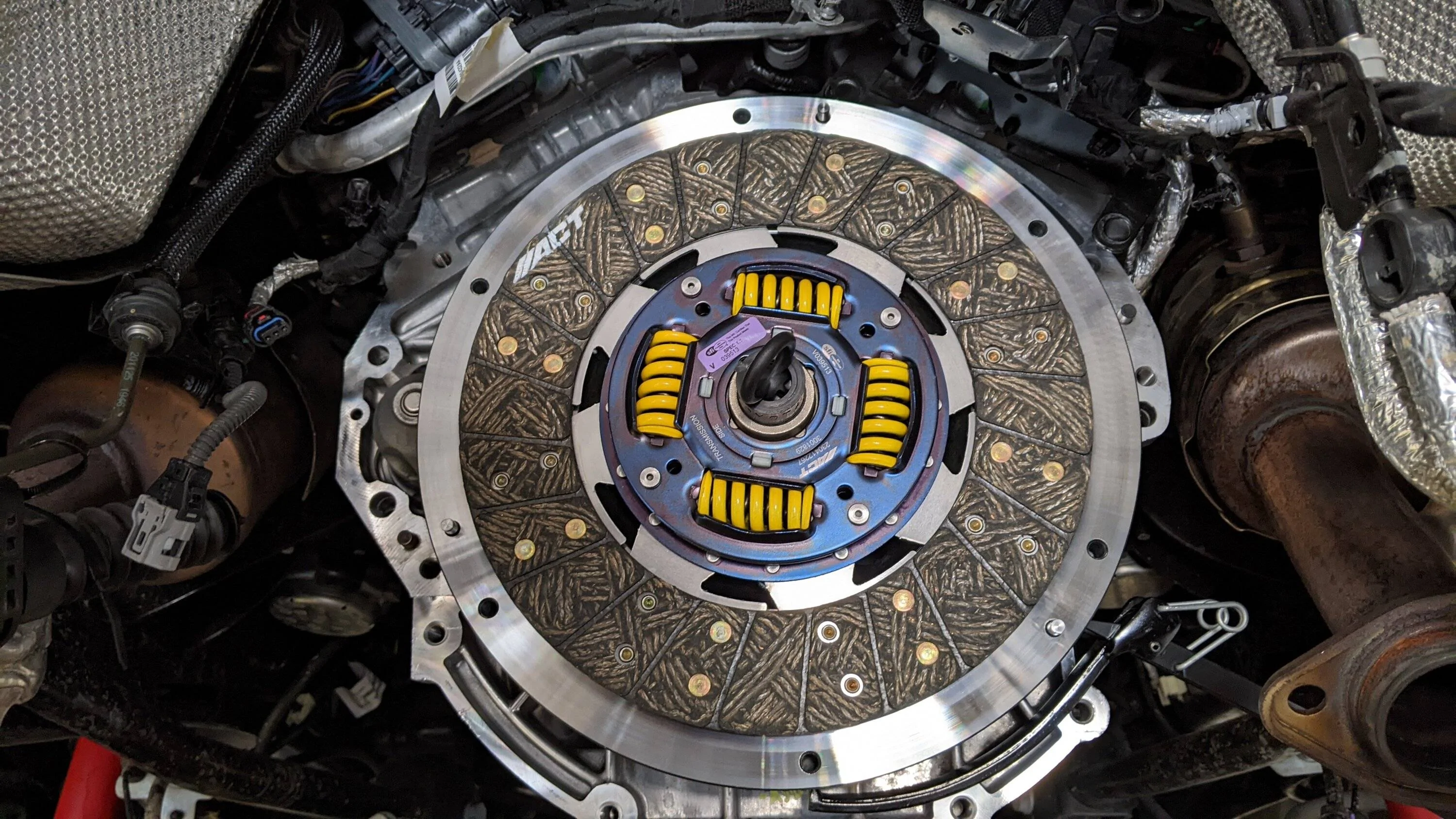

Remove the flywheel, prep the crank mating surface for the ACT flywheel, and install the ACT flywheel and clutch disk per ACT instruction:

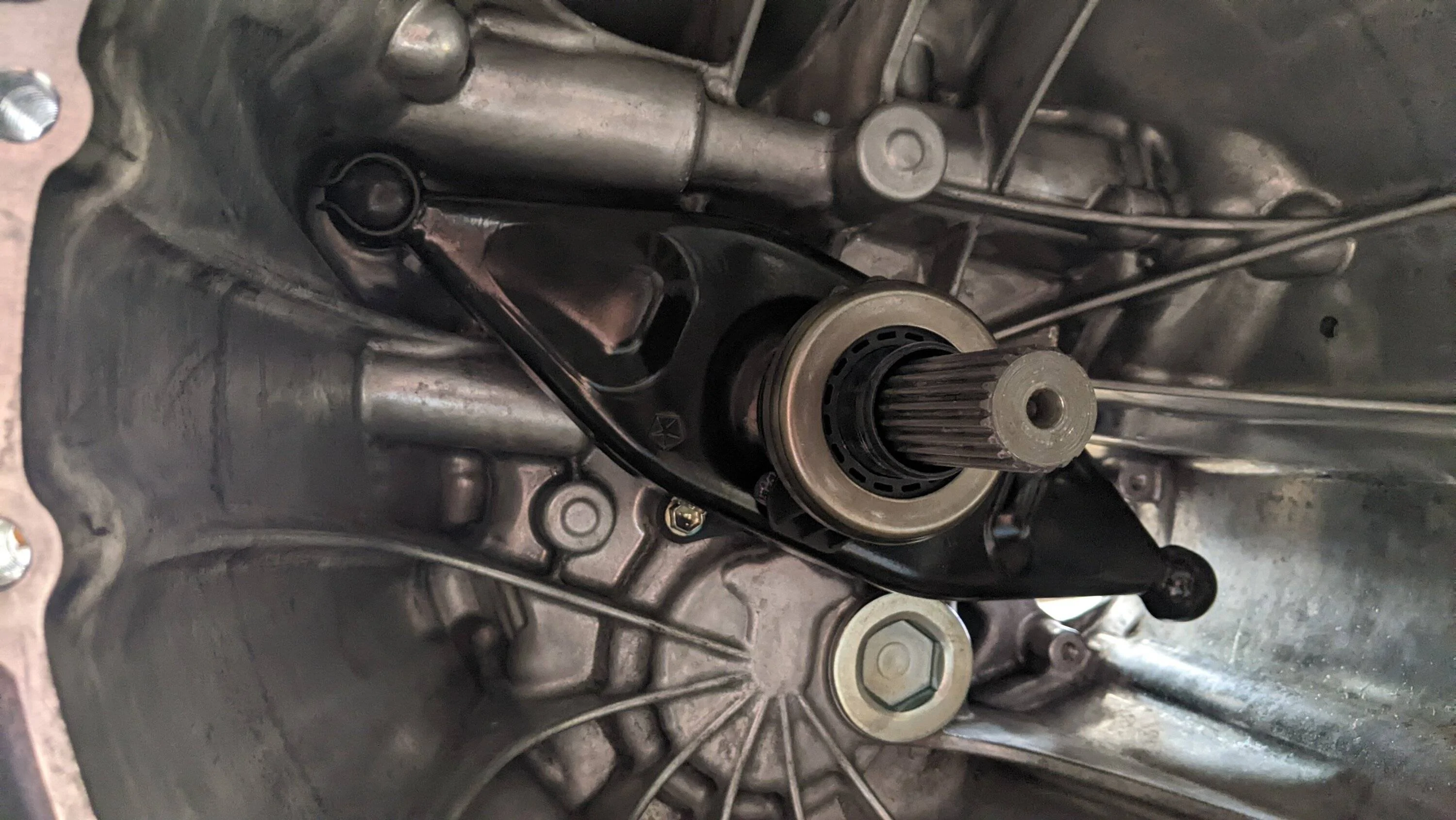

Install the ACT pressure plate and remove, clean, and re grease, the clutch fork pivot points and throw out bearing per ACT instruction:

1. If the driveshafts haven't been off before, the bolts can be a bear to get undone because of the thread locking compound. On our first install we broke off two trying to get them out. We now have a couple laying around as spares just in case. Now would also be a good time to consider changing the rear main seal if you have considerable mileage on the vehicle.
2. If you are able to support both the transmission and transfer case as a unit, it saves a lot of time and you don't have to mess with the shifter cables, just the wire bracket at the back of the transfer case to allow for cable movement.

4. There is a ridiculous bracket to hold the wiring to the top of the bellhousing that has a bolt and two nuts holding it down. Although the bellhousing bolts take a 15mm wrench, the very top nut holding the bracket is 16mm. The one below it is 13mm. We used about 3 ft of extension to reach the nuts from behind the tranfer case so we could turn it.
5. To make matters worse, the very top bolts have a long stud sticking out (one for the wiring bracket) making it difficult to get the bracket off the stud. We cut the stud shorter prior to re-install.
6. Since release travel is so critical on these vehicles, you want the diaphragms fingers as uniform as possible, so double check the uniformity of the diaphragm fingers after you tighten down the pressure plate by placing something flat against them as a reference. On a clutch this large, the cover stamping will flex a little when bolted down. If there are slightly lower fingers in one area, loosen the clutch bolts only in that area by a half turn and retighten. If there are high fingers, loosen all bolts by a half turn and tighten the area with the high fingers first.
7. Make sure to use our torque specifications for the flywheel and pressure plate, not the factory Jeep specs.

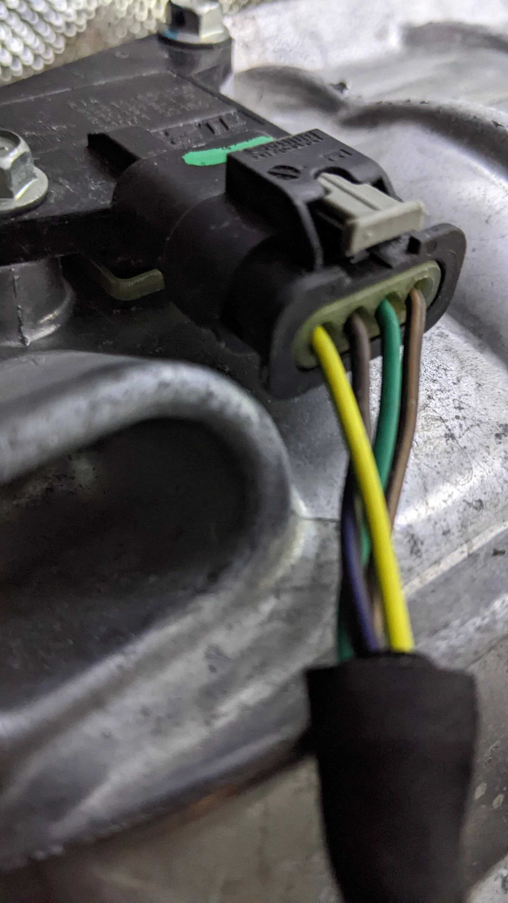

So here's an update on my Jeep.
@roaniecowpony stopped by the dealer and picked up the part I had on hold and brought it up to my house. We swapped out the master cylinder and re-bled the system. On our test drive we both agree it's driving normal. I'll drive it around tomorrow to see if things stay the same or get worse. If it gets worse again then there is either:
A. air still getting into the system somehow from somewhere else
B. something wrong with the ACT clutch (whether it be a bad install or other)
I'll report back after a day or two with how it's doing.
hope this fixes your issues
If it does I might have to look into my clutch hydraulics. Was there any hydraulic fluid leaking from your master cylinder that led them to determine that was the issue?
The shop thought so. Chuck and I are not as sure. There was some fluid around the connection to the line that leads down to the slave. But also that could be from all this work that's been done with this system in the past 2 weeks with brake fluid getting poured in and bled out, etc.
I figured worse case I spend money on the part and then learn a thing or two about how hydraulics work. Best case the part fixes all my troubles.
