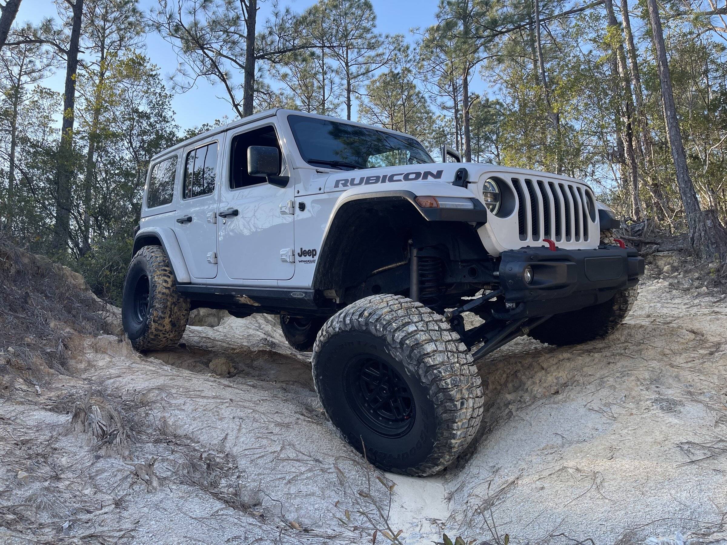

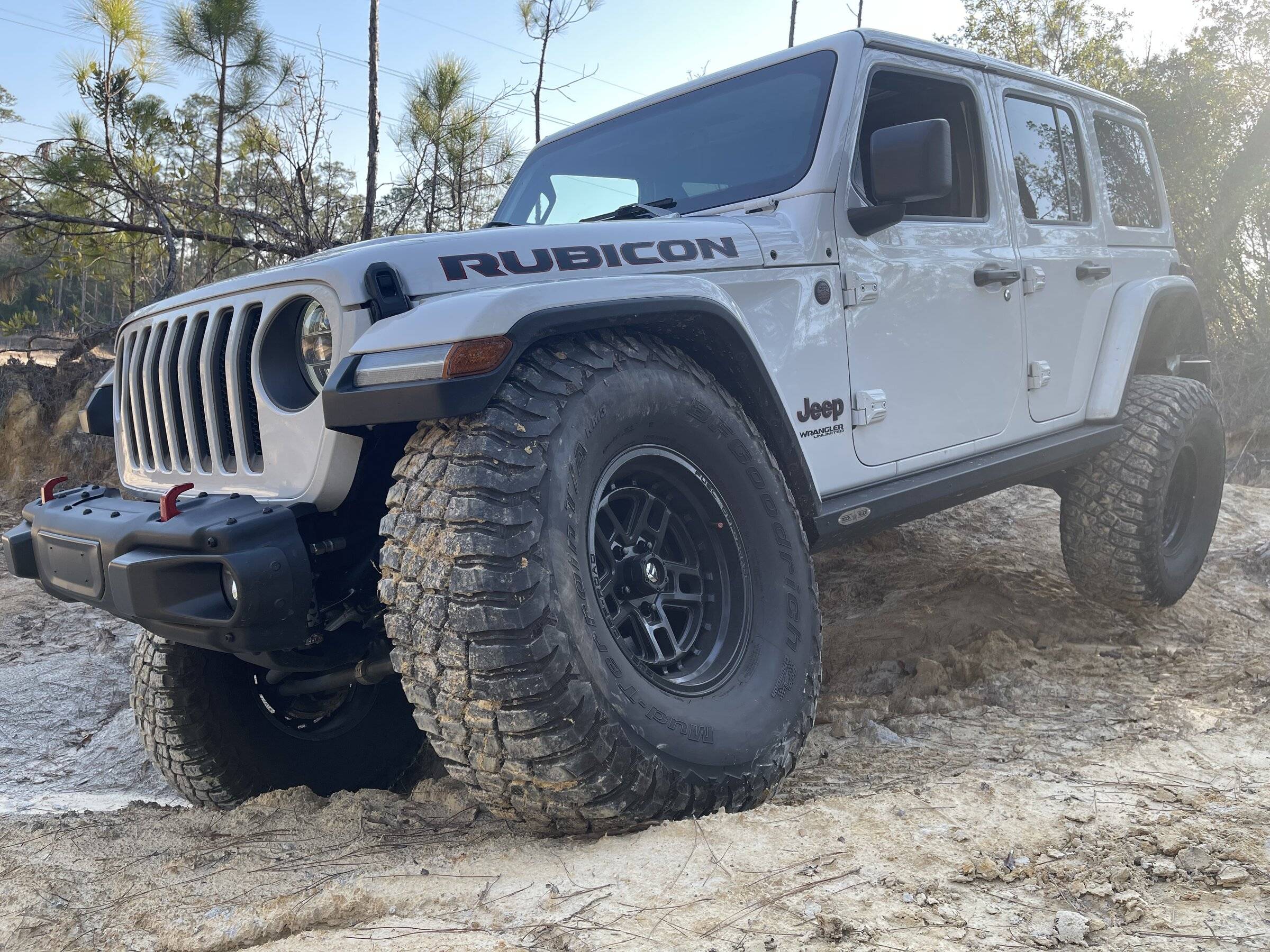

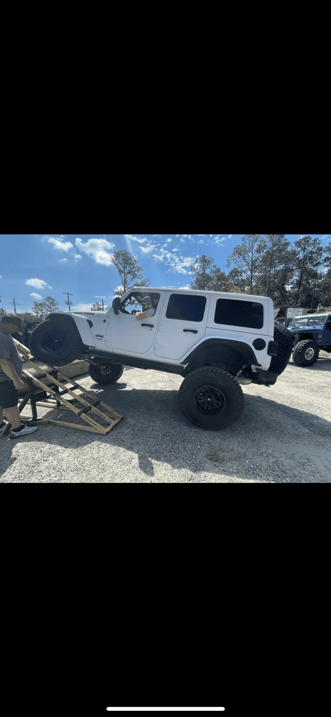

I'll start off by saying i knew it would reduce flex. On the road it's the best upgrade i think I've done. Especially for the money. If you do heavy on road, it's the ticket. If you do a lot of off road, it's just not worth the money.
I went to a local place to see what, if any, change. I was blown away by how much it wouldn't flex ?. The passenger side should have been into the fender well until it barely rubs the inner fender. The driver's side should have at least been touching the ground.

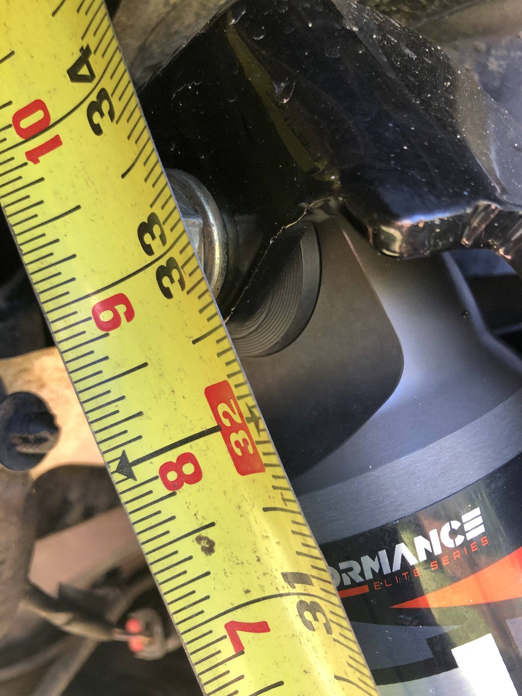

I have changed my shocks since then and then the sway bar but that's all that's changed. New shocks have basically identical collapsed and extended lengths. Here are the pics vs an older pic. You decide how much it hinders flex.
I just undo one of the rear swaybar links at the axle and tie wrap it to the bar when we go off-road on big obstacles or tough trails.

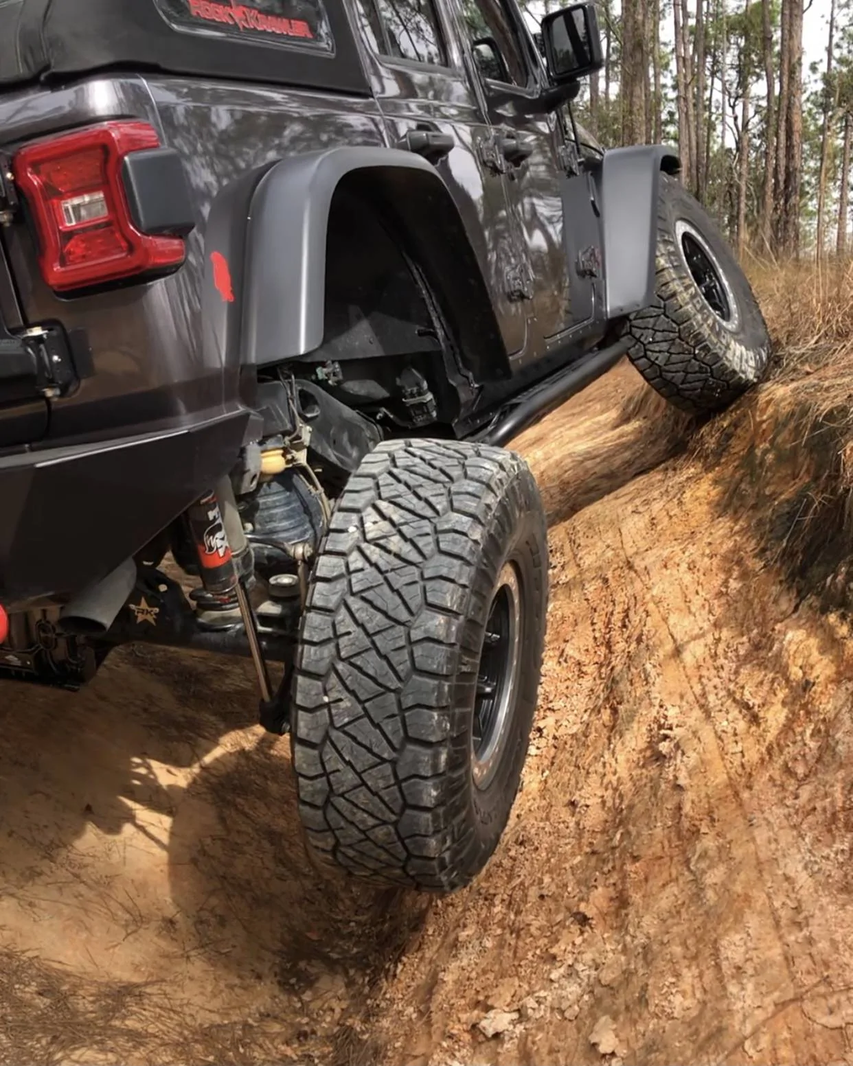

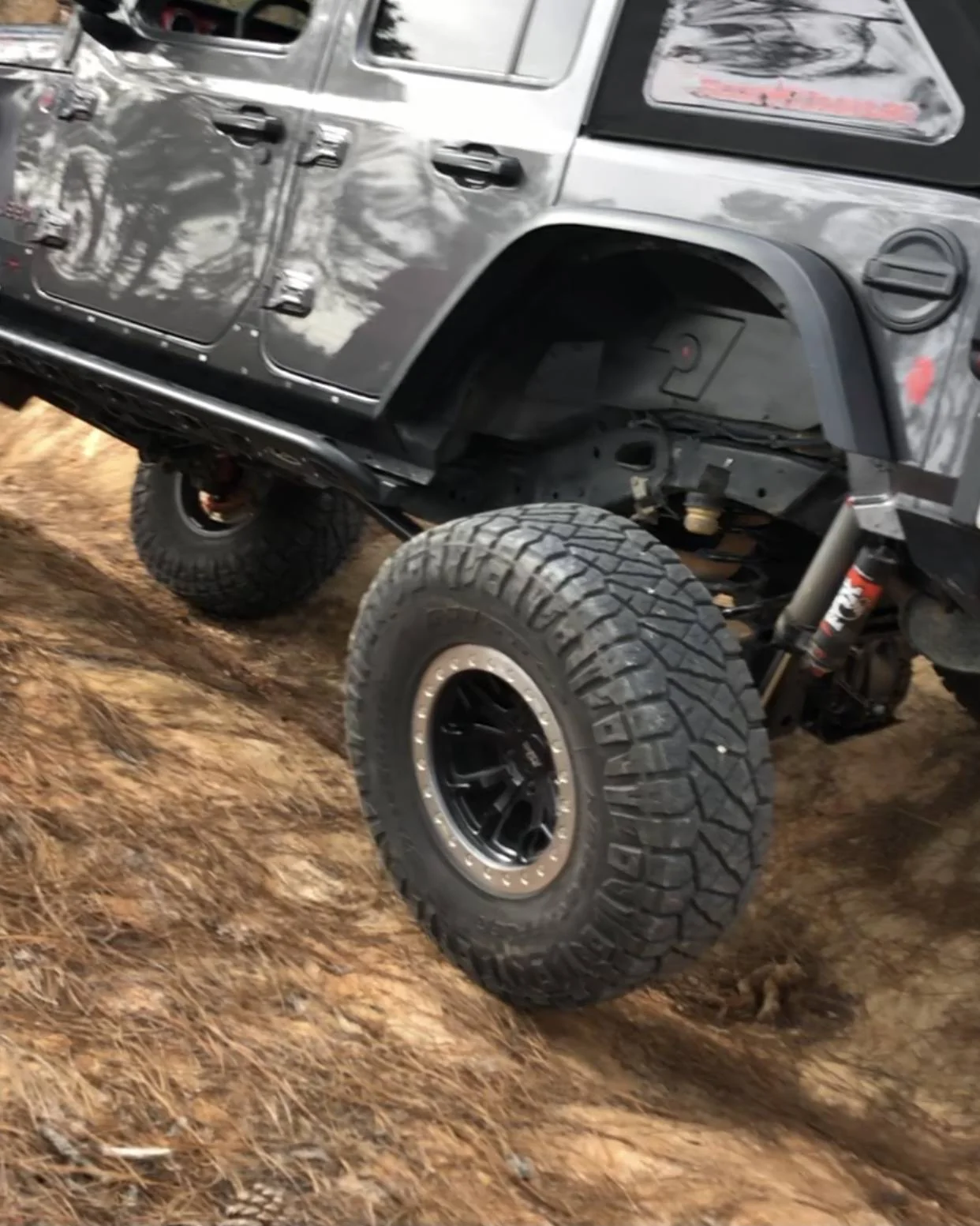

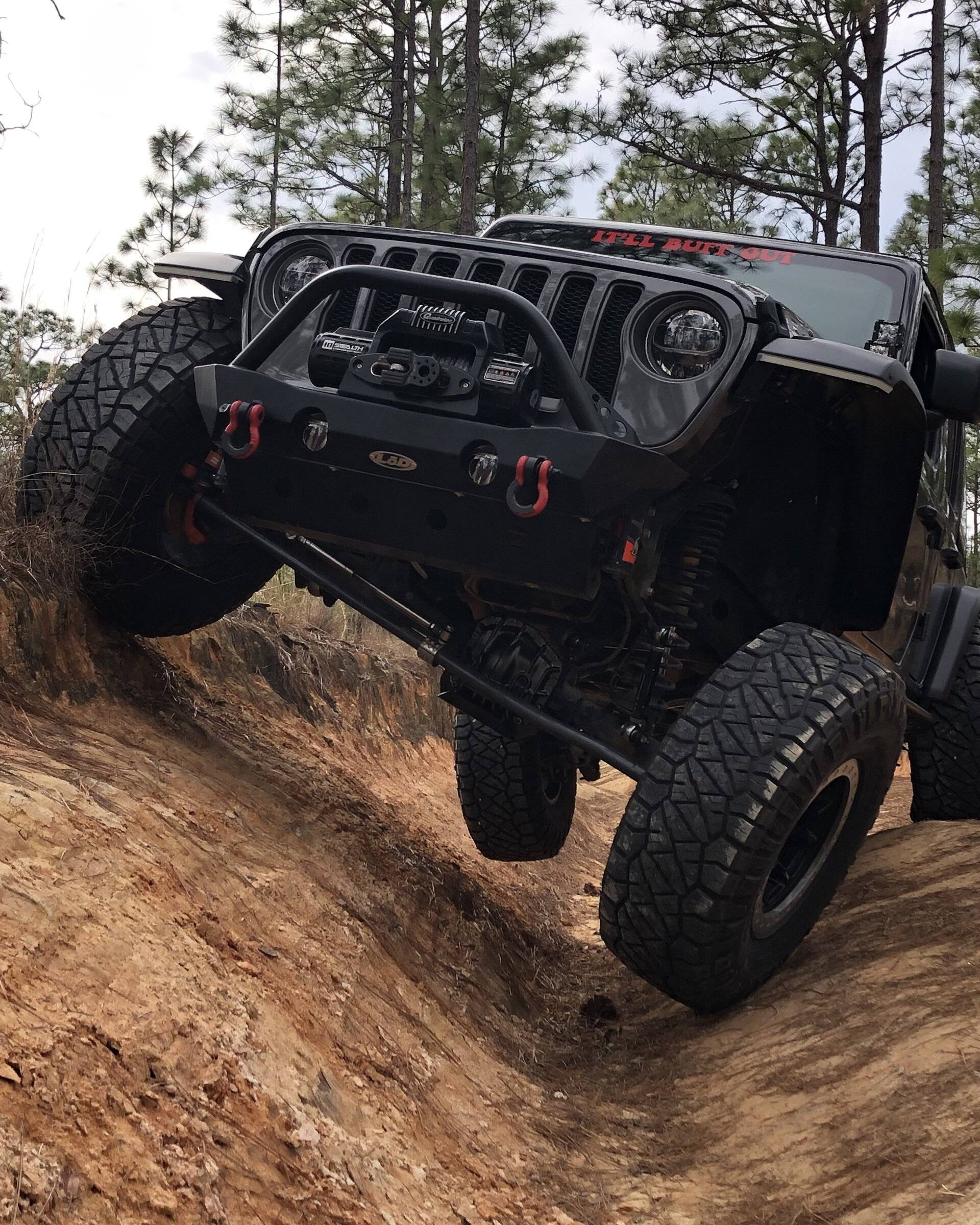

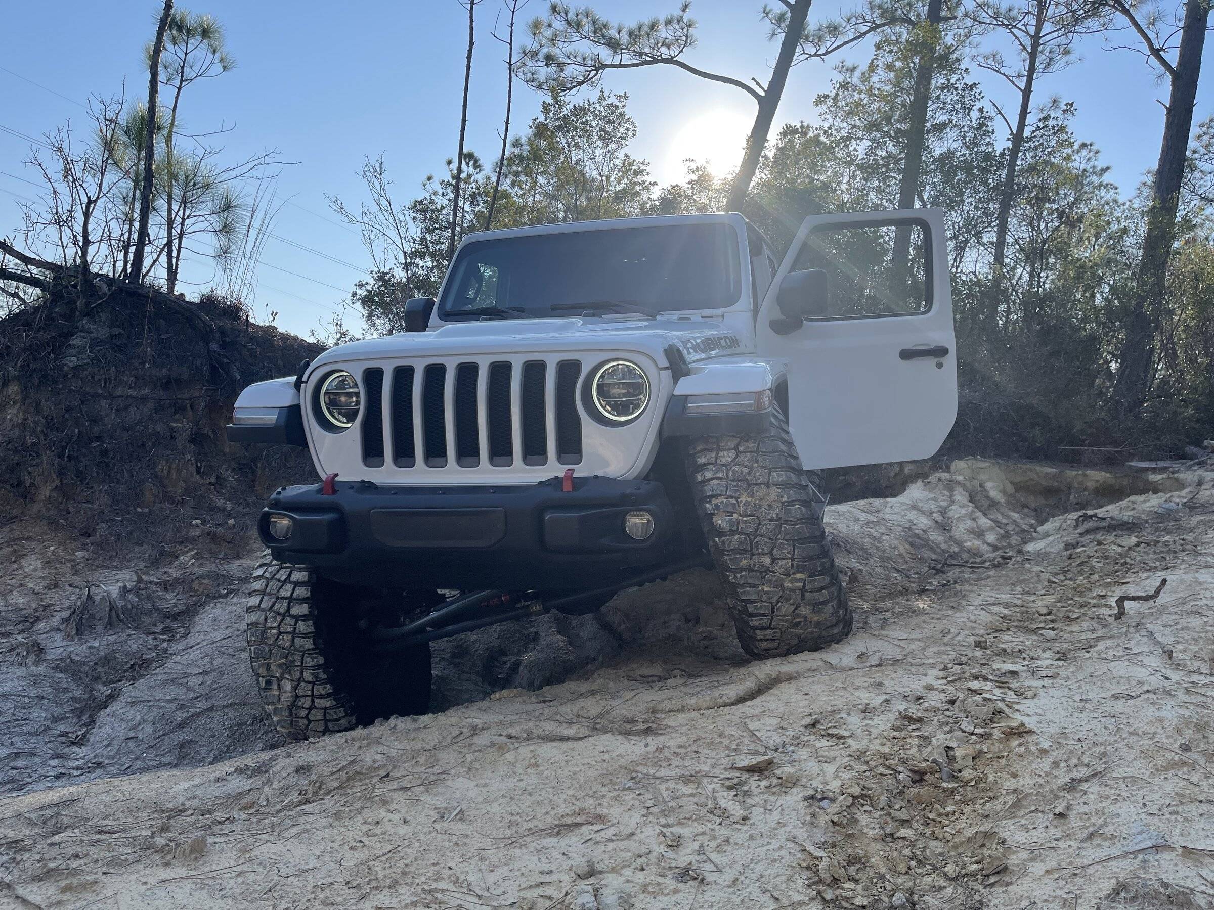

I want to share what I know about the oem rear sway bar……it does not reduce or stop flex in any way. On mine it hits the track bar frame brace and makes a hell of clunk when passenger stuffs, on driver stuff it hits the frame. Here I’m twisted up and I’m doing my best Bronco impression, hanging a wheel, to show my point. The shock is the limiting factor here. The factory sway bar will hit the frame and stop, but it will continue to twist, not limiting anything……….this is what I know for a fact on my rig, OMMV…….
Of course I’m always looking for a better mouse trap, but so far this is it for me. I finally rode in a Jeep with a rear anti rock but didn’t like it in curvy highways we have here. So the search continues………..

We're going to have to get you one to test for us ;)
As I can definitely feel it, and see it, limiting the rear when on stuff 2/3 as wild as you are on in the photos above. It just wants to tuck the butt down and stops the rear axle from articulating.

Are you talking about oem or helwig, I’ve unhooked my rear sway bar , there’s absolutely no difference in my rig, none, just more loosy goosy on the trail.

The factory rear bar is so light and pencil thin that it does allow for full flex on most rigs. Of course because it is so flexible one could argue you aren't gaining much antisway from the thing either, thus the dramatic difference both on and off road running the hellwig. Have you driven on road with the factory swaybar disconnected? I'm guessing you'll see just as little difference there as you do off road.
