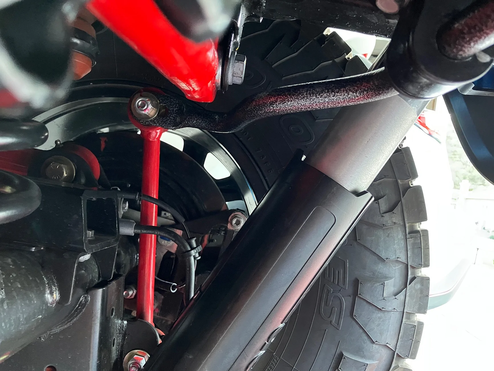

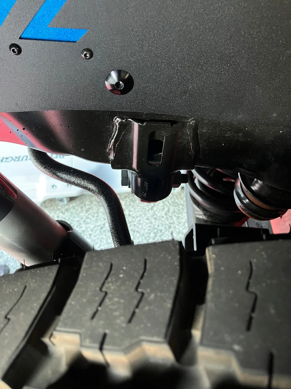

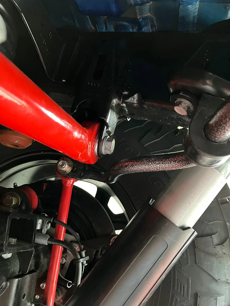

Does this clearance look right for the Hellwig rear sway bar? I’ve got a steersmart track bar, and I don’t remember if the stock sway bar was that close to it
